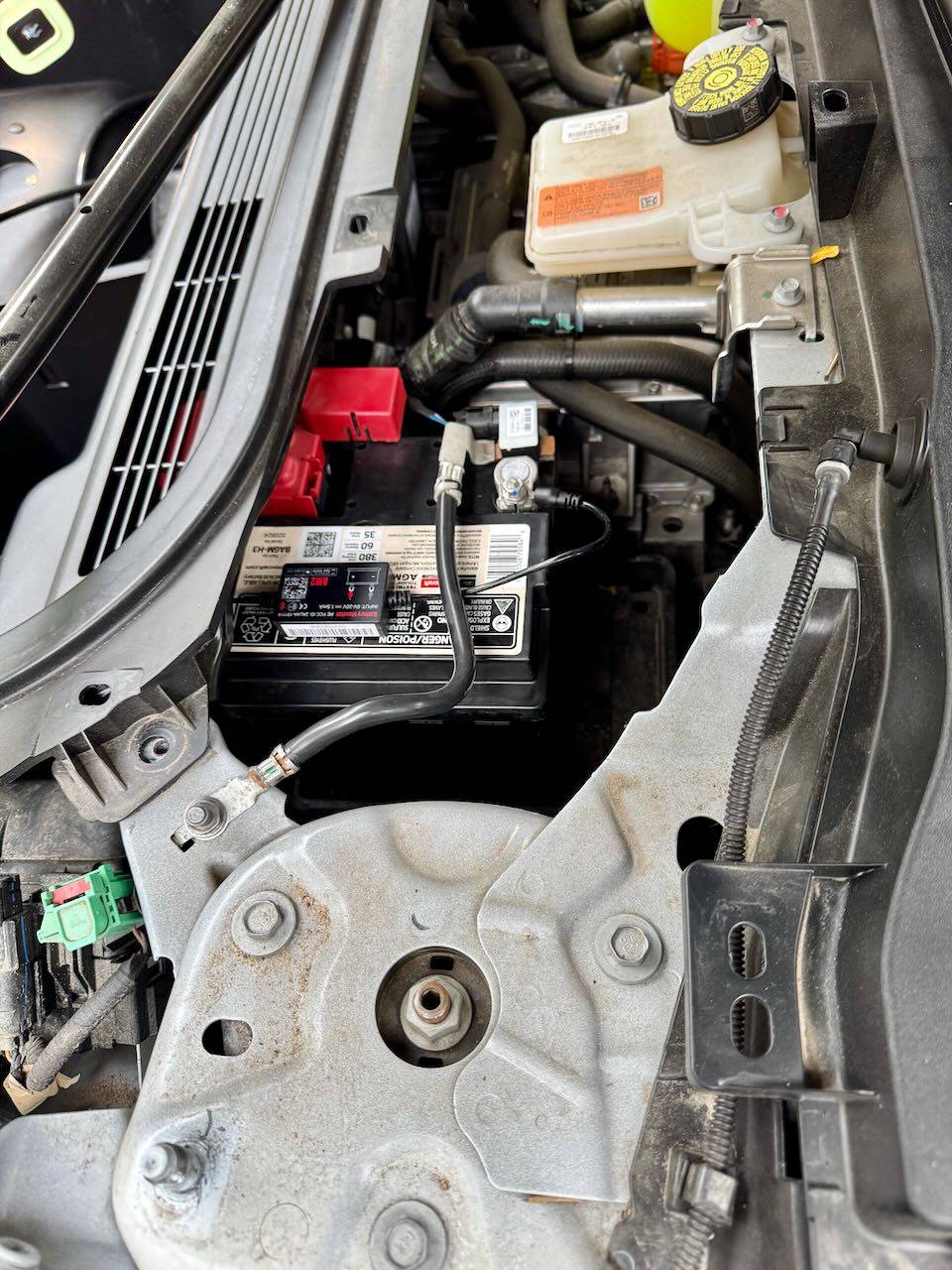

I just swapped my 12V battery at 40ish months (May 2021). Went smoothly!
I can recommend the minimal method of just removing the upper cover, drivers side cover, and driver side of the strut brace, but NOT removing the frunk tub. The order of operations matters, but the battery slides out very easily - no shimmying or shoving.
Here is a photo of the battery in its tray, slid all the way to the right. You can see it lifts straight out without interference. Whole thing took about 45 minutes, including digging around to find my 10mm and 8mm nut drivers, which are very helpful for the task. A long thin extension for your 8mm socket would also work.

A few tips to make this go smoothly:
  1. Remove the upper plastic cover
  2. Remove the driver's side plastic cover
  3. Remove the driver's side strut brace nut (18mm), and gently slide the strut brace out of the way
  4. Disconnect the negative battery cable from the frame (13mm)
  5. Disconnect the negative battery cable from the battery (10mm) and flip it up and behind so it is out of the way
  6. Disconnect the metal bracket holding the battery down in the tray (rear side of the battery) (8mm)
  7. Slide the battery to the right (toward back of car), open the positive battery terminal, and remove the positive terminal from the battery (10mm)
  8. The battery is now clear to lift straight up and out.
  9. Drop the new battery in place, and reverse these steps. The most helpful thing is doing what you can while the battery is still in the right-most position.
New battery back in place with bluetooth battery monitor installed as well. Strut brace not yet bolted down.

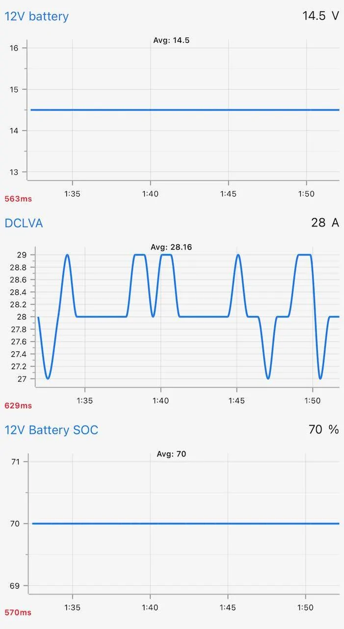

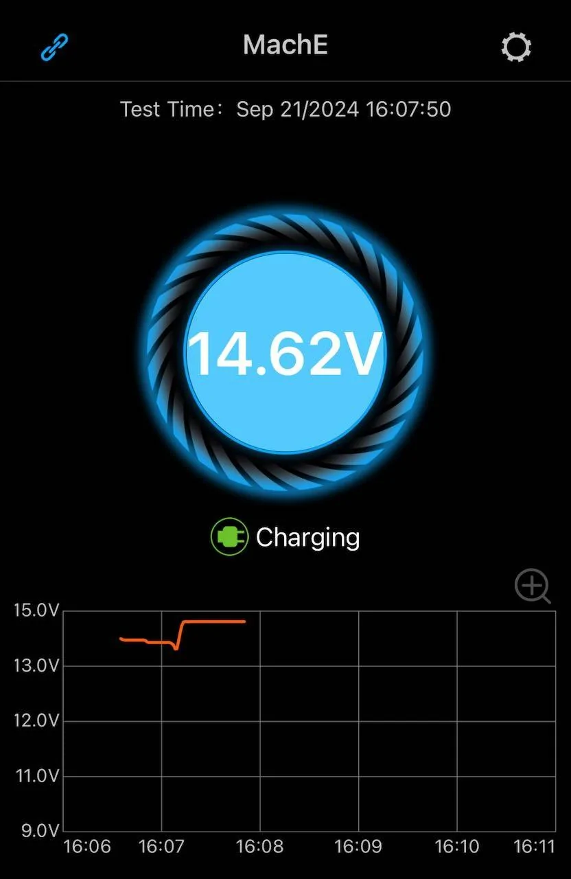

Battery is charging now (car on and plugged in, lights and HVAC off), here is what the battery monitor and CarScanner say:

At this rate should be about an hour or less to get to full float voltage and 100% SOC. I'll manually reset the BMS after that.
