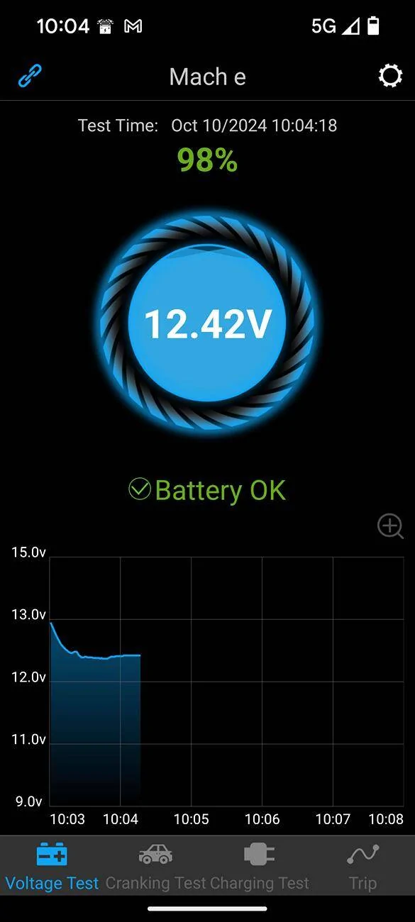

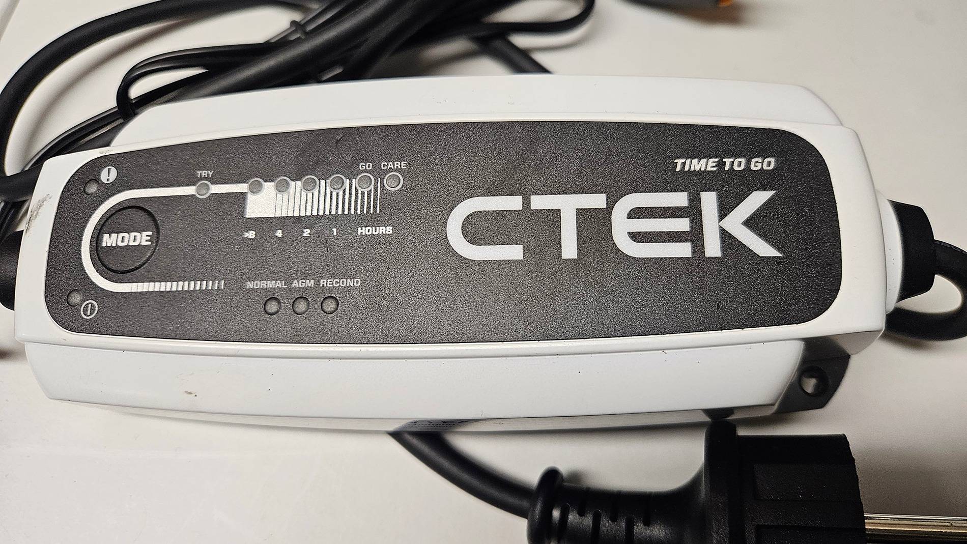

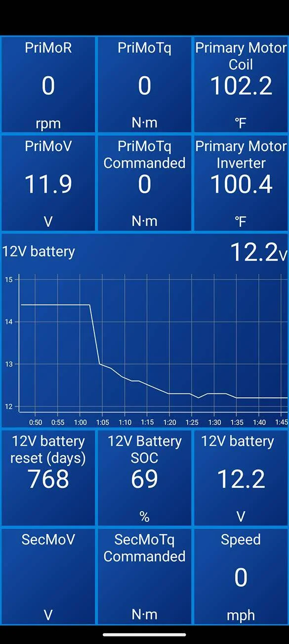

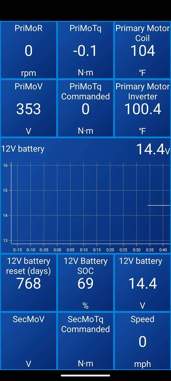

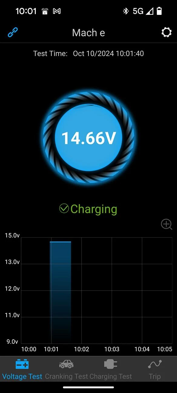

Hi I followed all the steps like you said and my new battery is stuck at 69% SOC for past 30 hours with car ON and blower 7. How long did your take to get 100%. Thanks for your help.
Hmm, that is a long time, overnight was plenty for me. It looks like the value is just stuck, what does the 12V voltage settle at if you turn it all off and let the car rest for an hour or so? It might be close to 100% and just not registering that.
After 2-3 hours voltage 12.5v (obd)-12.7v (monitor) and 58%(obd)- 89%(monitor). My hvb is down to 40% I'm going to charge to 80% tomorrow and see if that will help. If nothing works I have to go to dealer. As I don't want to reset at low %.
11,345
24,967
The battery is discharging in this snapshot because the car is not ON. Do not leave Car Scanner running if the vehicle is not ON because it will drain the battery. Car must be fully ON (press brake pedal + start button) and not in accessory mode, and data collection must be ended when you are finished.
Please follow the "Blower Charge" method steps (through #8) carefully here, followed by a BMS reset:
https://www.macheforum.com/site/threads/how-to-get-failed-otas-to-install.29749/
The battery does not need to be at 100% to reset the BMS.

After 4-5 I going in car and connect obd to check SOC that's when I took the screenshot, tried turning OFF and ON see if it will cross 69% next visit but it never goes higher. I have followed your blower method before for stuck updates and it worked. But now I'm thinking 69%(obd) must be 100% it's just not reading it right, as monitor attached to battery reads 99%. What do you think is that possible.

However, I continually get warnings from the FordPass app that say “your 12v Battery is low, plug in to maintain charge.”
How would you address this point?

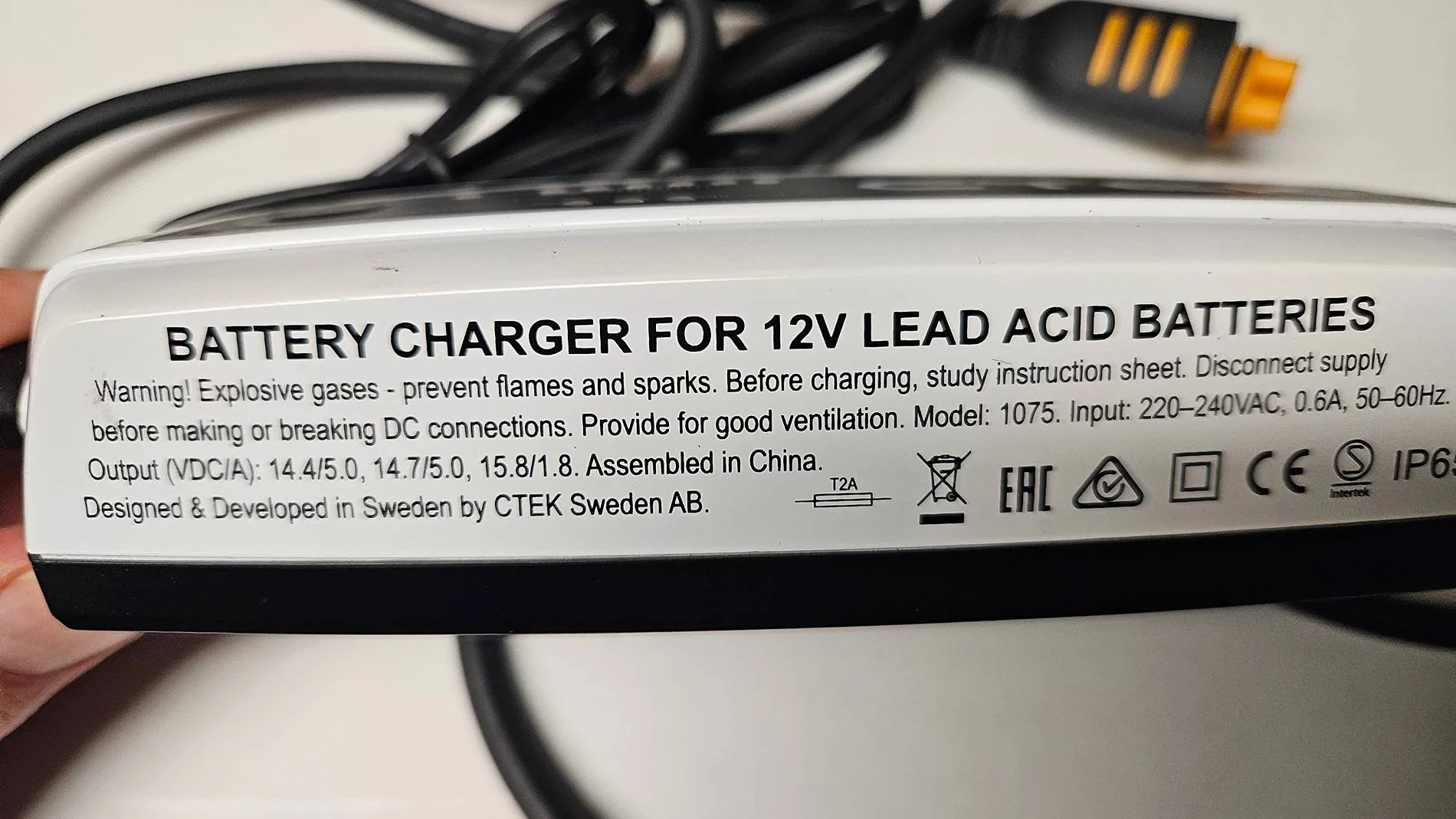

I found this charger in my old man's garage. Can anyone tell me for sure if it is compatible with mach e 12v battery ? Thanks ?
Yes, use AGM mode.
