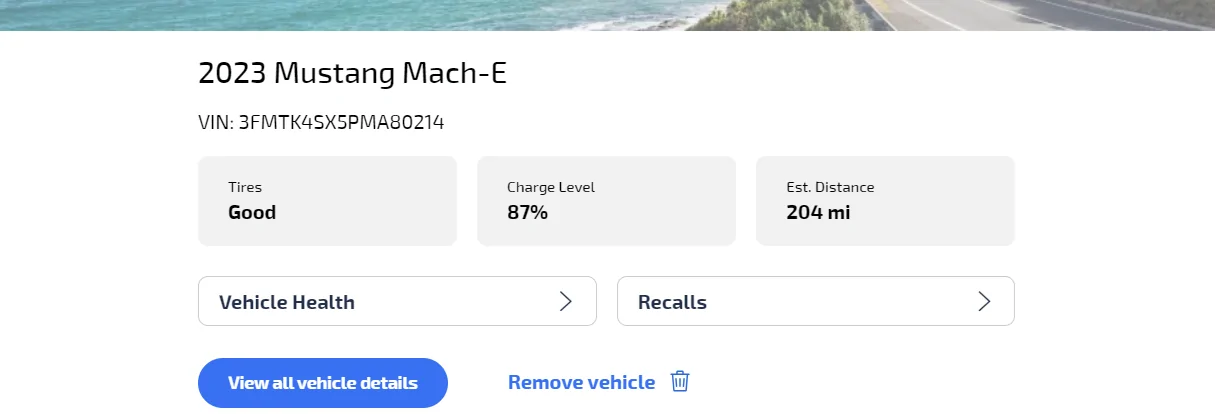

Where can I see the 12V SoC percentage?
Unfortunately, the 12V SoC % is not easily accessible to the user. It is not shown anywhere on the screens or in FordPass. It requires an OBD-II scan tool to read. For a limited time, you can view your 12V charge level on Ford's website here.
It appears that this was finally "fixed." I'm seeing my HVB charge level now:
Ford Mustang Mach-E 12V Battery FAQ 1722531596786-ha

Ok so not just me. Hope It “breaks” again, I really liked being able to check it.
I was wondering why all of a sudden my 12v was reading lower than it normally did.
