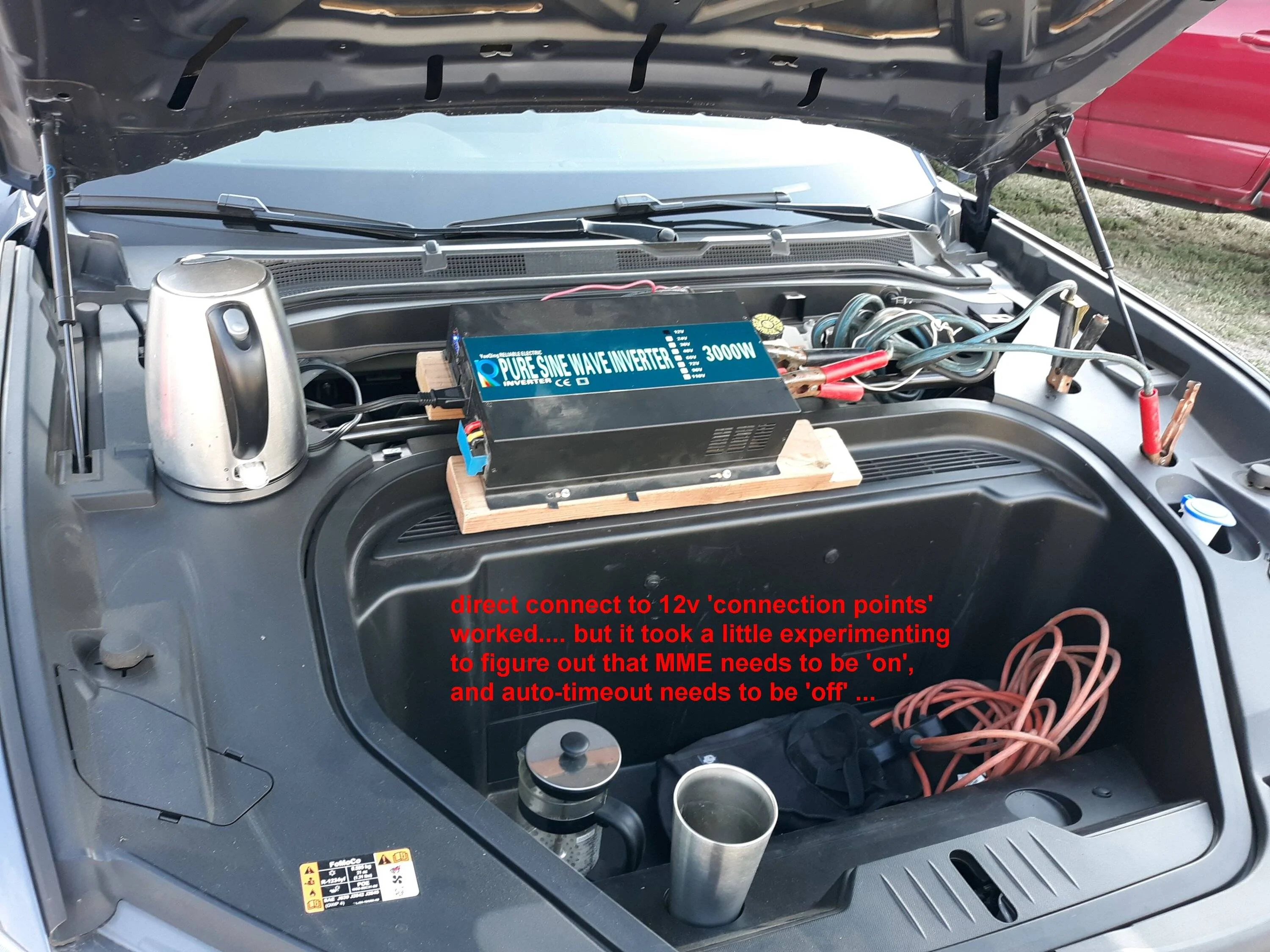

I'm not sure - personally I don't own anything that I can plug into either of them, let alone both.
I have to say, I spent yesterday evening digging around the car looking for the 120V outlet I'm used to Fords having, and I'm really disappointed it isn't here. I guess I just assumed the Mach-E would have one. One of my biggest disappointments with the car so far.
its fairly easy and inexpensive to add a 12vdc->120vAC inverter pulling direct from 12v 'connection points'. best to limit to 1500 watts.
