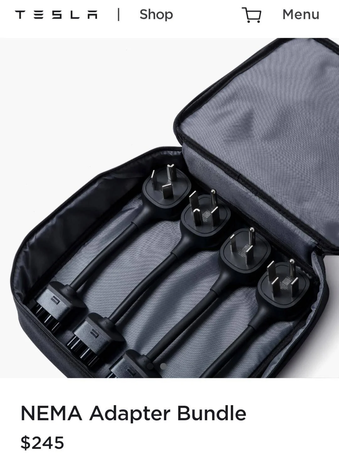

You are correct that it will trip the breaker. There is a EVSE supply out there that has the ability to use 6 different plugs and auto adjust to each supply. I just can't remember the name at the moment.
