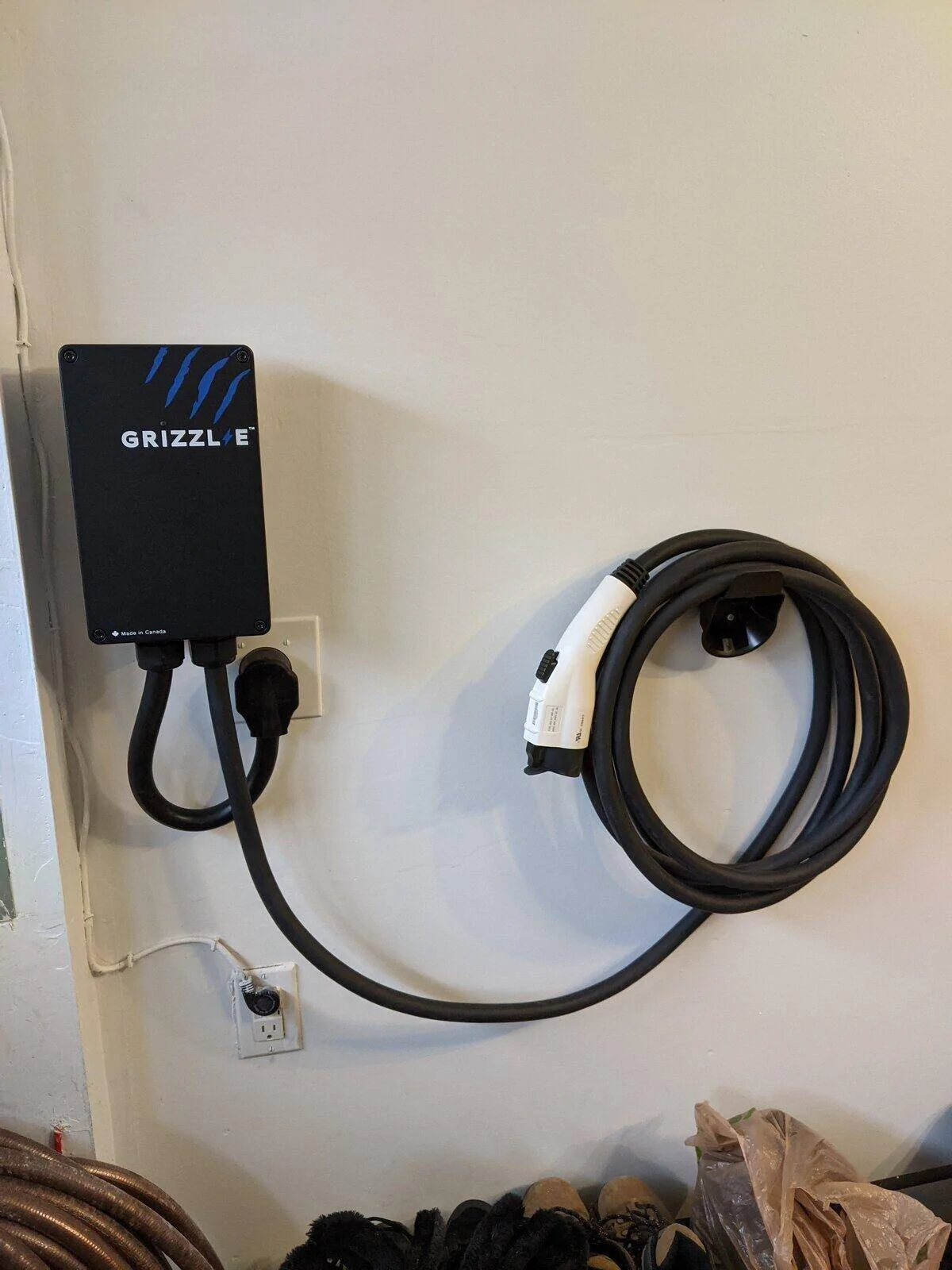

I've had to rotate numerous 14-30 and 14-50 receptacles because the electricians put the ground down like a regular 15A outlet. The cord was pointing up and puts stress on the receptacle. I honestly think it's because electricians do ground down for the small ones, so they like to do the big ones the same without thinking about it more. Electricians almost never plug in dryers and ranges (the appliance installers do that) so a lot of them have no idea they're doing it wrong. The ones that install appliances do it right.
EVSE's are sort of special because they are typically designed to be mounted above the receptacle, so the cord will go up instead of down like most equipment. This is why most good designs such as the ChargePoint have a reversed plug where the cord goes the same direction as the ground prong.
Ford Mustang Mach-E Ground Up or Down for Nema Plug 14-15 Installation? Ev_T4c7XAAAgeSa
Others such as Grizzl-E use a normal-spec cord so this happens:
Ford Mustang Mach-E Ground Up or Down for Nema Plug 14-15 Installation? 1616634369414-png
The receptacle is the same orientation in both cases. I don't care for the resulting sharp bend (cords have minimum bending radius specifications) and torque on the receptacle. In this specific case the receptacle should have been rotated ground down so the cord could go straight up to the EVSE (sorry sockmeister).
So the tldr answer is the receptacle orientation depends on the specific EVSE cord and mounting location you're going to use. Ground up is more common and is the correct way for the ChargePoint, the Ford Mobile Charger, and most other appliance/RV cords. Ground down may be required if mounting the EVSE above the receptacle if it does not have a reversed cord such as the Grizzl-E.
A smart electrician will ask to see the cord before installing the outlet so the orientation will be correct. If you watch Tom Moloughney's State of Charge, you'll notice he has outlets in both orientations on his charger wall to work with different chargers.
I just bought the Grizzl-e and will have to do what you did with yours, turn the cord/plug upside down. Not thrilled about that. Called Grizzl-e and they actually suggested mounting the actual box upside down, but then that would lead to some tension on the cord with the charging handle. So not entirely sure what to do (other than having my electrician flip the outlet for me so the ground is on the bottom).
Have you seen any negative effects of having the Grizzl-e cord twisted like that?
FYI that is not my picture, I have a ChargePoint. I haven't heard of problems after people bend the Grizzl-E cord like that, but I don't like it. I've seen people mount them upside down too, and I don't like that either. Either way you're putting stress on a cord. To me it's worth the extra 10 minutes to flip the outlet, but if that involves an electrician that's up to you to decide if it's worth the cost.
