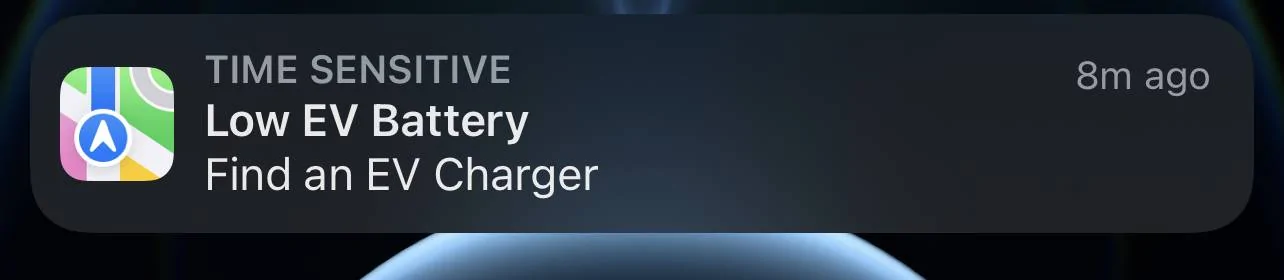

It's when the car says low battery it informs CarPlay it is low. It does the same thing in a gas car when the gas light comes on.
So yesterday it thought I was low at 89% ;). My car had been down below 25% in the orange zone two days before. Given how slow Fordpass notifications have always been for me I shouldn't be surprised with a 48 hour lag.

It is not completely useless though. While driving, when the Mach-E pops up the notification in the driver's display that the EV battery is low, you also get a Low EV Battery banner that pops up across Apple CarPlay no matter what app you are on. If you touch that banner CarPlay instantly goes to Maps and displays a list of the closest charging stations.

Settings > Notifications > Maps
Turn on "Time Sensitive Notification"
Banner Style choose "Persistent"
Show in CarPlay "On" (if you also want a banner to show in CarPlay)
Or alternately, when the banner does show up on your phone's lock screen, just swipe left, choose options and you can select it there.

I think I may have found the culprit in relation to this bug, but I wanted to see if others’ experiences were the same.
On Sunday nights, I charge to 100% because I have a long commute on Monday to the office (35 miles), then drive to school to teach (another 30 miles), and then 65 miles back home again. I know I could fit it fine into my regular 90% charge, but I like having the extra buffer “just in case.”
When I pull into the parking garage at the university, and put the MME into park, I get a message from SYNC (definitely a Ford message) that I won’t be able to get to 100% charge (which is strange to care about since I set a max of 90% at home, but whatever) with my charging settings before my scheduled morning departure. Now, I’m sitting on like 71% battery at the time, but the MME has made the decision that given the elements and my typical driving style (somewhere between moderate and grandma), that when I get back home from being so far away, plug in, and charge, that the MME won’t be at full by the time I’ve told preconditioning that I’m going to depart. I allow charging anytime since I don’t have timed rates, but it was counting the hours that my charging takes and said, “Nah, son. Not gonna make it to where you want to be in time.”
Shortly thereafter, I’ll get a notice from Apple Maps on my phone telling me that I’m at 71% and that I need to find a charger.
What I think is happening is that the handshake between the Mach-E and CarPlay that carries this information is being misinterpreted. Instead of CarPlay understanding that if I don’t plug in now, I won’t reach my ideal charge by tomorrow morning, it just hears “plug in now” and displays what we perceive as an incorrect error message. Yes, it’s incorrect as it’s worded, but it did receive a warning about a low battery potential condition and interpreted it as a current low battery condition.
Is this similar to what others are seeing when CarPlay begs you to plug when your battery is fine? Are you far away from home and/or won’t be able to get to the top-end of the charge window with your charge/precondition times by the time you get home?

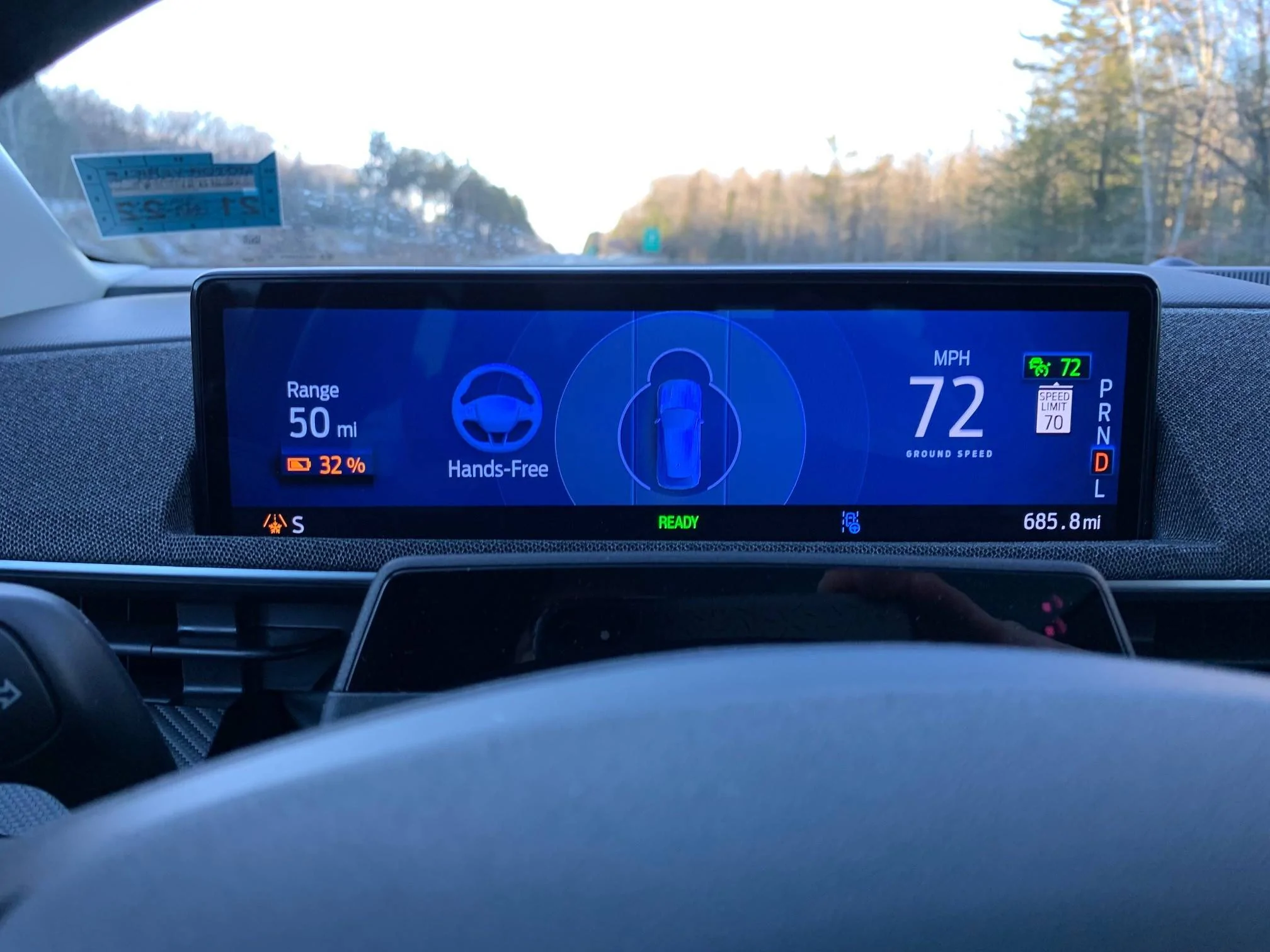

I think this feature as been there for a while, at least on Job 2 cars. I do not think it has anything to do with the recent fordpass or Apple updates. It is part of the current Job 1 car OTA's as noted 2.3.0.
When I first got my Job 2 in November, I did a bluecruise and range test for 200 miles. I had not adjusted all the settings and my low battery alarm was incorrectly set to 50 miles. When I hit 50 miles, on the freeway, my Apple maps came up on the screen and the available chargers were all shown. I was not using NAV or Apple maps at the time, I was connected through Carplay though.
I like that feature, but I wish they had the full Carplay EV integration. They do not......yet
