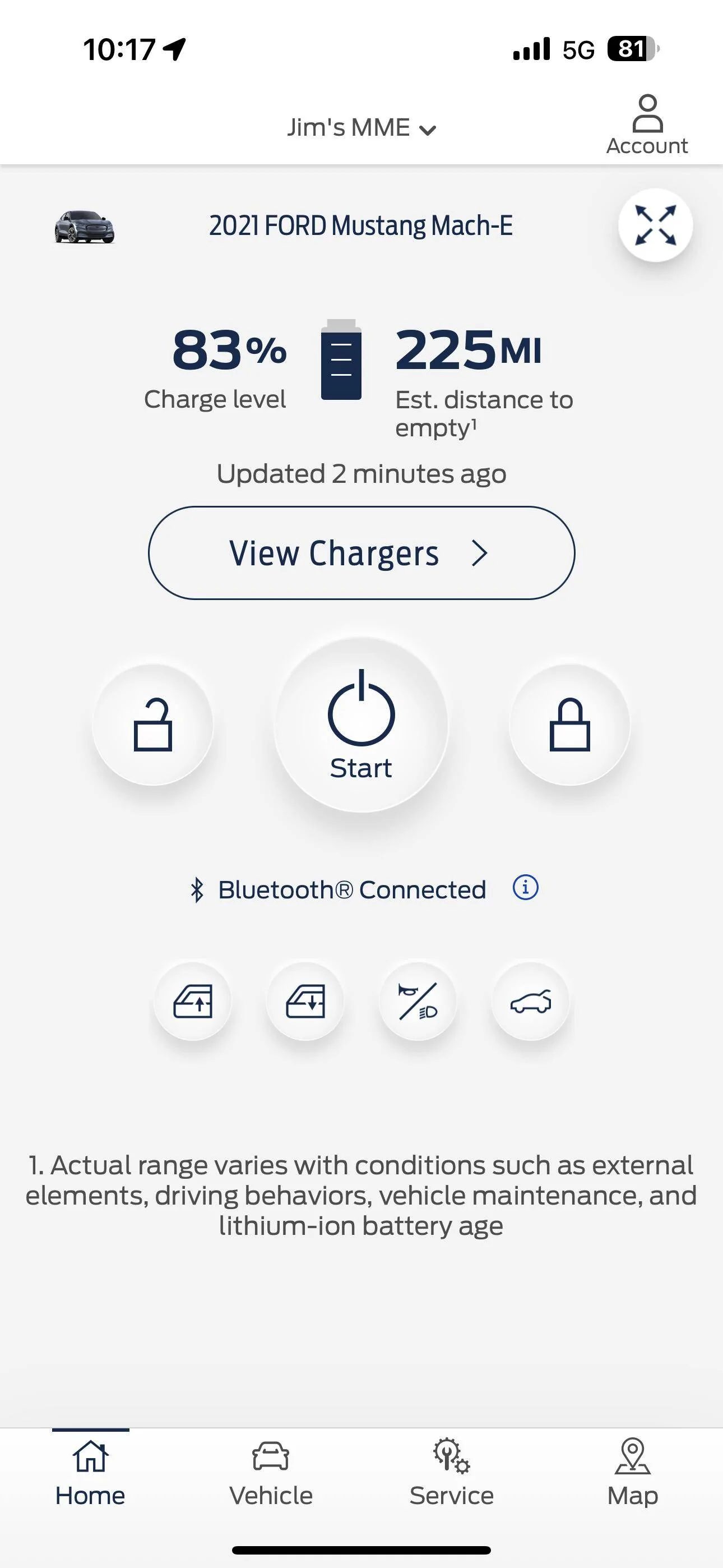

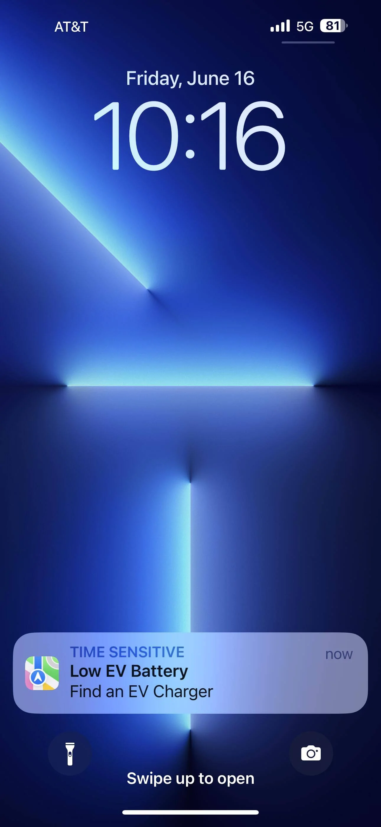

This is just annoying. Apple thinks my MUstang Mach E battery is low when it’s over 80% ?‍♂ I get this all the time ?
The Mach E was the first car to get this feature. You could have a real bug. Contact Apple, their support is really good.

I used to get this *all* the time. At some point, it went away, except when I really did need to charge. I got one notification about it this week, which surprised me since it seemed to have been fixed. Out of curiousity, do you use PaaK or the fob? I almost always use PaaK, but thought I might have use for the frunk on a trip this week so brought my Lightning fob. I think, but I'm not 100% sure, that was the day I got the low EV battery warning.

I wonder, while your vehicle was over 80% at the time you took that screenshot, do you by chance arrive home often at a lower state of charge? As others said, Apple Maps only gets an update with the state of the vehicles charge when connected to the vehicle. So if you get home at 10% and then plug it in and go inside, your phone has no clue what your vehicles SoC is until you connect again.

So, yes I understand it's annoying. But there is a reason it's happening. The App does NOT hand the better data to the vehicle. It can only share data when the vehicle is connected via CarPlay. The numbers can get very off if you don't always use CarPlay.
I rarely get this notification, but definitely have when the battery wasn't low. Reconnecting the phone resolves the issue.
Bluetooth connections don't data share like CarPlay does since the Wifi connection has more bandwidth to handoff more data. So it doesn't matter if your connected to bluetooth. If you don't use CarPlay on trips, then I would suggest removing the vehicle in Apple Maps to disconnect the EV routing features.

I got the low EV notification last night and I'm on iOS 16.5.
I notice it happens when the phone connects in accessory mode or after the car is shut off. The battery level seems to only be available to iOS while the ignition is on, and the car will return a zero value when polled at other times.

Probably the module isn’t active in accessory Mode that talks with iOS. In either case, if the issue happened in iOS 16.4, I’d remove the vehicle from maps and re-add it to see if the issue persists.
