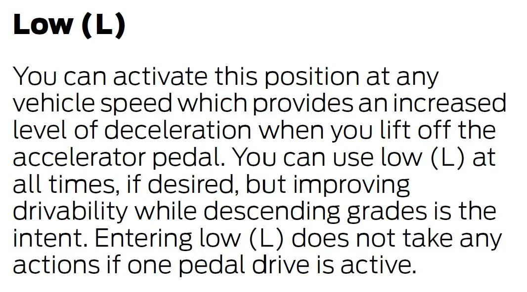

Note the text on the "L" drive selection on the PRNDL:
So when 1-pedal mode is on shifting to "L" does nothing.
How I see it is with one pedal driving, the more you depress the accel pedal, the more you will brake.
And with the L mode, when you lift OFF completely the accel pedal, it will decel the car, like when we downshift in a ICE car.
it would make them 2 different thing
1 pedal mode re-maps the accelerator pedal position sensor to negative-zero-positive. So the more the pedal is depressed the more it accelerates. Hold steady=steady speed. Lift off has negative acceleration (braking).
