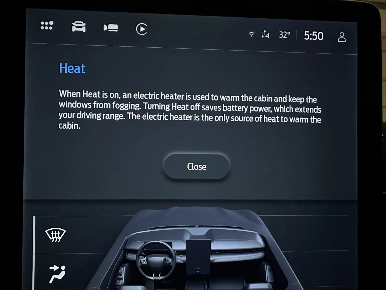

As an aside, I noticed the Heat button in my 2025 still has this explanation. Maybe they should update it to mention the heat pump. Something like "Cabin heating is provided by a combination of the heat pump and the electric heater."
I’ve never seen that dialog. And I keep my cabin at a comfortable 76-78F in the winter.
It's from an info icon accessible in the climate settings menu.

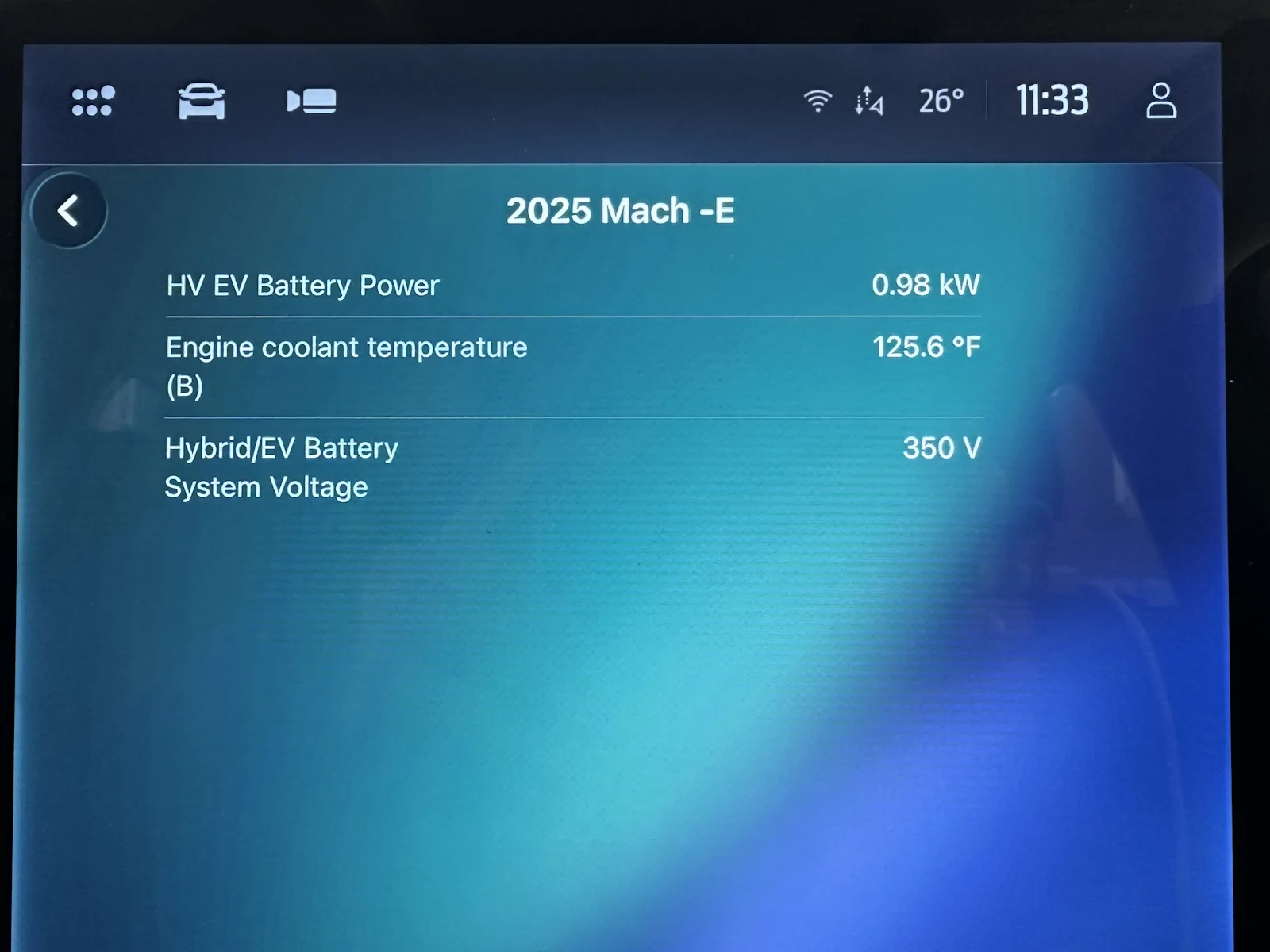

To work on modern Mach E Heat Pumps you need to understand CPU based diagnostics, how it all integrates with the car computer operating system
One thought about the servicing for these: since the "Heat Pump Assembly" is a single integrated unit, I assume most technicians will just replace the whole thing if there is an issue. Sort of like how a failed motor inverter or DC-DC converter are probably just replaced instead of taken apart and repaired. So technicians might not be expected to understand heat pumps on that deep a level (such as trying to find which of the three expansion valves is bad)
Anyway I hooked up CarScanner and watched the power draw during startup. You can't read as many sensors on 2025+ models due to new "encryption" protocols on the CANBUS, but here's what I could gather.
Exterior temp 26F, climate set to 70.
Accessory mode (headlights off): ~0.32kw
Initial power draw: ~7kw for a few minutes, then slowly ramps down.
Steady state after about 10 minutes: ~1kw.
So I guess the heat pump draws around 0.7kw to maintain cabin heat? Not sure how that compares to PTC heater-only models.
