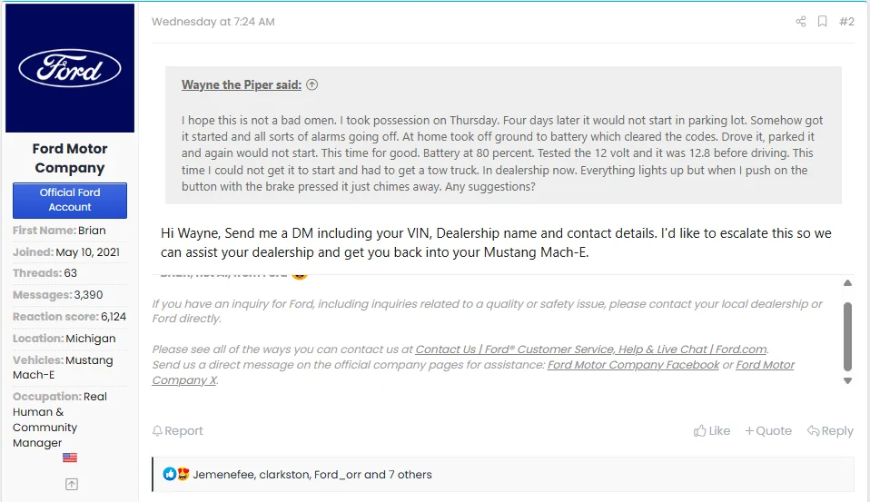

2025 MachE Just purchased and it died.

Something similar happened to my 2.5 day old 2022 back when I bought it in March 2022. I'm nearly certain it was just that the 12V battery was too low, not helped by the fact that the car was delivered to me with 6% on the HVB and I only had 120V charging at home at the time. The dealership addressed everything (for free, of course) and provided a loaner too. Those problems never came back. It is likely the 12V battery. It might be dead, or it might just need a good long deep charge. (Obviously it could be other things instead, but IMO the most likely is the 12V.)
