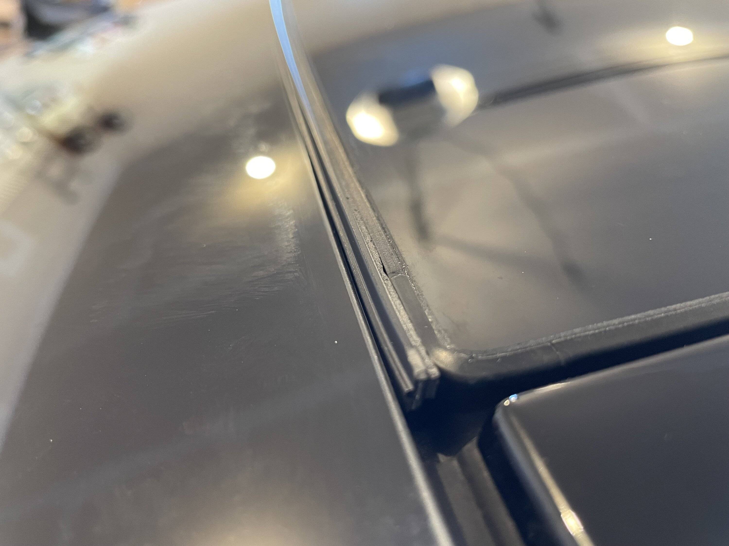

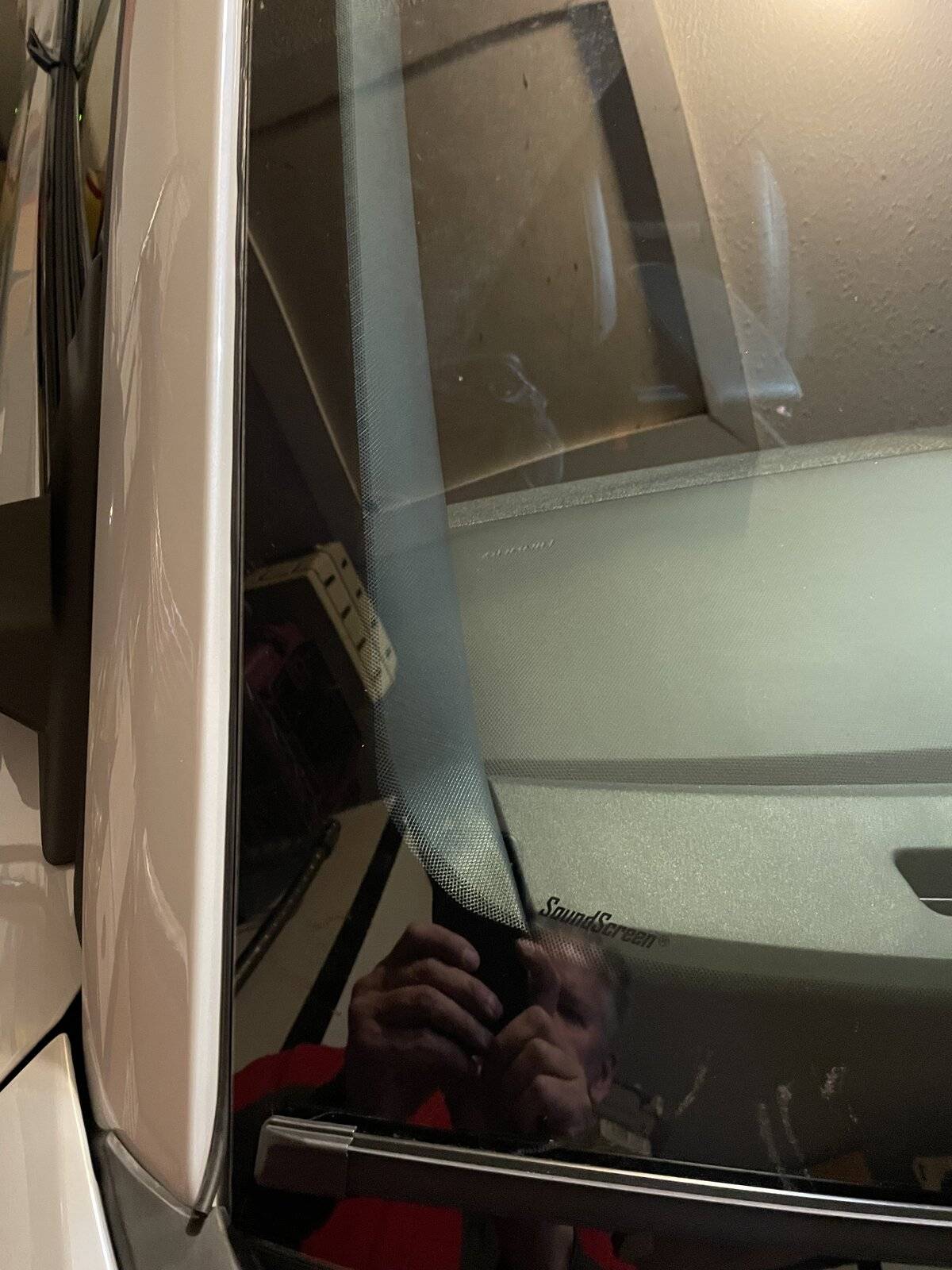

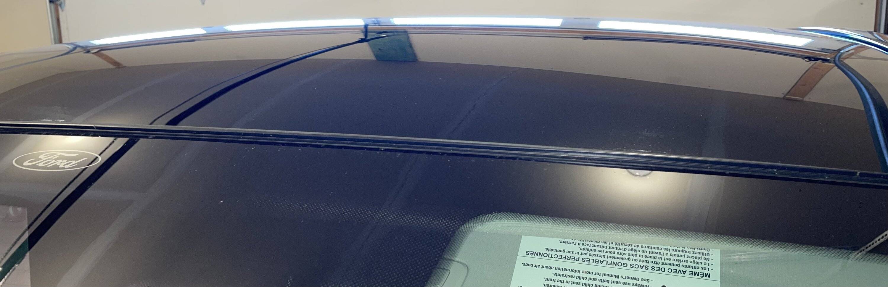

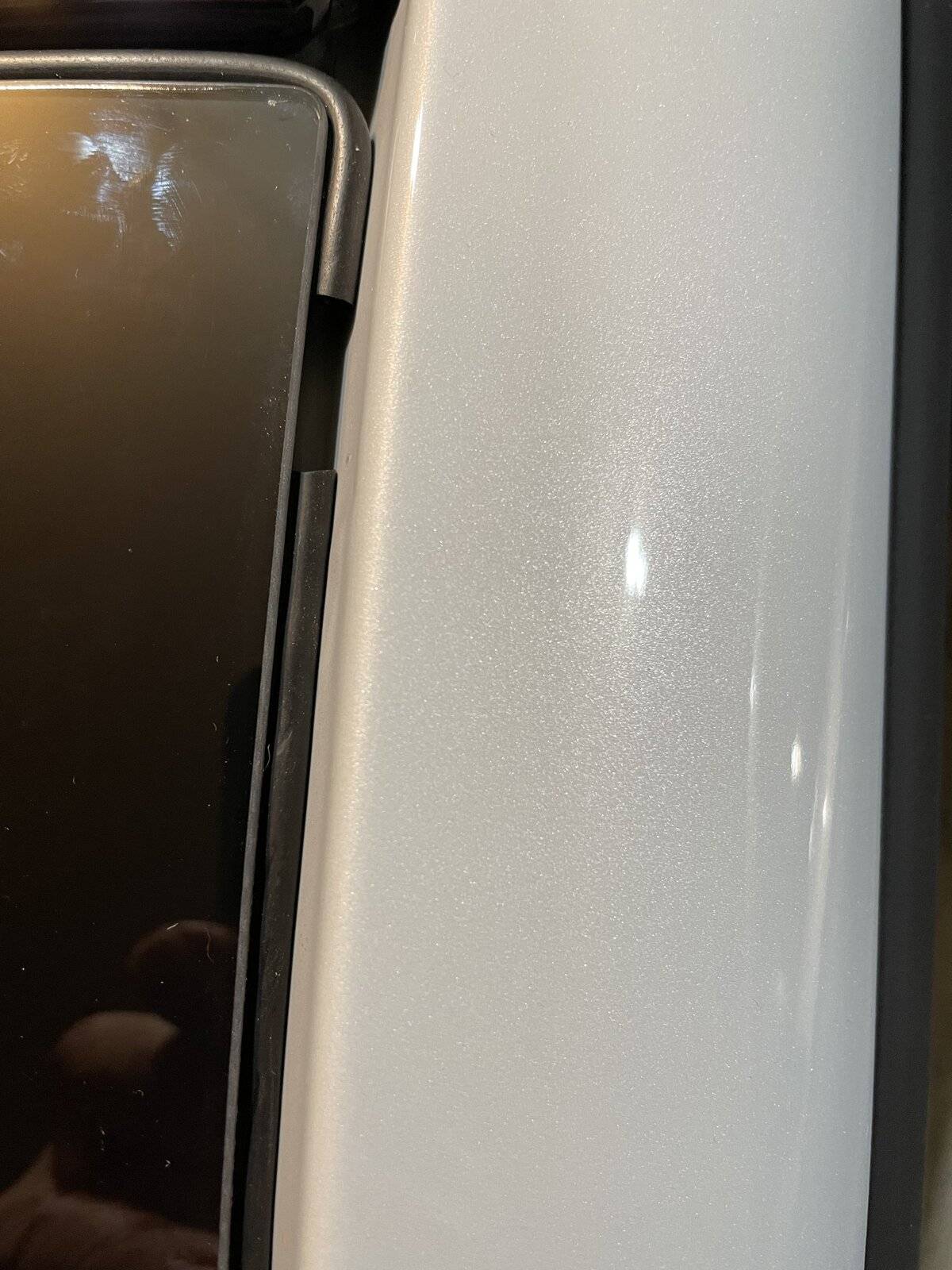

Just received my MME GT 2 days ago. Wind noise at the seam between windshield top and front panaormic glass plates.

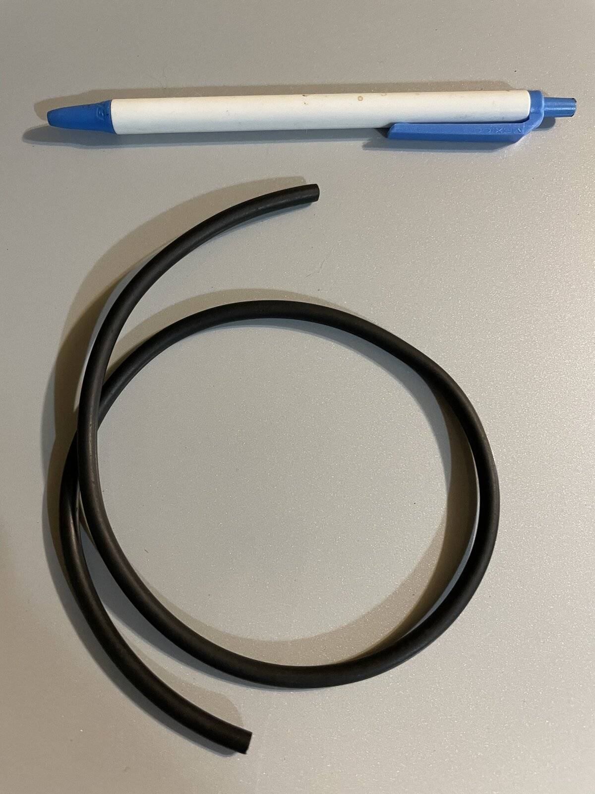

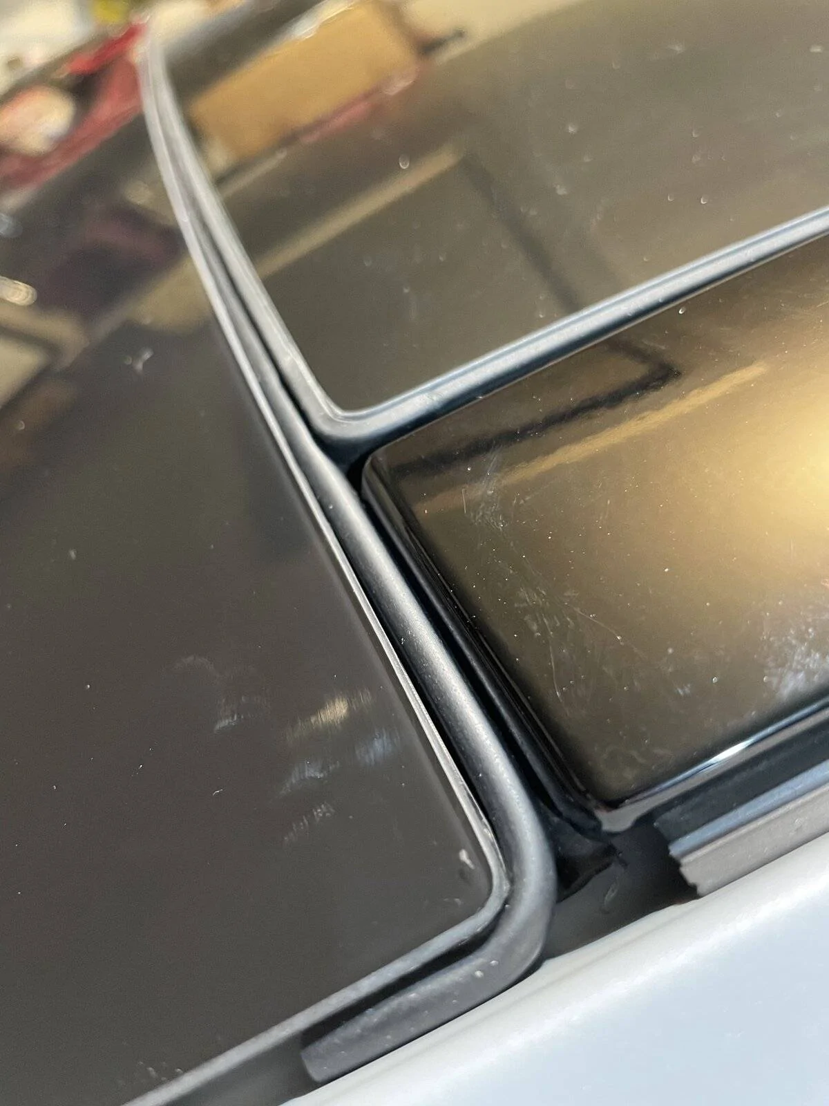

Today I stopped by an auto parts store and picked up 8ft of some 1/4" O.D. black tubing that could be like an engine's vacuum hose tubing. Stuffed it all along the windshield's 3 sides. Wasn't too easy. Had to really pull on the tubing to make it skinny and then stuffed it in.
Mine generated windnoise pretty much every time over 30+ mph.
Took it for a spin and the tubing seems to have eliminated maybe 75% of the wind noise. Plus it now remains quiet until 45 - 50 mph.
Before the tubing, it was or should have been unacceptable levels. Now it's about what one might expect from a new car. Very little.
Hopefully just a temporary fix until the real fix comes along.

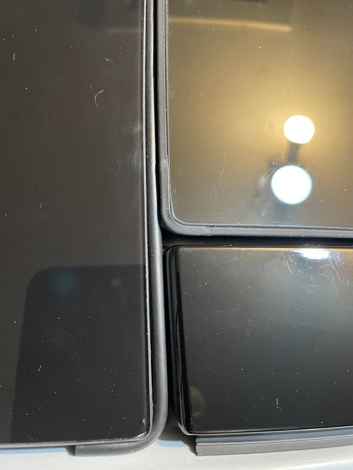

I know this is an old topic, but I wanted to add my experience after just having solved my roof wind noise issue. Quiet finally! I have a 2022, and the windshield sits about 4.0 mm underflush in the center, which is just under the maximum spec but was still way too noisy. I first bought the Amazon weatherstrip others recommended to bridge the gap, but the 4 mm height difference was too great on my car to make that work.

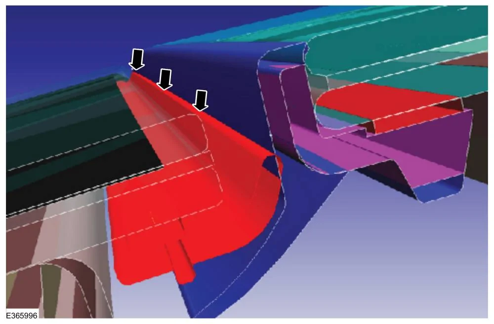

I then decided to try the Ford weatherstrip LJ8Z-5803136-A listed in TSB 21-2369. However, upon receipt I found it wouldn't fit in the gap the way the TSB dictates. My windshield was installed further upwards, so the gap at the top was less than 3 mm and the strip was too wide to fit in the gap.
Ford Mustang Mach-E [4th Update...Kinda] Wind noise from panoramic roof 21-2369 weatherstri

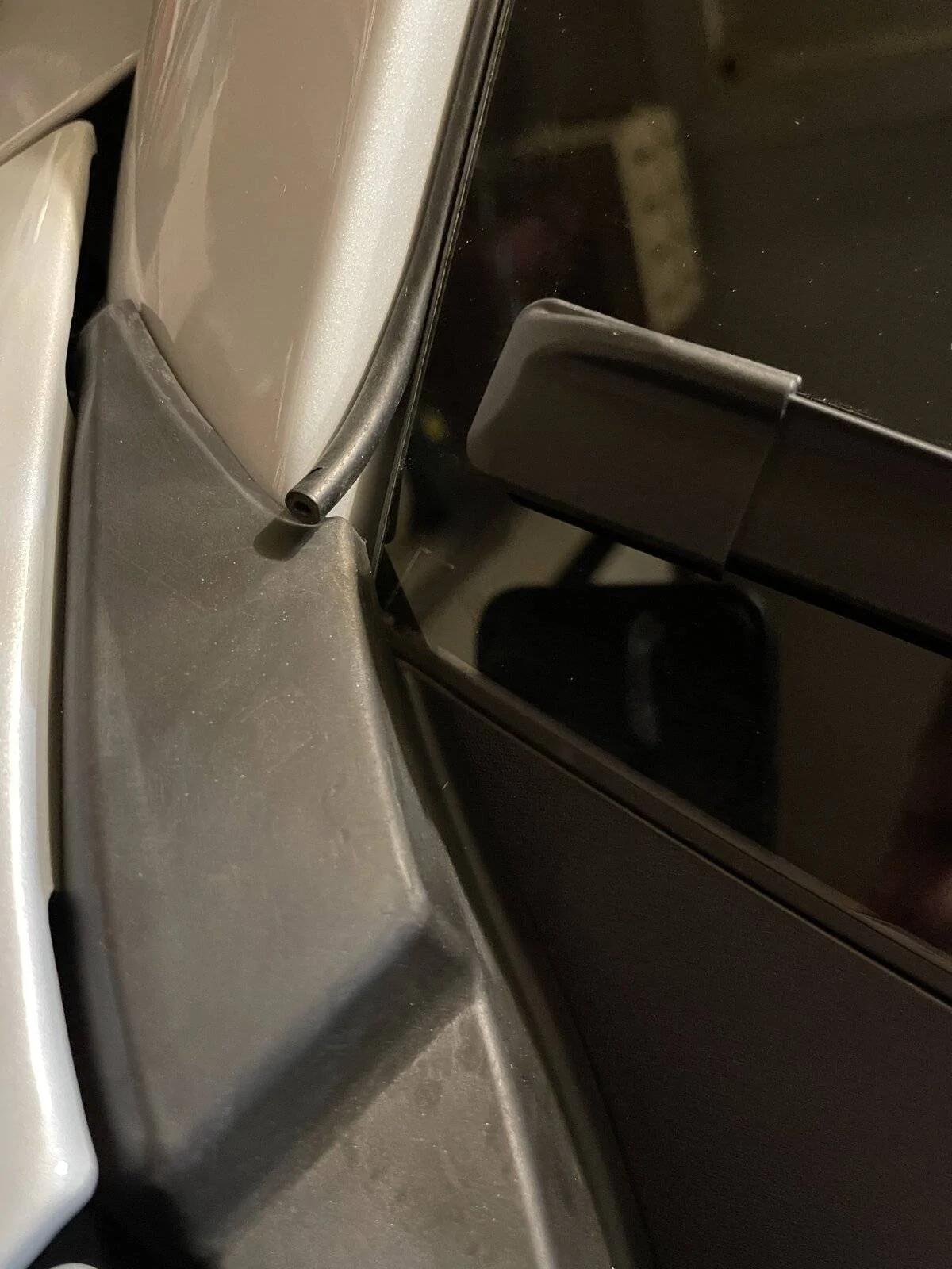

Image: windshield left, roof right. Normally the adhesive end should be inserted first so it can stick to the bottom of the windshield as shown above. However I ended up flipping the weather strip over and inserting it vertically so the adhesive would stick to the rubber around the roof glass instead. There is a ridge on one side that sticks out, I pushed the strip down until that was touching the windshield and used it as a depth gauge. The strip then fills the gap at the top of the windshield and sticks up about 1/8" to become flush with the roof.
Ford Mustang Mach-E [4th Update...Kinda] Wind noise from panoramic roof Roofline
Ford Mustang Mach-E [4th Update...Kinda] Wind noise from panoramic roof Strip install
As an added bonus, this will also provide additional protection against rocks hitting the vulnerable edge of the glass roof. From a distance you can't really tell anything is different.
I was blown away by the difference. Totally fixed. Now I can't hear any wind noise coming from the roof. It's so much quieter, I'm turning the radio down. Went from volume 8 to volume 6 at 75 MPH. Another totally unexpected bonus is that speed compensated volume (SCV) actually works now. Before I was constantly having to turn the radio down at stoplights, then turn it back up at speed, now I don't have to! The slope of the SCV noise gain curves was likely set with an exemplar Mach-E with no wind noise issues. If you have wind noise, the High setting is not enough gain.
Now the primary wind noise I hear is coming from the mirrors through the side windows. Unfortunately Ford cheeped out and removed the nice laminated sound-insulating side windows on 2022 Premium models, so I may have to get my tempered windows replaced with laminated to get the cabin wind noise down to what it always should have been. Cabin noise is currently at 64 dBA @ 70 MPH, maybe I can get that down 1-2 more dB with the laminated windows.
If you aren't sure if you have roof wind noise, here's the test. Use 2" wide masking tape and tape over the seam across the top of the windshield. Then go drive 70+ MPH. If the car suddenly seems WAY quieter, you have a roof noise issue. There should be no wind noise coming from the roof. When I did this test, the tape actually ripped itself off after a couple minutes, and the difference I heard was shocking. After the tape left, it basically sounded like somebody cracked open a window! So it's a very significant noise source on problem vehicles.
Unfortunately the windshield flushness and gap varies on different Mach-E's, so what works for one person may not work on your car. You may have to try a few different solutions until you get something that works well, there are lots of ideas in this topic.
