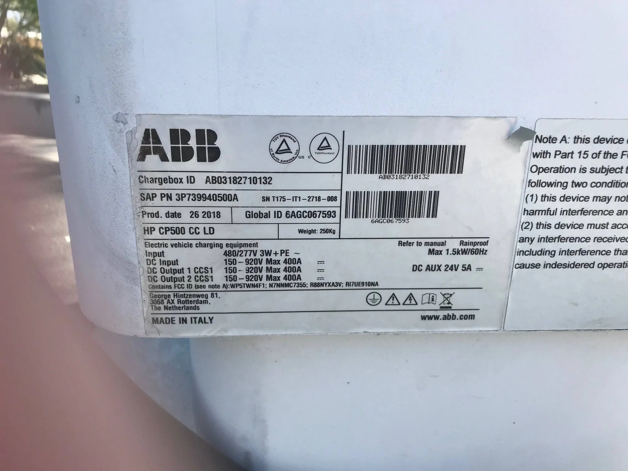

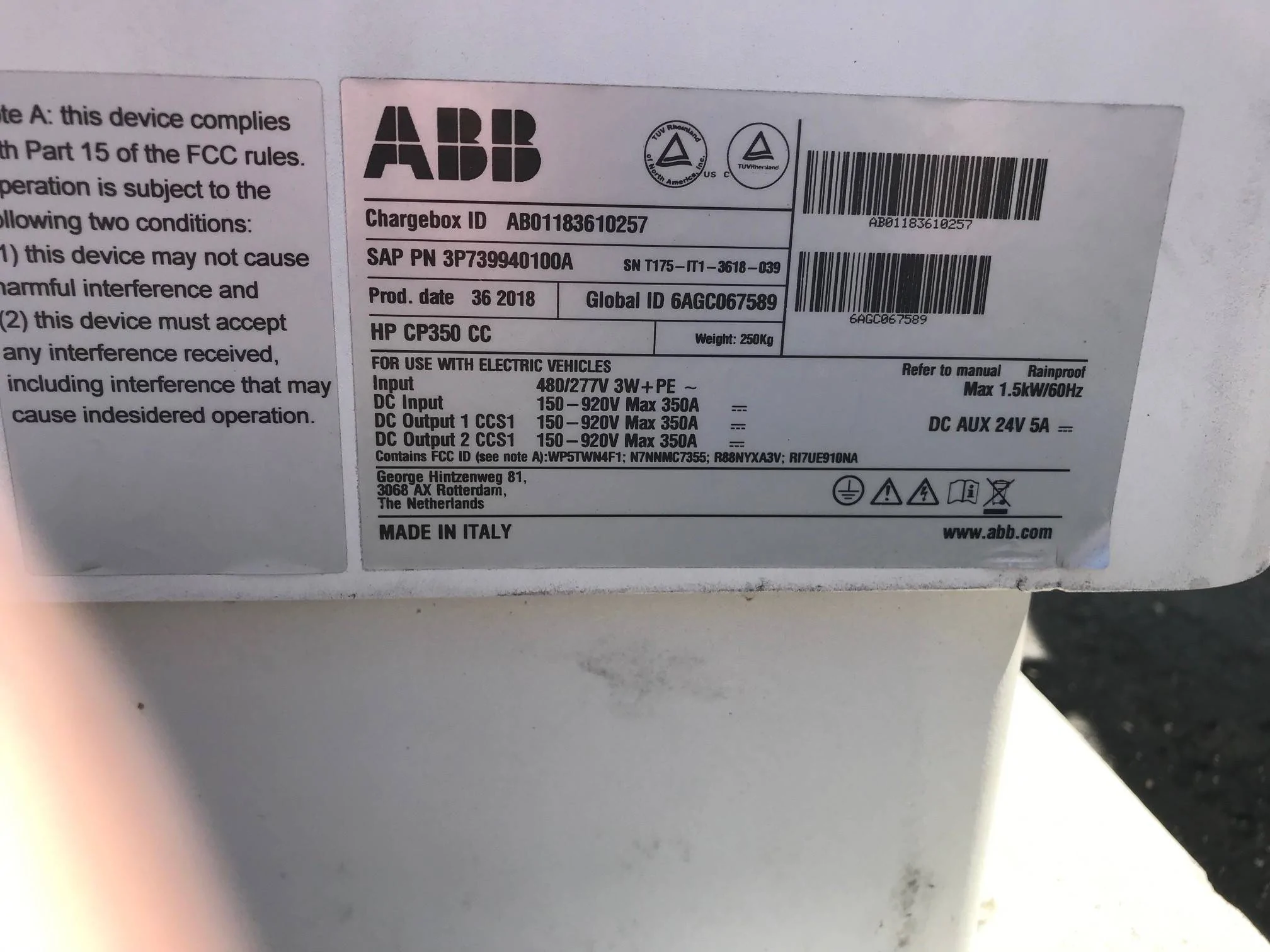

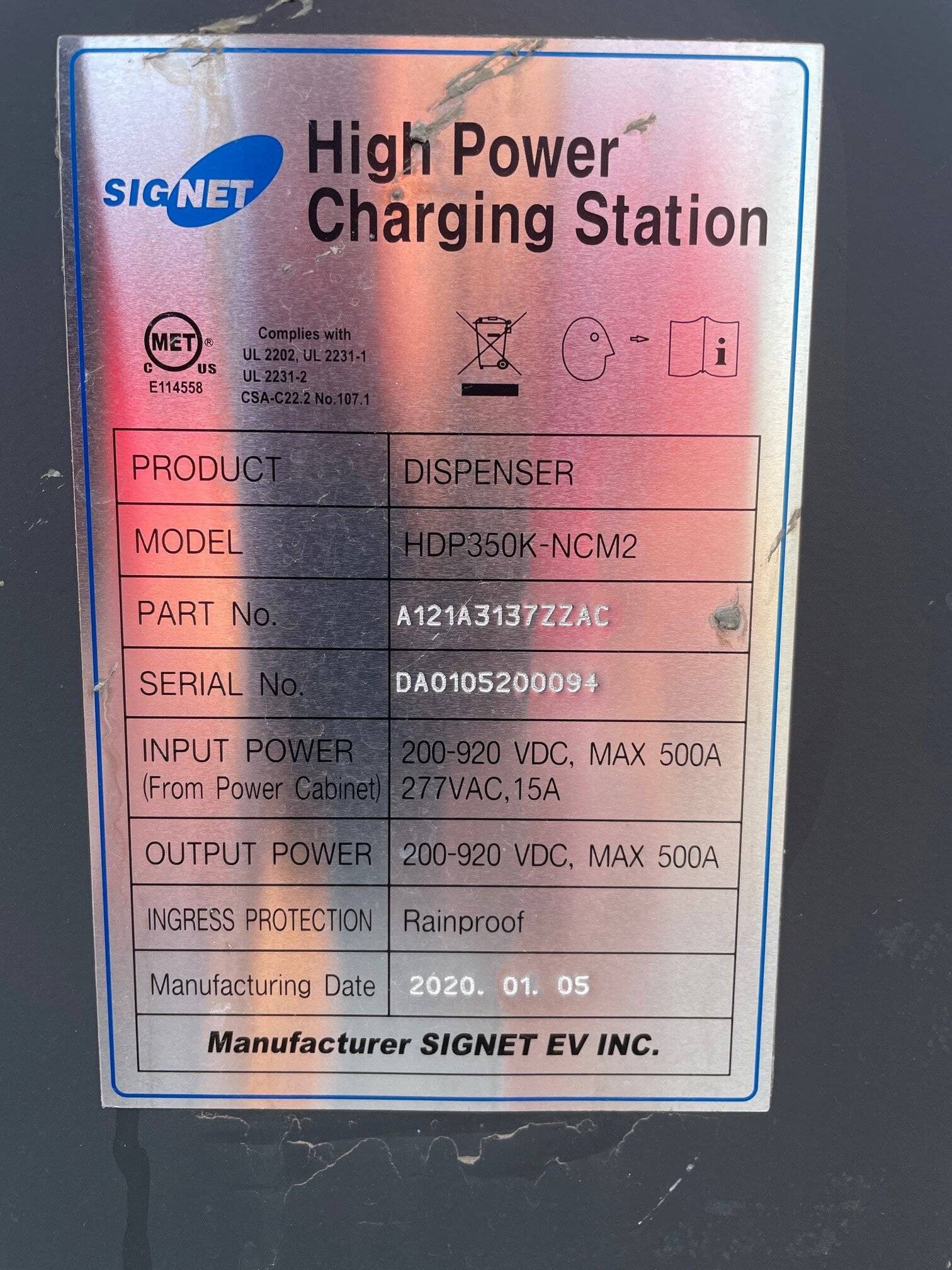

It had never occurred to me to check the amperage rating on the charger before as I always assumed it would max out based on whatever the kW the charger was.
I have personally read the nameplates on the EA chargers, both Signet and ABB. ABB has two different dispensers for 150kw (350A) versus 350kw (400A), Signet only has one dispenser for both power ratings and all are rated at 500A. Here you go:
Thanks for posting some actual nameplates! One thing to keep in mind with ratings on power electronics like these is that the maximum voltage and the maximum current usually can't happen at the same time, so while the maximum current might be 350A, the unit probably can't do 350A at 920V. There will be some intermediate voltage where maximum current is possible, and the current at lower and higher voltages will be reduced.
These max values are also usually "maximum under any conceivable operating conditions" and usually don't include temperature derates and other reductions to the max current setpoint that will be in effect in actual use, so the units may never actually hit 350A or 400A in the real world.
