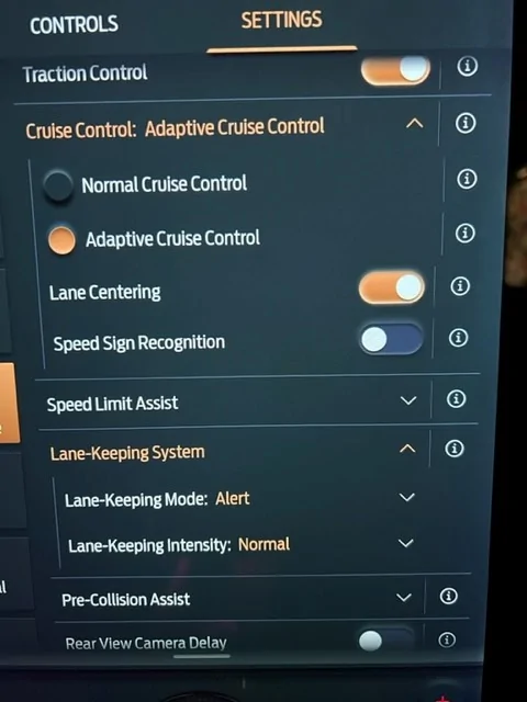

I just received the 2.7.4 update and was testing it out to see what changed. I know it doesn't have BC but was turned on the cruise control just for kicks. It didn't have the blue bubble, lane-centering. No cars in road and it drifted to the other lanes. I figured maybe the settings were reset to default or something. Went to settings and everything related to it was turned ON/Enabled. Is it a bad update or did we lose that function?

@mamejunkie do you have lane keeping turned on? The bottom right button on the left side of the steering wheel. I think that has to be on for lane centering cruise control to work.

Didn't see an update on this...but...you've figured it out right?
Lane keeping mode needs to be set to more than "Alert" or it won't help keep you in your lane.
Also that steering wheel button on the left side needs to be turned on if it isn't, or LK won't work either.
