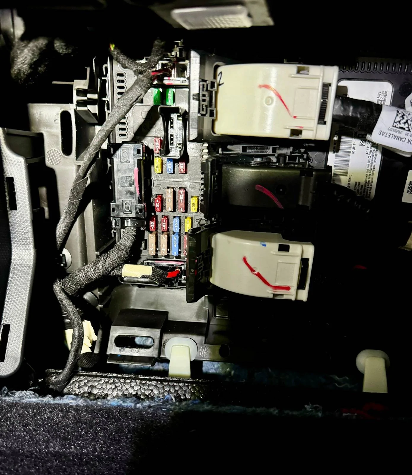

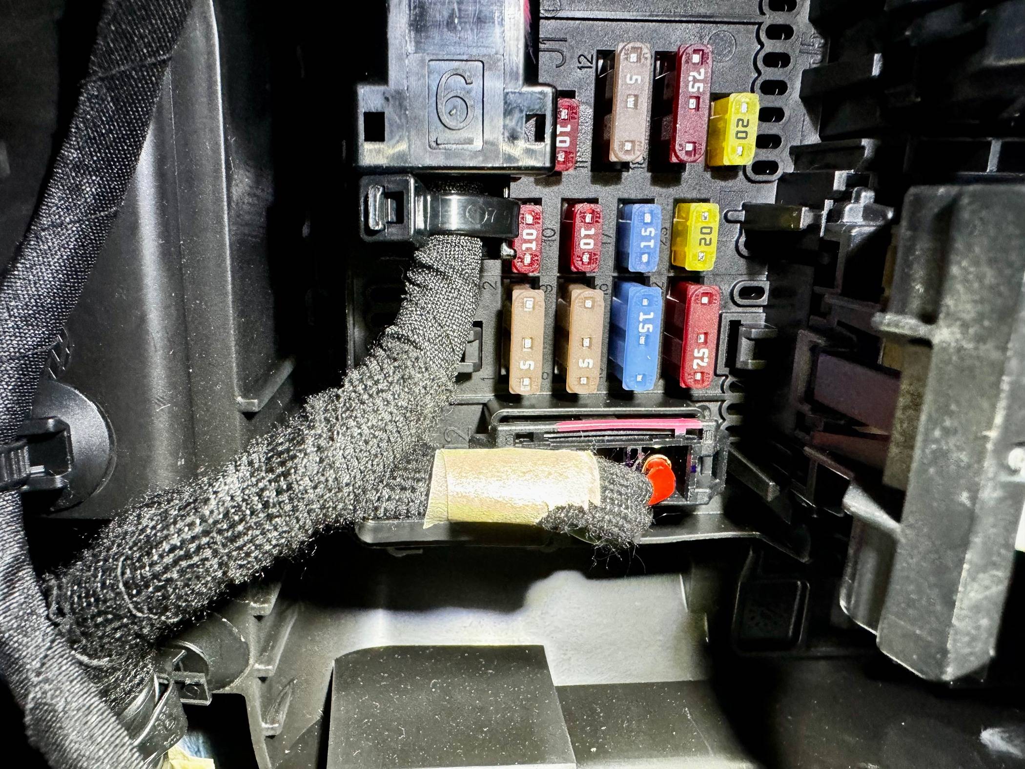

Thank you, have had the car two weeks and after coming back from a short drive the car lost all connectivity. Unfortunately, I reset the app, reset the screen, etc before finding your post. Nothing worked. Then I followed your directions and removed that one power line in the passenger footwell fuse panel. Waited ten seconds and reconnected. Now everything works again. Thanks for the tip on the release tab too. Such an easy fix. Now I know what to do first next time.
been a couple people recently reporting your same or similar experience and pulling that particular fuse or unplugging the battery seems to be the solution.
