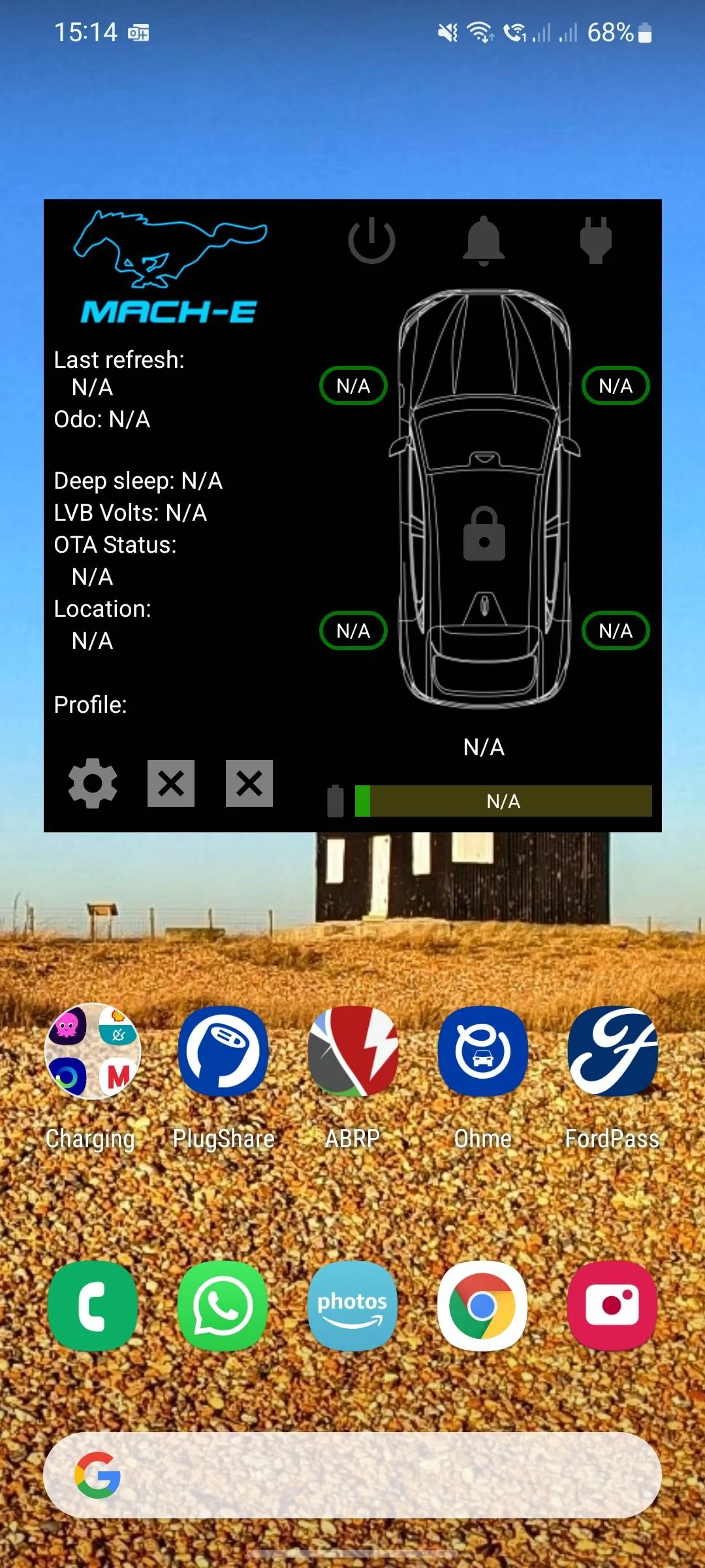

I changed phones recently and the widget isn't displaying data and is crashing the app after adding to my home screen (using Lawnchair launcher as before). The app-side appears to work initially to log in and setup as usual, but once I add the widget the widget just displays N/A for everything then the app the crashes immediately without error when trying to open. After I removed the widget I can open the app ok again. Can't seem to see anything obvious in the logs but happy to help with any defect triage/testing if you're able to help?

Create a new bug report issue on GitHub and I'll work with you there.

I have the same issue on Android 12. I have installed version 2022.03.02: the app does not crash anymore and the widget shows correct data.

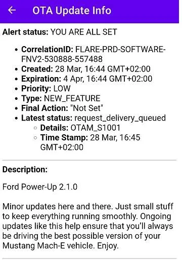

kennelh, can you explain me this OTA update info? On the Mach-E SYNC display I get no update notifications. Thank you

Great it now works on my Sony Xperia with my GT ! Only thing not working is the OTA info.
Getting "unavailable"

Can you see the OTA info from the three-dot menu? If not, then enable logging, let it run a little while, then save the log. Create a new issue on GitHub and I'll look at it.

04/01 22:17:09 D OkHttp3: <-- HTTP FAILED: java.net.SocketTimeoutException: Read timed out
04/01 22:17:09 E 934TXS: java.net.SocketTimeoutException in NetworkCalls.getOTAStatus
04/01 22:17:14 D OkHttp3: {"displayOTAStatusReport":"UserAllowed","ccsStatus":{"ccsConnectivity":"On","ccsVehicleData":"On"},"error":null,"fuseResponse":null,"tappsResponse":{"vin":"WF0TK4Sxxxxxxxx","status":200,"vehicleInhibitStatus":null,"lifeCycleModeStatus":{"lifeCycleMode":"NORMAL","oemCorrelationId":"","vehicleDateTime":"2022-02-02T06:56:23.000Z","tappsDateTime":"2022-02-02T06:56:26.482800Z"},"asuActivationSchedule":{"scheduleType":"","dayOfWeekAndTime":null,"activationScheduleDaysOfWeek":[],"activationScheduleTimeOfDay":null,"oemCorrelationId":"","vehicleDateTime":"","tappsDateTime":""},"asuSettingsStatus":{"asuSettingsState":"ON","notificationSettingsState":"ON","oemCorrelationId":"1793","vehicleDateTime":"2022-04-01T16:29:39.000Z","tappsDateTime":"2022-04-01T14:29:40.457556Z"},"version":"2.0.0"},"updatePendingState":null,"otaAlertStatus":null}
04/01 22:17:14 D OkHttp3: <-- END HTTP (840-byte body)
04/01 22:17:14 I 934TXS: OTA status successful.
I guess this is the problem ?

Yes, there's no fuseResponse in the report. That's where all the data would be.
