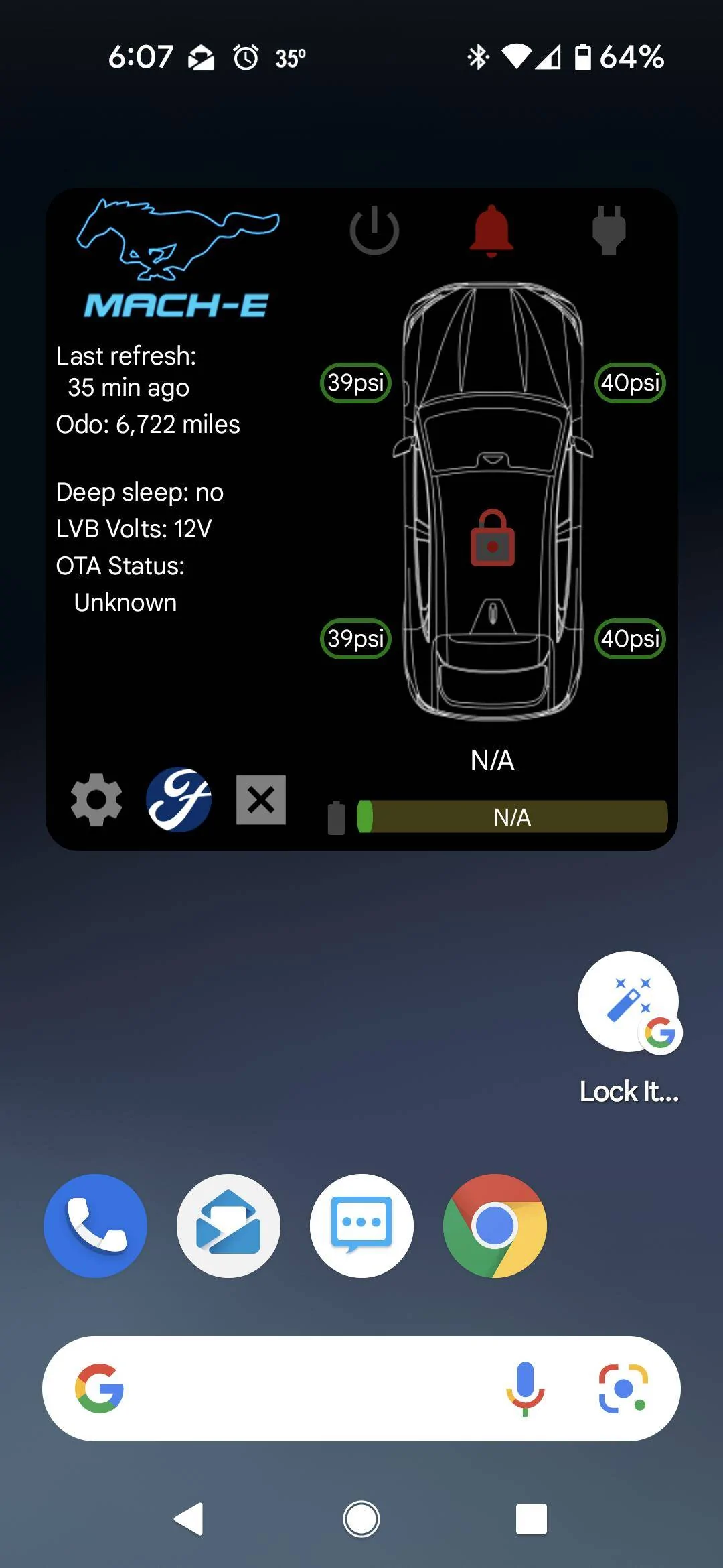

Just installed. Pixel 4a, Android 12. I can read the notes after install. Put up widget, I see status except battery and OTA. Cannot do anything with widget except open settings, and clicking on app just gets me into app info, can't get back to notes or 3 dots.
Press anywhere on an open section on your phone screen for the wallpaper/widget menu and then click on WIDGETS. Locate the app in the widget menu and then select it to display on your chosen screen.
268
18,208
28,630
Have that. Shows air pressure. No battery status, no OTA status. Clicking on gear wheel only works sometimes.
I think the app itself keeps crashing.
If the app is crashing Android should display a message (at least it does for me). When you say "clicking on app just gets me into app info, can't get back to notes or 3 dots", what app info do you mean?

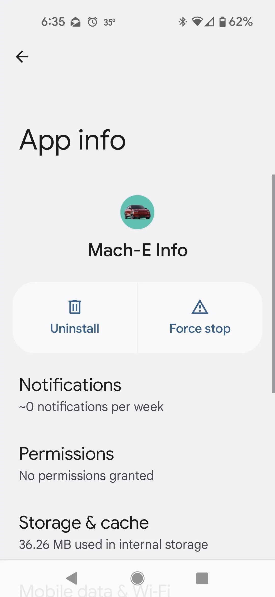

Mine looks the same. I can see the OTA status on the main page when clicking on the 3 dots.

When I click on app, this is only screen I can get to after initial install:
This is a new one.... that's Android's Settings screen. It's also weird that it's not showing an "Open" option next to "Uninstall" or "Force Stop"; maybe that's why you end up there when you try to open the app. I assume you're tried uninstalling and reinstalling?
Yes. Same result after first use. I can log in, put in VIN, read instructions, and install widget. Then can't get in again.
So I'm going to suggest you try doing the same steps I suggested in this post, but don't try to put the widget on your desktop (assuming that's what it causing the problem). If you can get back into the app without the widget being present, then you should be able to get log files I can look through.

Cannot get back in app after removing widget.
Phone is not rooted.
Rebooted phone after removing widget, still cannot get in app.
I can delete app, reinstall it, get in it before using widget, but wouldn't that erase log files?
If you delete/reinstall/get in before the widget, that would let me see if the app is working up to that point or whether there's something wrong right then. If it is, then the only choice is to get a logcat because as you say there won't be any want to recover the app's logs.

It is not the widget, same result with just the app. I'll pass for now, not worth the effort on my end or yours to figure out why it's not working on my phone.
