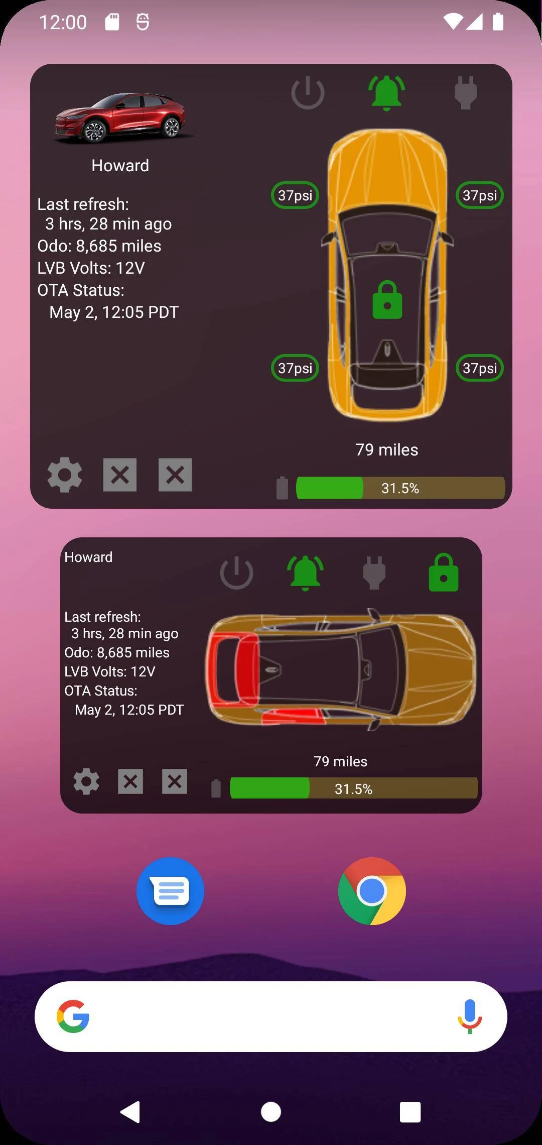

Here's a mock-up of a Cyber(ish) Orange, showing normal view (full-size) and when things are opened.
Ford Mustang Mach-E Android Widget for Mach-E [Less Complex] cyberorang
Also figured out how to assign colors programatically so that anyone could pick their own color.
Looks nice.
