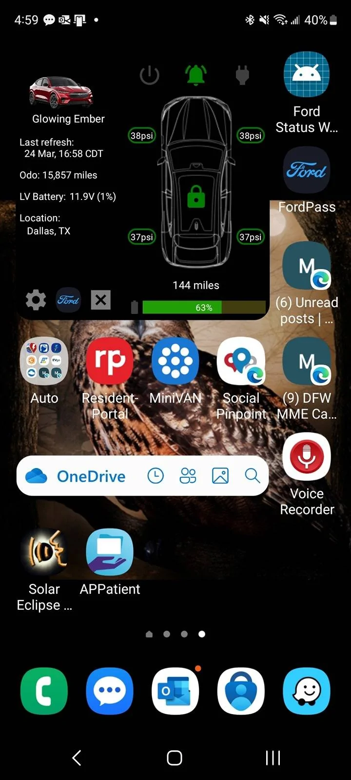

My 2022 GTPE has been at a dealer for over 3 weeks for the HVBJB recall. If the 12V battery info in this screenshot from the widget is correct, it looks like the dealer may have killed the life of the 12V battery (1%????)
Ford Mustang Mach-E Android Widget for Mach-E [Less Complex] Screenshot_20240324_165921_One UI Hom

The values reported are probably "correct" and (unfortunately) meaningless. I'd been meaning to post a question about this elsewhere on the forums; maybe @Mach-Lee has some insights.
My observations of the values reported from Ford's servers -- and confirmed with my OBDII reader -- is the LV battery voltage and SoC have no correlation. I've seen my battery at 14.9V and 51% SoC, and also 12.3V and 78% SoC. To quote the Chebacca Defense, "that does not make sense".
My guess is if you check the SoC on your Ford Account Dashboard it will show the same (1%), and your battery is probably OK (11.9V isn't great, but not completely dead). If the car is actually using this value to figure out when it's OK to deploy an OTA update, God help us all.

Normal, voltage varies depending on many factors including whether or not the charging system was switched on at the last update. Voltage and SoC are not the same thing. See 12V Battery FAQ "Can I determine the SoC based on the voltage?" and the one below it.
