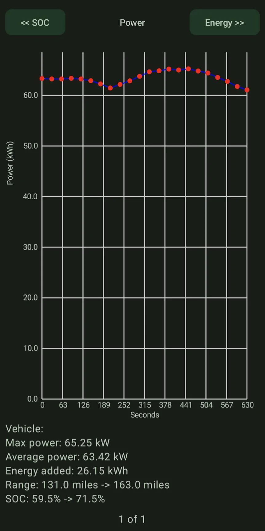

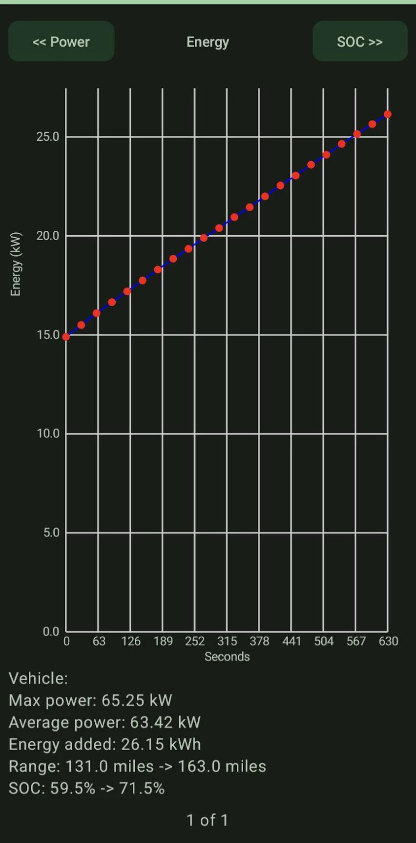

good timing for me on this! i had to charge on my way home on a trip today and it worked great. updated every 15s or so - didn't really track it but it was frequent enough for my needs.
the DCFC charts look pretty good too:
Ford Mustang Mach-E Android Widget for Mach-E [Less Complex] EZjI97j1n7wGrB6fURjw=w862-h1724-s-no-gm?authuser=0
Ford Mustang Mach-E Android Widget for Mach-E [Less Complex] 69A2ROpeBVT_zbvImTdF=w852-h1724-s-no-gm?authuser=0
i didn't grab the SoC chart. the charging session kinda sucked (EA signet 150kW unit) but useful data to see - especially if a session goes even worse than this one.
the DCFC charts look pretty good too...
Once it sees you're charging it's supposed to automatically refresh every 30 seconds. But looks like it does actually work.... (for someone other than me. ?)
