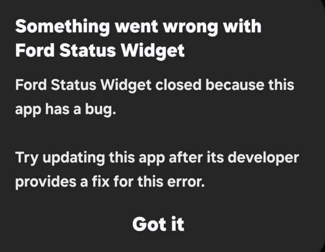

downloaded 2024.1.26 and upgraded from the prior - it crashed when i opened the main app and noted at the top of a logcat file:
Code:
01-25 16:17:06.184 11617 11717 E AndroidRuntime: FATAL EXCEPTION: Thread-4
01-25 16:17:06.184 11617 11717 E AndroidRuntime: Process: com.example.khughes.machewidget, PID: 11617
01-25 16:17:06.184 11617 11717 E AndroidRuntime: java.lang.IllegalStateException: Migration didn't properly handle: vehicle_info(com.example.khughes.machewidget.VehicleInfo).
i then uninstalled the prior version, installed the 2024.1.26 version, went through the login (appears to have worked) and then tried to add my mach-e and received the "Unable to retrieve vehicle status" toast with the following at the top of the log file:
Code:
01/25 16:20:02 D 934TXS: userId = f8a6dfa2-5a42-3ffa-b2db-28b5152829b9
01/25 16:20:02 D 934TXS: getting status for 0 vehicles
01/25 16:20:02 I 934TXS: getting status for VIN 3FMTK3SU8PMA28074
01/25 16:20:02 D OkHttp3: --> POST https://api.mps.ford.com/api/token/v2/cat-with-refresh-token
01/25 16:20:02 D OkHttp3: Content-Type: application/json
01/25 16:20:02 D OkHttp3: Content-Length: 849
01/25 16:20:02 D OkHttp3: Accept: */*
01/25 16:20:02 D OkHttp3: Accept-Language: en-us
01/25 16:20:02 D OkHttp3: User-Agent: FordPass/26 CFNetwork/1485 Darwin/23.1.0
01/25 16:20:02 D OkHttp3: Accept-Encoding: gzip, deflate, br
01/25 16:20:02 D OkHttp3: Application-Id: 71A3AD0A-CF46-4CCF-B473-FC7FE5BC4592
it generated a ton of json data in the log file that looks a lot like vehicle data that doesn't appear to have any errors until this at the very bottom:
Code:
{"updateTime":"2024-01-25T05:25:09Z","oemCorrelationId":"1979","value":273.0,"vehicleWheel":"FRONT_LEFT","wheelPlacardFront":268.89564}],"odometer":{"updateTime":"2024-01-25T05:25:09Z","oemCorrelationId":"1979","value":16828.0}},"oemData":{"vehicle_common_correlation_id":{"stringValue":"776043"}}},"message":"VehicleStatusUpdateCommandResponse with status SUCCESS","tags":{"tmcArrivalTimestamp":"2024-01-25T05:25:10.123Z"}}}}
01/25 16:21:55 D OkHttp3: <-- END HTTP (164160-byte body)
01/25 16:21:55 I 934TXS: status successful.
01/25 16:21:55 E 934TXS:     exception in NetworkCalls.getStatus:
    java.text.ParseException: Unparseable date: "2024-01-25T19:36:19.721Z"
at android.icu.text.DateFormat.parse(DateFormat.java:695)
at com.example.khughes.machewidget.NetworkCalls$Companion.getStatus(NetworkCalls.kt:882)
at com.example.khughes.machewidget.NetworkCalls$Companion.getStatus$lambda$3(NetworkCalls.kt:824)
at com.example.khughes.machewidget.NetworkCalls$Companion.$r8$lambda$XiJ676o5is1keVimuwJPt72kP-s(Unknown Source:0)
at com.example.khughes.machewidget.NetworkCalls$Companion$$ExternalSyntheticLambda0.run(Unknown Source:10)
at java.lang.Thread.run(Thread.java:1012)
this is getting into the weeds for the forum so happy to add to github if you'd like.
