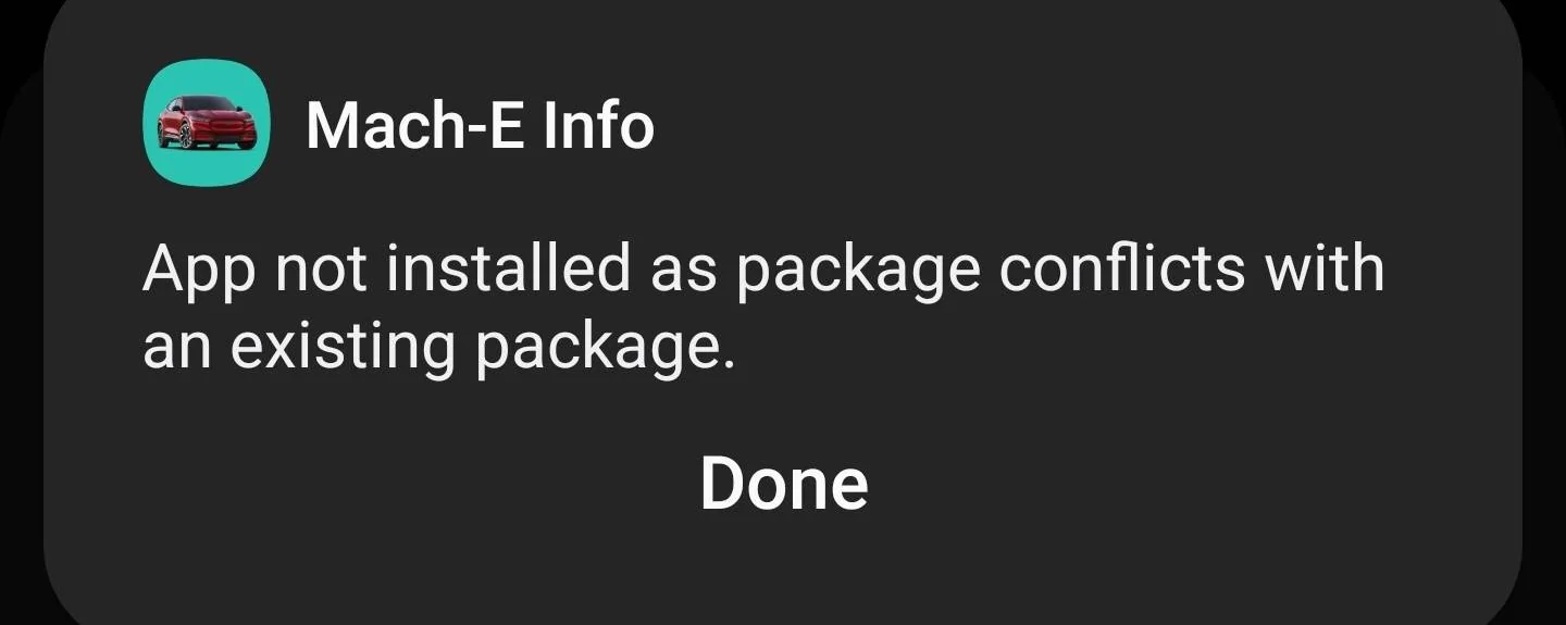

I got the new version notification. Downloaded the newer apk but it just gives me this.
Ford Mustang Mach-E Android Widget for Mach-E [Less Complex] Screenshot_20220208-105841_Package installer
I've only seen that when I'm testing unreleased versions.
You can get around it by uninstalling the current one, then installing the new APK.
That worked. This was the first time the update failed for me.
