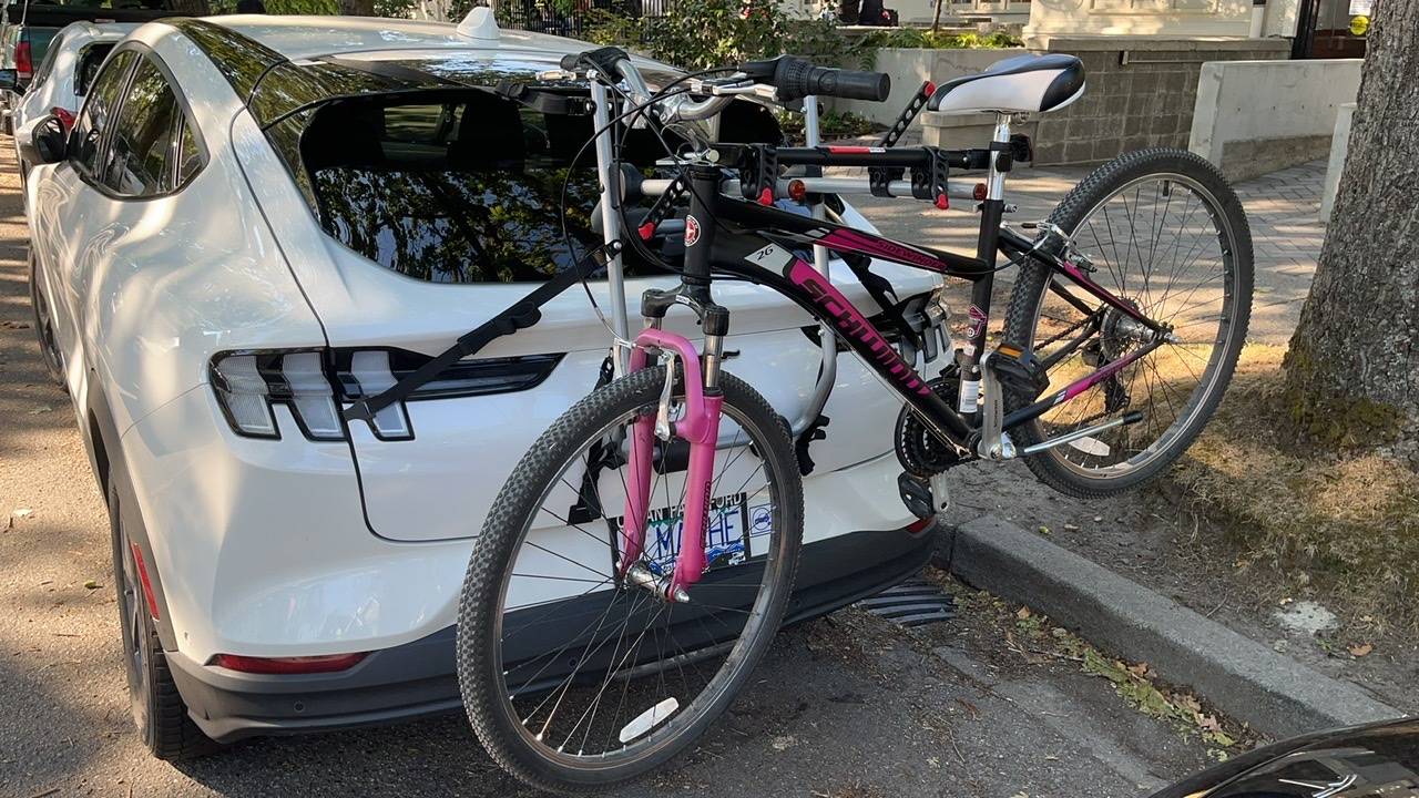

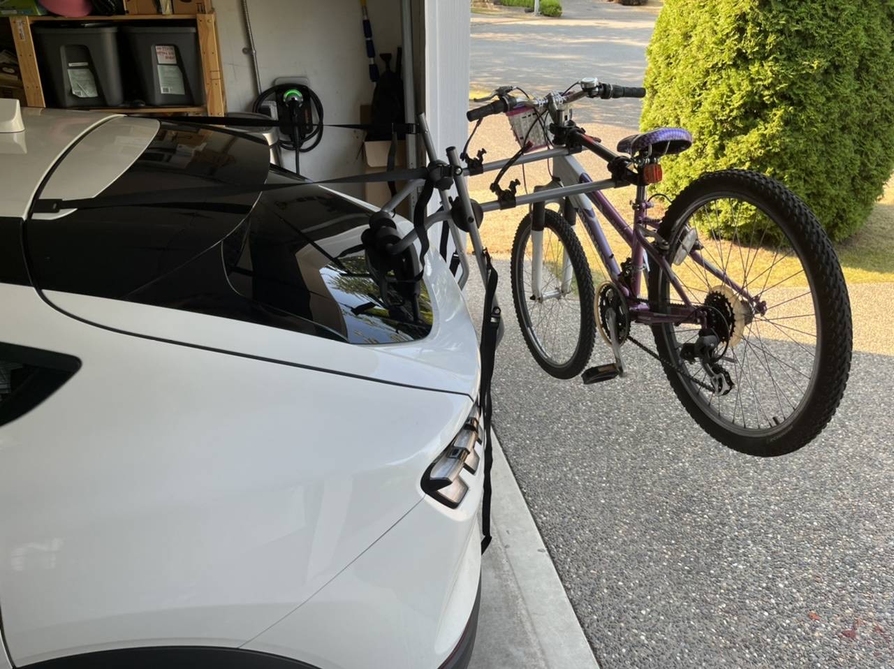

It looks good standing still, hit a couple speed bumps or a quick swerve to see where that rack ends up with three 35lbs bikes ($200) hanging off the back.
I have seen those straps stretch and fray if they have been exposed to UV over a period of time. There is no way that lower contact point is not going to get damaged either by dimpling the sheet metal or trapping dirt under the foam pads and scratching the paint.
The reason the racks are expensive is to 1) Protect the finish on your car 2) Prevent bikes flying off and killing someone behind you 3) Protect your bike.
I didn't say strap racks were a good idea.... but the OP wants a $100 rack for occasional use. I would absolutely avoid speed bumps, washboard rough roads, or high speed cornering... as well as being careful with total bike weight; I'd really hesitate putting more than 50# on.
My personal preference is the TorkLift hitch mount and 1up rack.... but that's a big investment for somebody who might use a bike rack once or twice a year.
The hitch mount I think is a great idea for anybody since the side benefit is rear tow loops for rescue in case your nose gets stuck in a ditch or snowbank.
