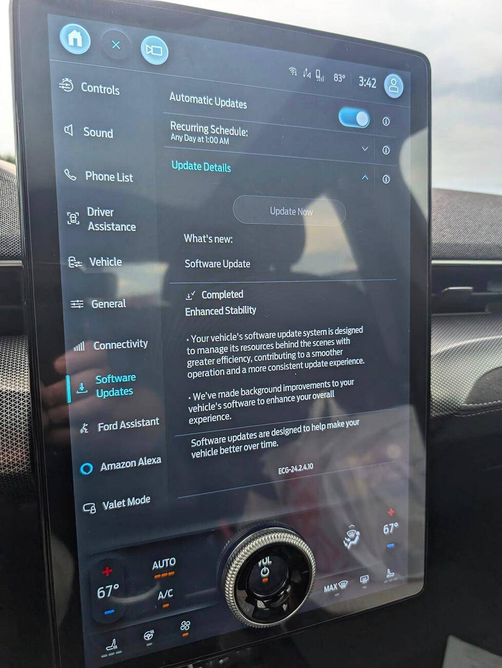

I saw on Facebook someone got ECG-24.2.4.10. That would likely be the OTA for this? Here is the screenshot that they had posted
Can't tell unless I get the VIN to look up the OTA details.
