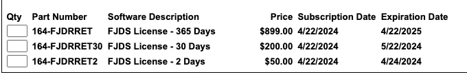

Sure. If you want to spend close to $1,000 for hardware and another $2,500 for an FDRS license (“weekend licenses are significantly less expensive”) to do work yourself that your dealer should be doing, then yep it’s that simple ?
The license is nowhere near $2,500.
Ford Mustang Mach-E Are FDRS updates that easy Screenshot 2024-04-22 at 3.03.47 PM
And the hardware was not close to $1,000. I spent $130 on the power supply and $450 on the adapter. I think the adapter is now $100 more.
So $580 for the hardware and looking back I have spent $500 total on licenses in the past 25 months.
A total of $1080 in my 25 months of ownership. $540 a year.
A lot of people spend that or more on their hobbies each year.
I see a lot of value in applying the updates myself. I never am waiting for an OTA. I get to use features much sooner than the average owner. For example, I have been driving around with BC 1.4 for months.
Sure it would be nice if the dealer would apply updates on demand but even if they did it for free there is still my lost time dealing with the dealer. It will take hours longer to deal with the dealer than to apply the updates myself.
I don't see me using FDRS as being any different than someone spending $1000's a year on golf.
