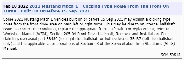

505
14,328
28,694
SSM 50513
Yep. I have that one. Looks like I'll get the halfshafts done when I get the glass work done.
I heard everyone talking about clunking sounds and all I get is clicking, so I had thought mine was something else. Funny thing is it really sounds more like a relay or small motor.
