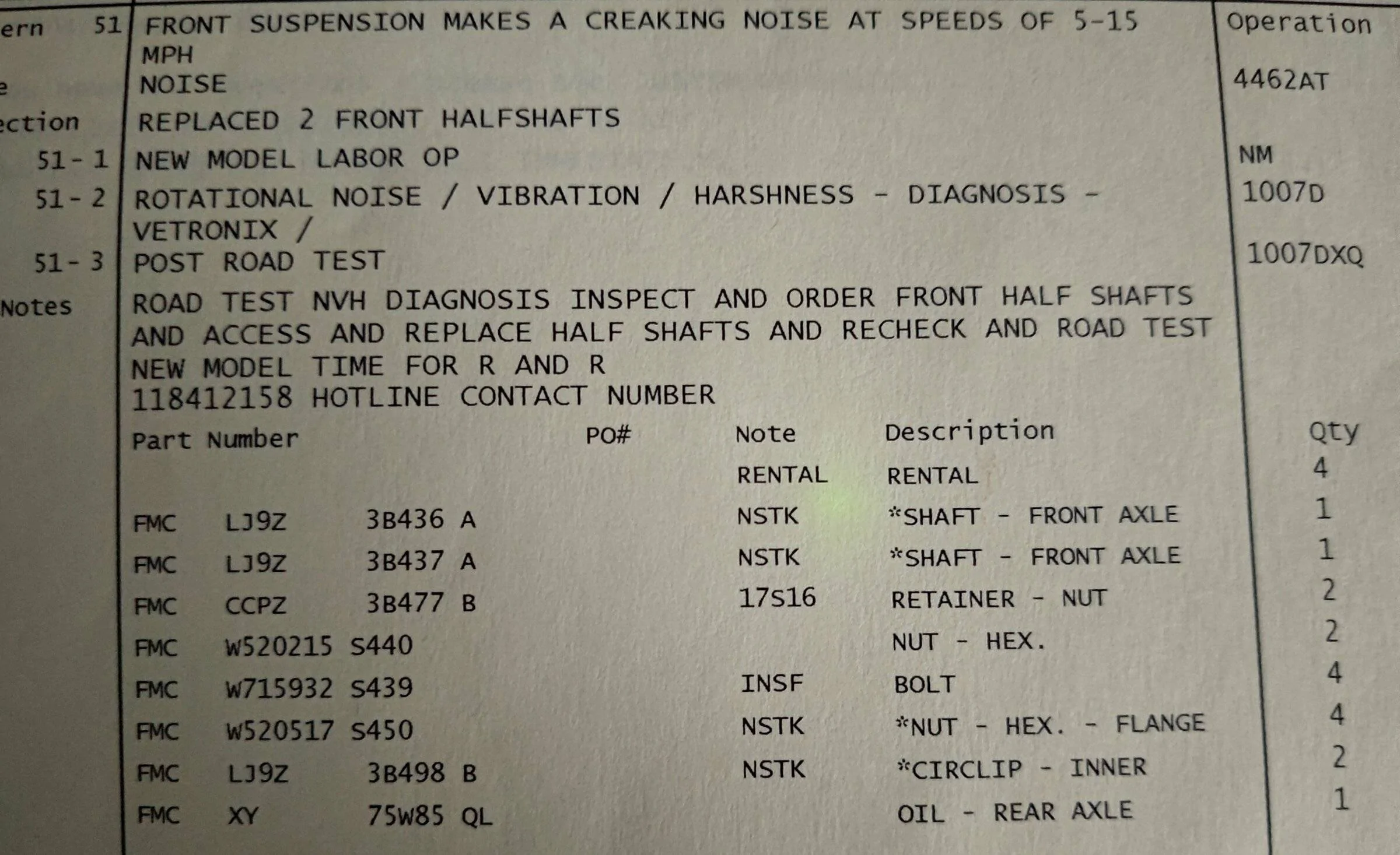

just kind of following up here, I have gone a while now with the replacements on both sides, and so far, no return of the clunk at all. There were places I could 100% replicate it through normal driving that it's not happening now.
I don't have the repair order handy (not at home at this second) but when I think of it and have a chance, I'll post a picture of the work. (The Ford site shows work was done but doesn't have a detailed work order.)

ok, I have the repair order handy - here's the relevant portion, showing both done in front with the part numbers, etc.:
They did the same thing on mine in early March for the same noise. At first they were only going to do the right side, but then decided that the noise was from both sides and replaced both.
I went away on vacation for a couple of weeks, so I didn't get to test it immediately. But in the past couple of days I tried it out and the noise it gone. I just hope it isn't a recurring issue.
