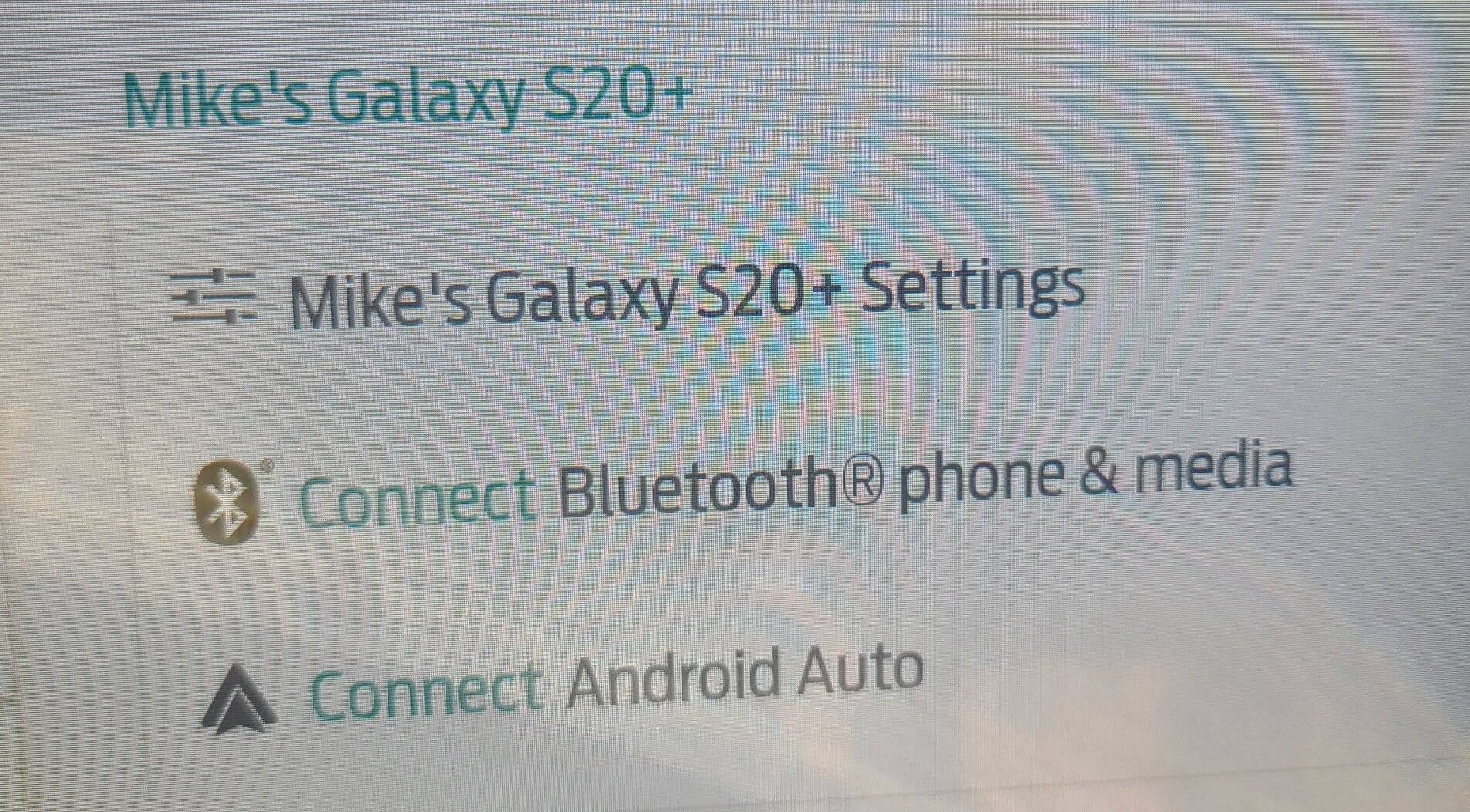

Left my Mach E sitting for the weekend and came back to a fun surprise... The Bluetooth connection is wonky at best.
I first noticed because wireless AA wouldn't work at all. Then I noticed that in the "paired phone" screen, all references to Bluetooth were gone. Only could see AA and carplay.
Ford Mustang Mach-E Bad Bluetooth Module? 20210823_164542

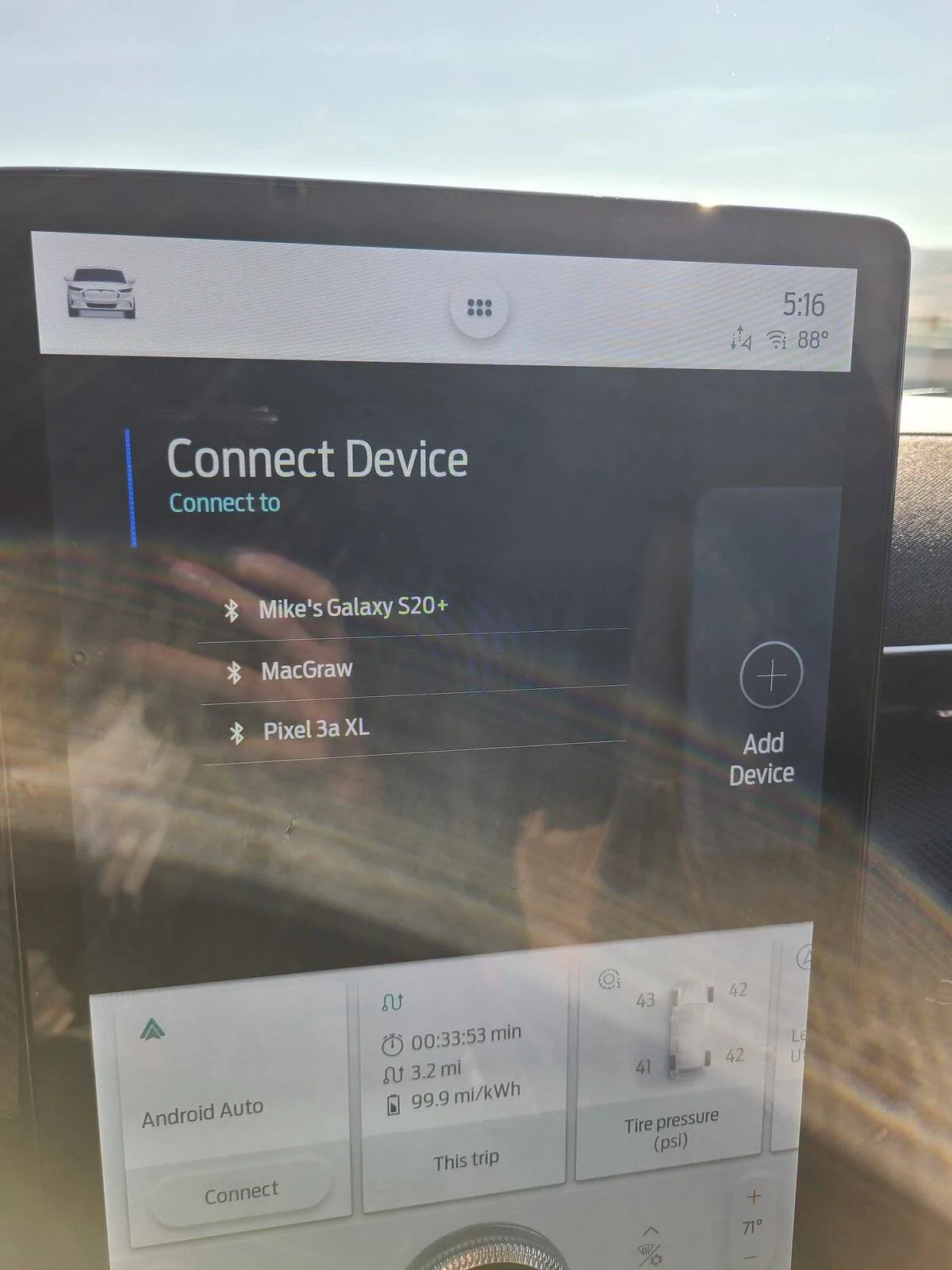

Here's what it normally shows
Ford Mustang Mach-E Bad Bluetooth Module? 20210823_170809
Additionally, the phone screen that usually shows this when not connected
Ford Mustang Mach-E Bad Bluetooth Module? 20210823_171646
Just showed up blank instead.
Then the system will just randomly start working again around 20 minutes into the drive. Regardless of rebooting the sync system.

Just an update on this. Just in case anyone else runs into this in 3 years and is frantically searching Google.
Turns out it was a bad APIM. Got a new one installed and all is well now ?
