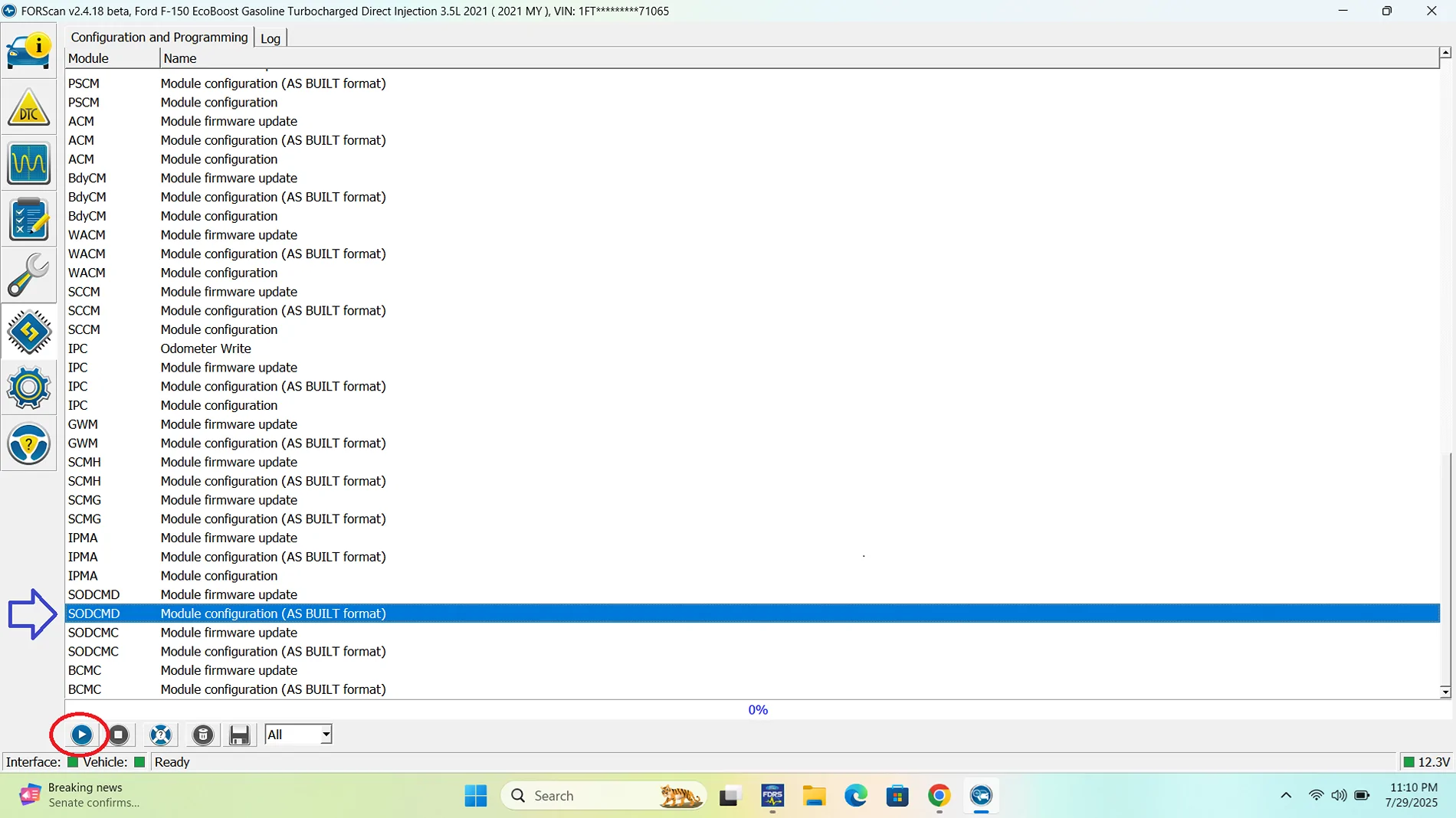

Plug in FORScan. When you open the session and it asks if you want to load the existing profile, select no so it does a fresh scan. Click the microchip button on the left, scroll down to SODCMB as-built format and click it to highlight as you see below, and click the "play" button on the bottom left (red circle).

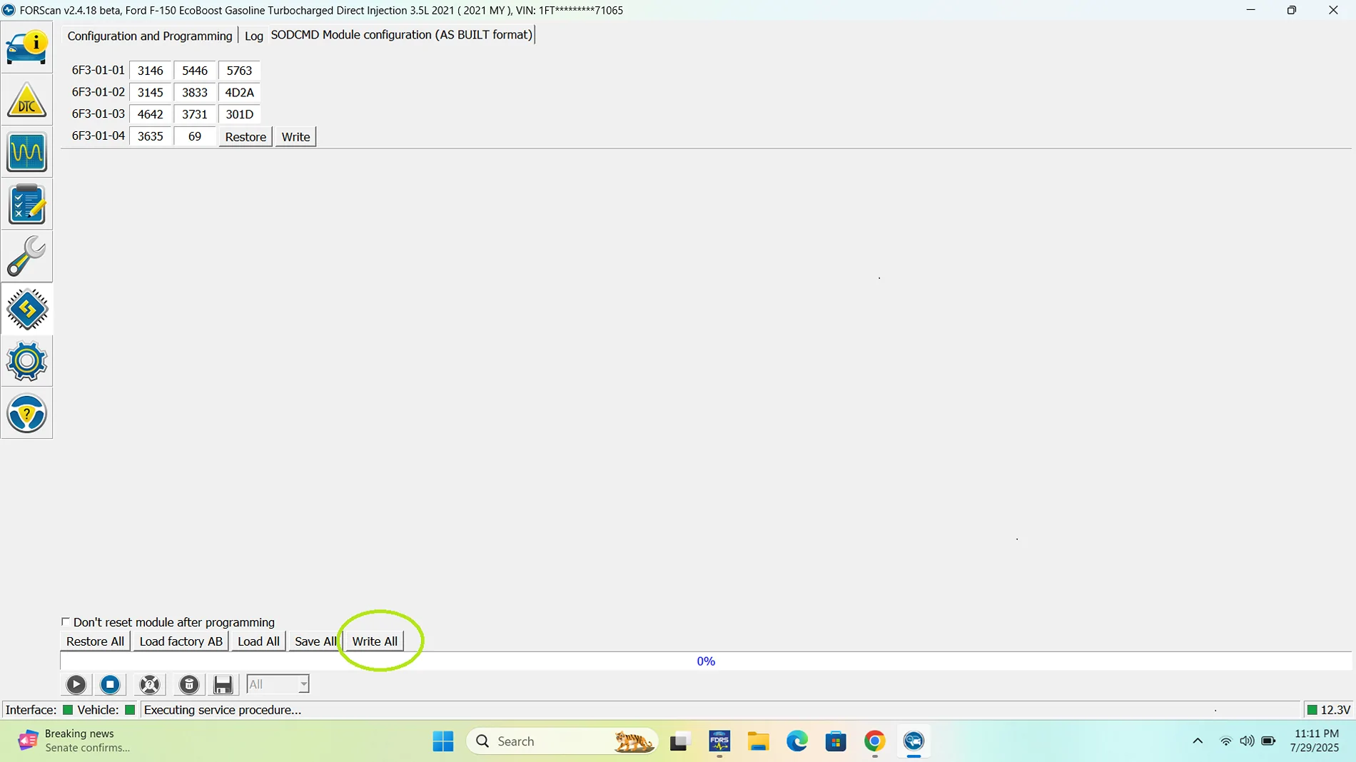

That will take you here. It may look different as this is from my F150 I plugged into to show you what to do. When you're here, all you have to do is click the "write all" button below (green circle). Follow the prompts to cycle ignition or what not. Once done, hit the stop button next to the play button you hit earlier.

Then click the DTC button on the upper left side of FORScan. Follow the steps to clear all codes. Road test the car again and see if lane change works. If it does, congrats and you're done. If it doesn't, then we go deeper into the dark side, or you can pay the dealer to program it instead.
