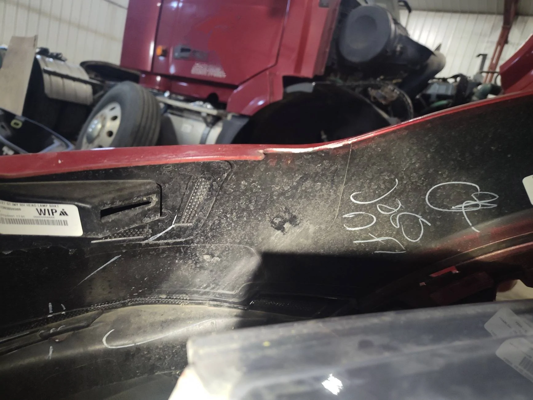

After getting the 1.3 blue cruise update, I tried the lane change feature and it worked a couple of times for a couple of days and then never worked since. Finally took into a dealer and they claim that we must have hit an animal or someone backed into us without our knowing and the front bumper gave enough and came back without any sign of damage, but yet enough to where the SODCMD module is damaged and the bracket bent. They want to replace both, I would love to get access to it to check this out, but I assume this is above my pay grade. Does anyone know if this could have happened with absolutely no sign of damage on the bumper? Thanks
I know you all have been sitting on the edge of your chairs waiting to find out what was wrong, ya right. Got the bumper cover off today thanks to the info from markboris and sure enough the mounting bracket and 2 mounting tabs on the module were broke. I'll try and add some pictures, but the only thing I can see is some paint missing for a couple inches on the inside edge of the bumper cover which you don't see when it is place. Couple months ago I hit a pheasant that just about went through the windshield, maybe he hit that corner first, no sign of anything on the outside, good paint!
Wow, I guess the pheasant must have hit that area first like you said. That is amazing it did all that damage without any visible sign from the outside of the bumper including the paint. Glad the photos I posted helped you out. ?

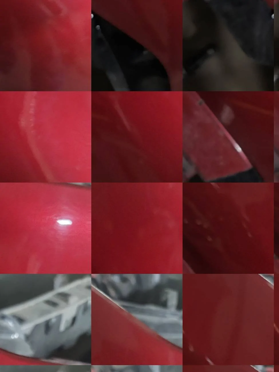

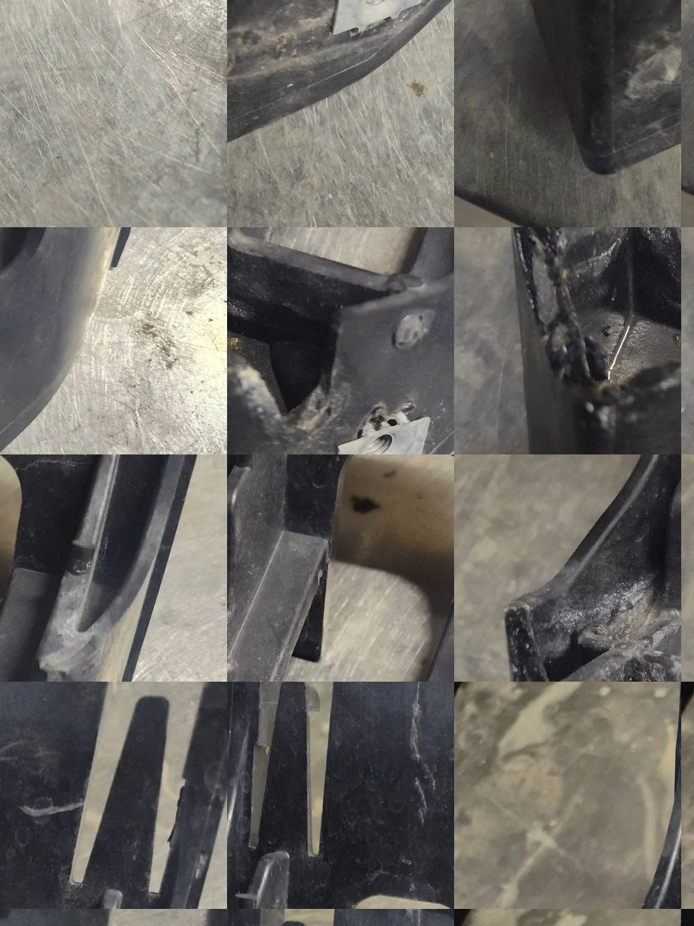

I mistakenly hit the insert all, full image when I had the other pictures ready to send and now each picture is 12 pictures, advice please.
Advice on what?
