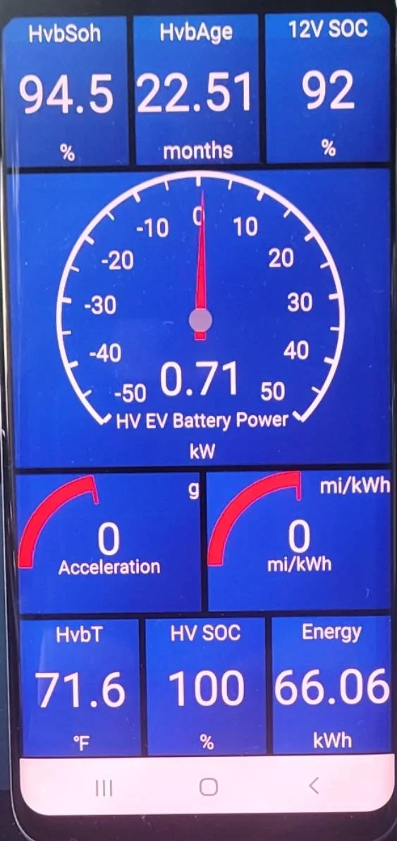

Here's what car scanner shows for the 2021 MME I recently picked up. Car has just under 40k miles on it.
Don't know how accurate this is, but it shows HVB SOH at 95.5%. Previous owner says they only DC fast charged one time. The rest of the time they used L1/L2 charging and kept it between 20-80% majority of the time with occasional charges to 100% for longer trips.

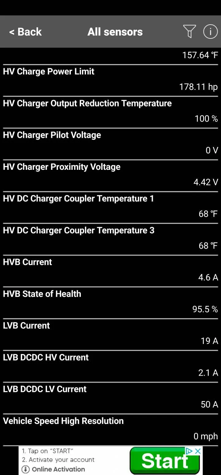

Mine was 95.5% with 70,000 miles and I DCFC 25% of my 23,000kWh of power bought.
