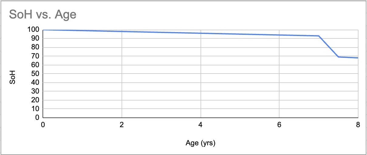

Let's keep in mind the reality.
In addition to Ford being the one that determines whether a battery meets the 70% threshold at 8 year / 100,000 miles or not, they also hold the reserve capacity in... reserve, for this very purpose.
7kW of the battery is not usable. In 7+ years, they see the trend is to say 68%. They realize another few kW, and viola, 71%.
I'd also point out that Darren Palmer has stated they expect to EXCEED the 70% number by a good margin.
