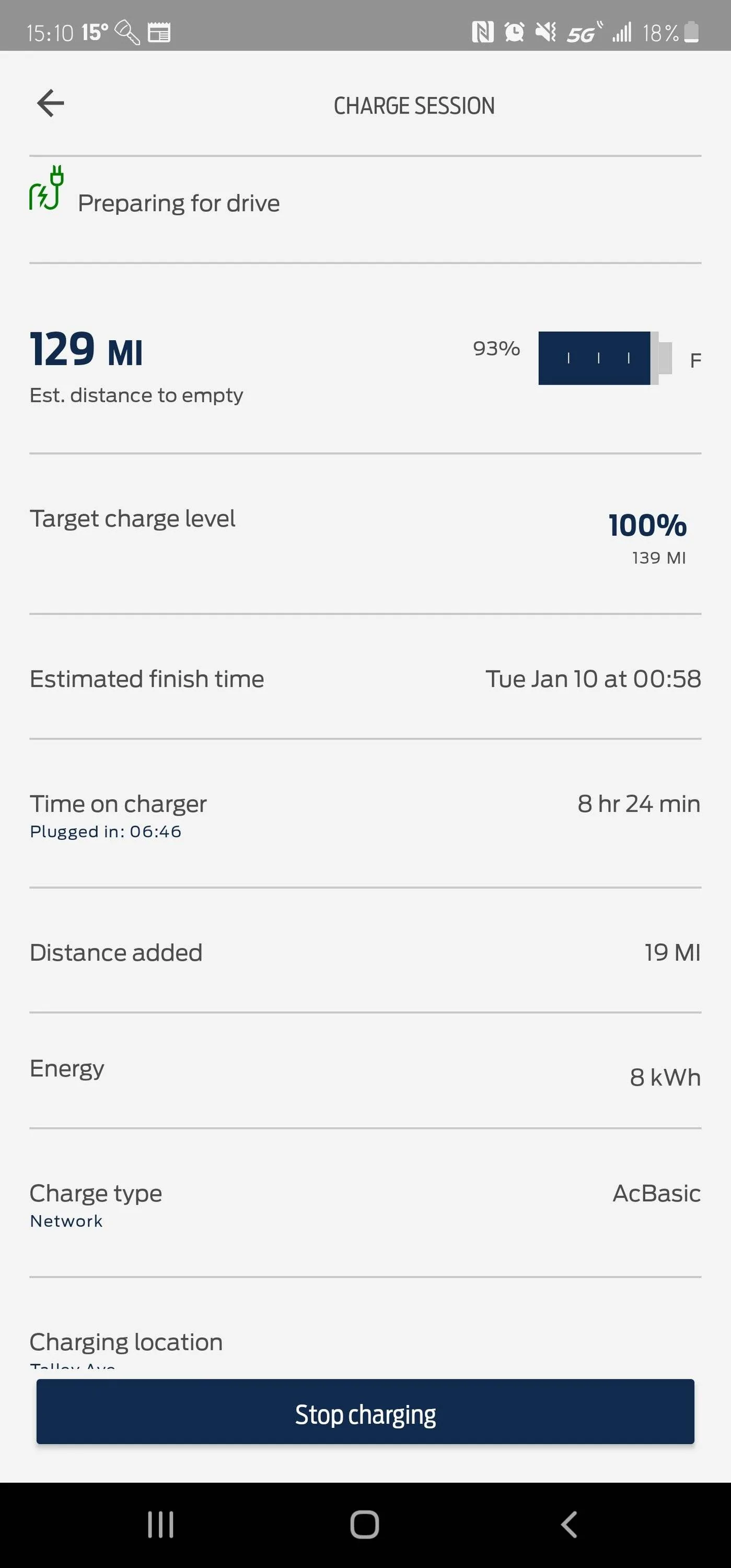

Quick update for anyone wondering about charging sub 20°F (was -3°F this morning, now 15°F) using only 120v wall outlet - and parked outside... and yes, my MME preconditions just fine.
Ford Mustang Mach-E Battery Health/Range Question Screenshot_20230109_151047_FordPass
