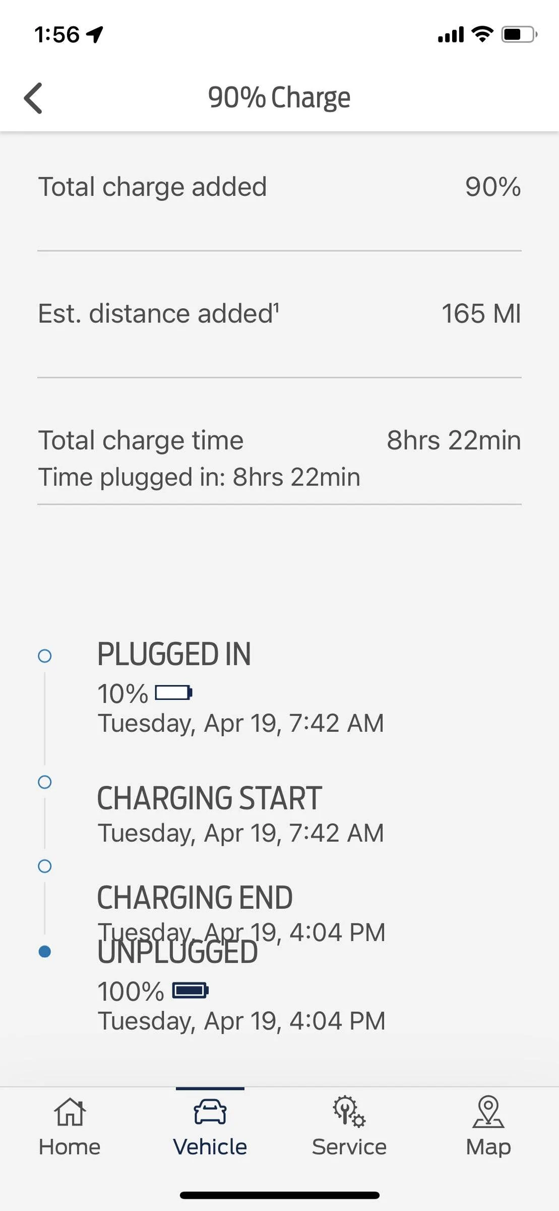

Is it okay to charge to 100%? Like does it really matter if we’re slow charging it to 100%? The reason I ask is I recall watching a video on YT, someone reviewed the Hummer EV, and they said that GM is confident that, with their battery, it doesn’t matter if the owner wants to charge past 80%. Has anyone been charging to 100% frequently? Why or why doesn’t it matter with Ford’s battery?
I have had my MME since Sep. 2021. I have 28,000 miles. I commute 150 miles per day. I charge to 100% everyday. At 100% my GOM indicates about 172 miles of range. So I basically fully charge and discharge my battery everyday. I have seen no degradation. I have waypoints where I check my batt %, and now that the weather is warming back up, the percentage is about the same as last year. I attribute the small difference to the change in the speed I drive. Last year i was driving at 80 MPH on the freeway and now I drive 85 MPH on the freeway.
I charge at work, so I am at 100% for only an hour or two before I start driving. I use a 9 KWH charger and it takes about 7-8 hours to charge everyday. I am usually around 12-15 % SOC when I start charging. But there have been many times throughout the winter where I was down to 5%.
I have noticed that once the car gets to 99%, the charge rate goes down to 1 KWH. That last 1 percent charge takes about 20-30 minutes.
My concern is the cooling fan, when charging at 9 KWH, the fan runs at high speed the whole day.
I hope Ford installed a durable fan motor.
When the battery is fully 100% charged, the first 1/2 mile or so, the regen does not work. I think it is because the BMS limits the charge rate to the battery to 1 KWH rate. Once I have driven about 3 miles, the regen is back to normal.
