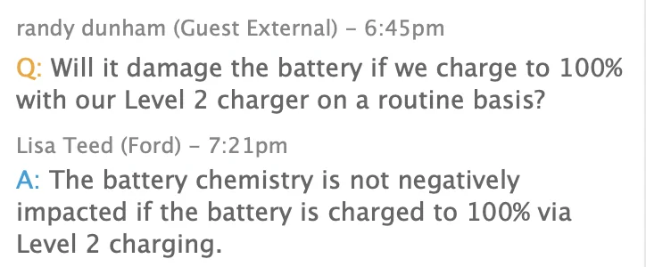

Ford doesn't seem to have decided completely on this:
So it seems their answer depends on L2 vs L3 charging.
That's pretty consistent with what we've heard in general. Not only is it a PITA to charge full-time on DCFC, it's bad for the battery to do it frequently.
But I expect few buyers are gonna do that anyway. If they don't have convenient L2 charging at home (or maybe work), a BEV is a pretty bad fit.
But it's good to see Ford say that L2 charging to 100% should be a non-issue. Lower power, less heat, little degradation.

And remember, because of the buffer, charging to "100%" is probably only charging to maybe "90%".

It would be interesting to see how that 11% buffer is allocated between top and bottom. I would kinda guess more of it would be at the bottom, since the charging curve taper (on DCFC) is already custom-tailored to protect the top end.
But I really have no idea.
