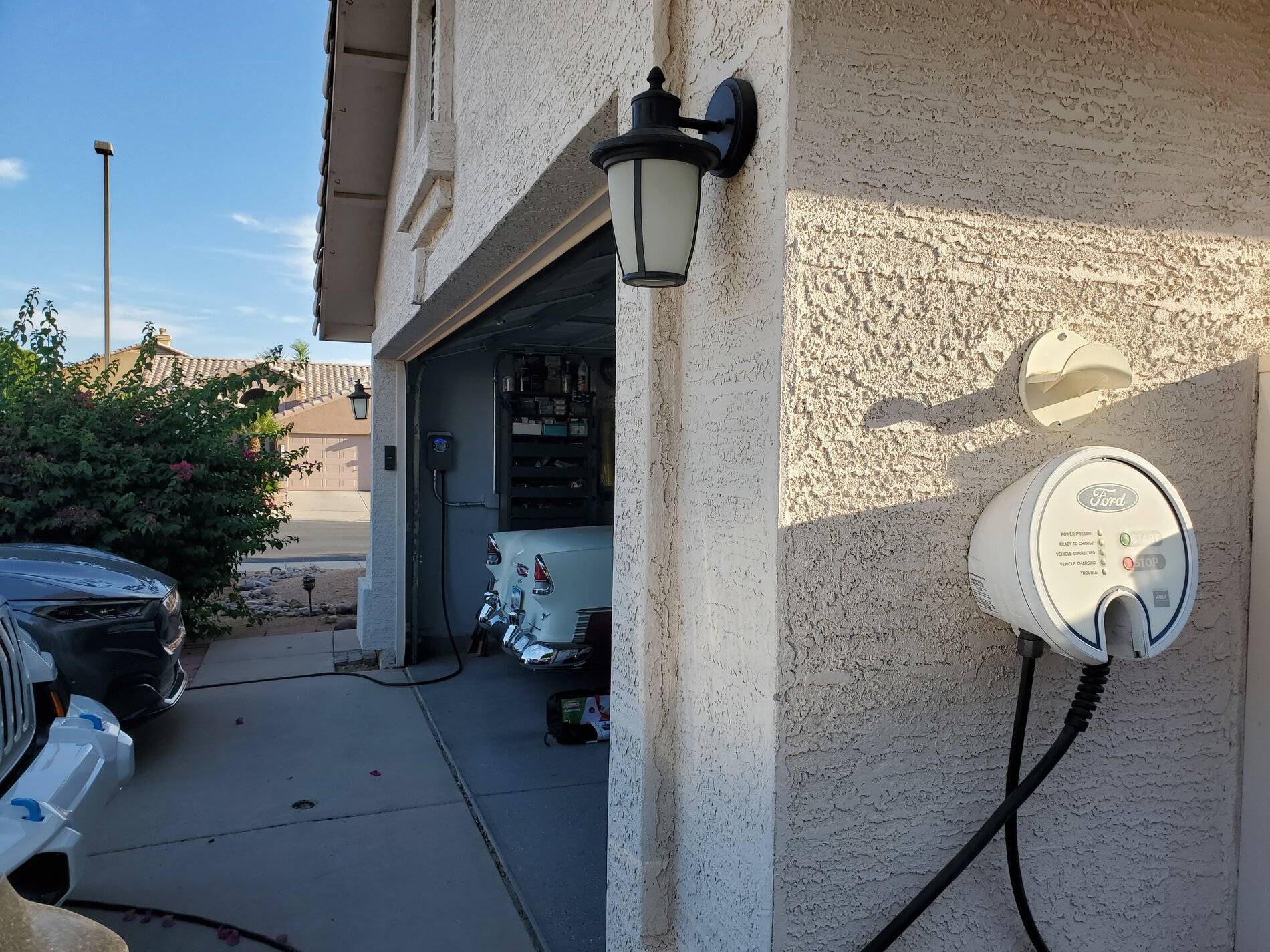

Here is a photo of my set up. I have two separate circuits, one for each plug. One unit outside, one inside. Both with pretty long cables. I end up using the exterior unit most times and we share between two cars. The interior machine hardly ever gets used because it isn't as convenient. (I park my EVs in the driveway vs the garage.)
I have two different units because the exterior station was installed several years ago and the interior station just a few months ago. If I had to do it again from scratch today, then I would buy two 48A units from JuiceBox or Wallbox and put them both on a single circuit and power share.
