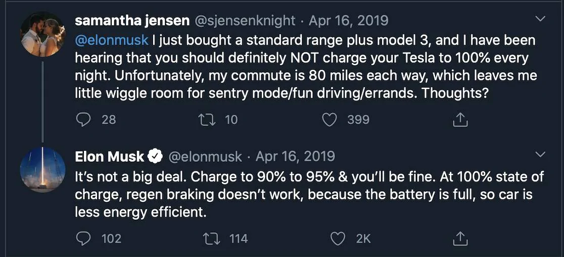

I like the way Tesla dumbs it down for its users. Daily drive setting, and road trip setting.
