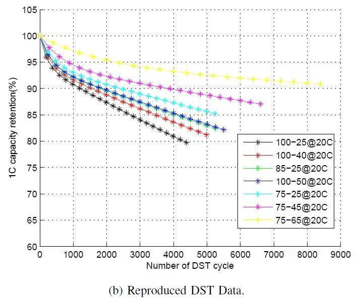

Why do you think that is idiotic? If you charge the battery to 100%, then the battery is probably charged at 95% (assuming the buffer is split between top and bottom).
95% is still unpleasant to Lithium batteries.
Ford Mustang Mach-E Best Practice for battery preservation 1602118338299
Clearly the more you stay in the middle the slower the degradation.

While I agree that staying in the middle is a little better, that chart is kind of deceiving on the surface. When you normalize each line for the same # of kWh (i.e. same # of miles), there's only slight difference.

Not sure I'm following you.
