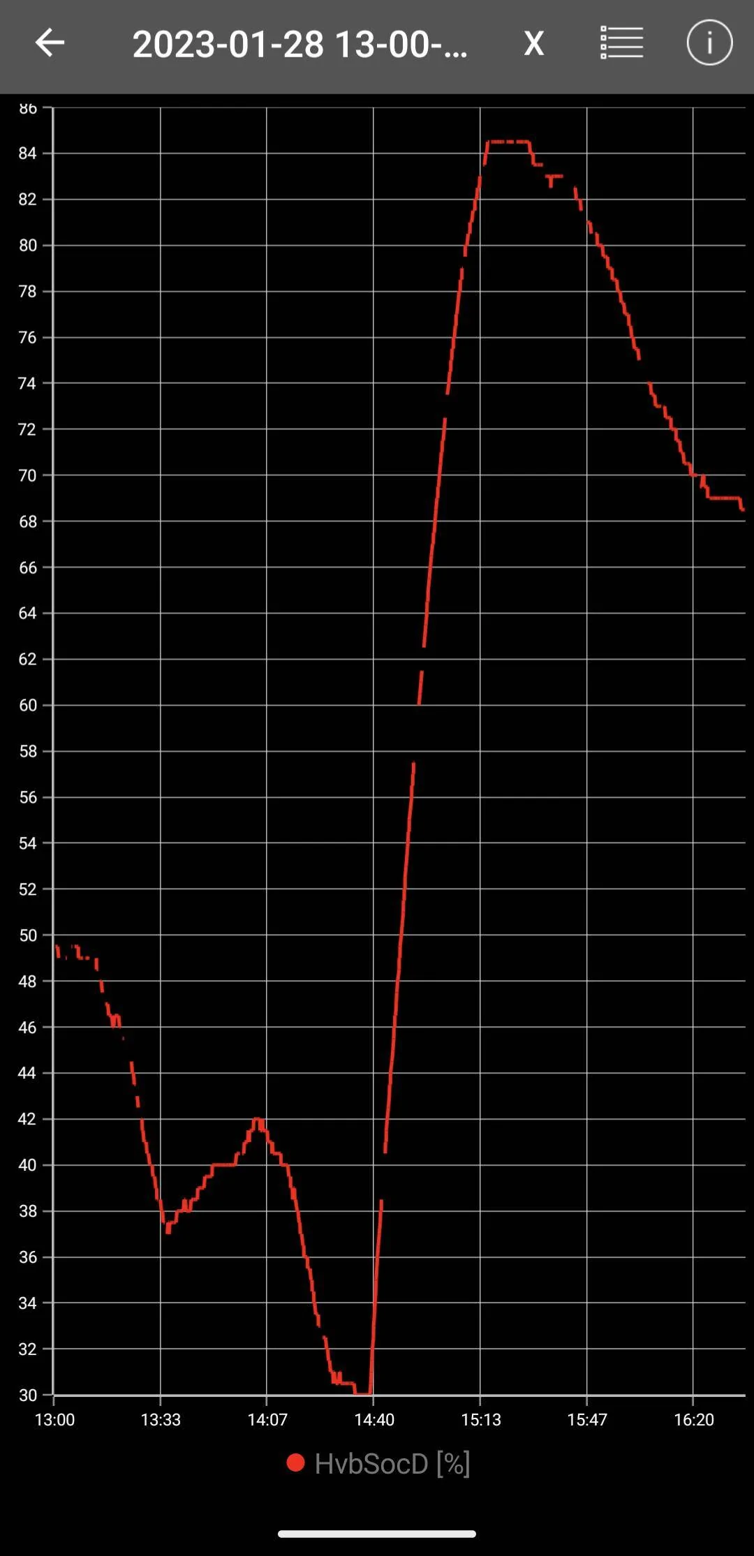

I don't recall timing my charge sessions before this one using CarScanner, but here's the data from when I used the Ford navigation to bring me to a charger.
I started with 30% charge (SOC Displayed) at just before 14:40.
I ended the charge session with 84.5% charge (SOC Displayed) just around 15:14.
So, about 55% added over about 34 minutes.
In the same time, the SOC (actual) went from about 31.5% to about 82%.
And from 27.5 kWh to empty to 76 kWh to empty.
I don't typically stress too much about time spent at a DCFC (this one was at a hiking trail, so we went for a little hike), so I don't know if this is "better" than what others experience.

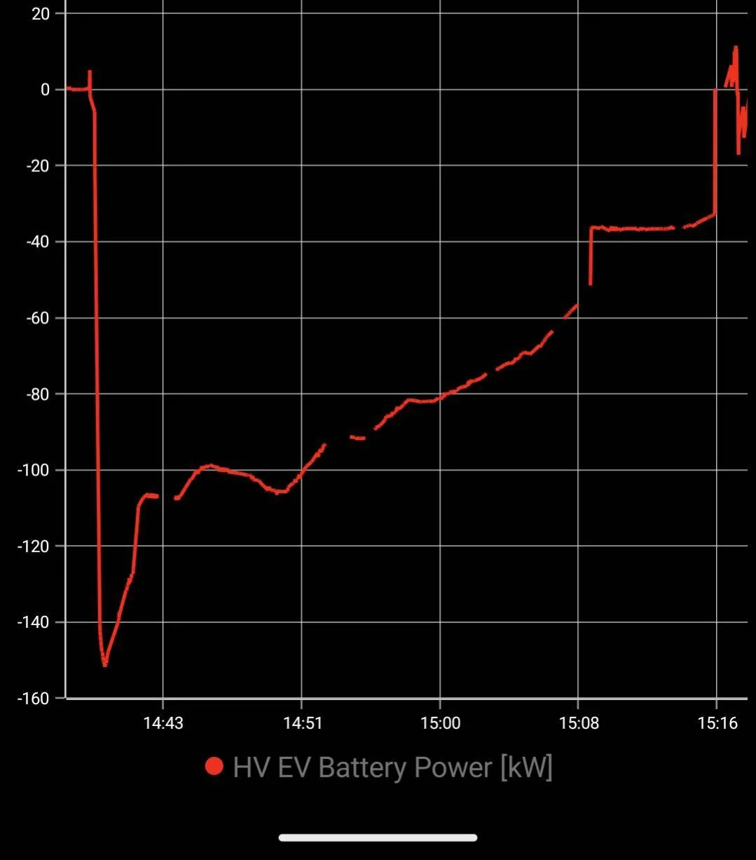

And here's the charge curve / power delivered to the battery during that charge. Note that if we had stopped at 80% (around 15:08), the "miles/minute" or "kWh/minute" average charge speed would have been quite a bit higher.
/shrug

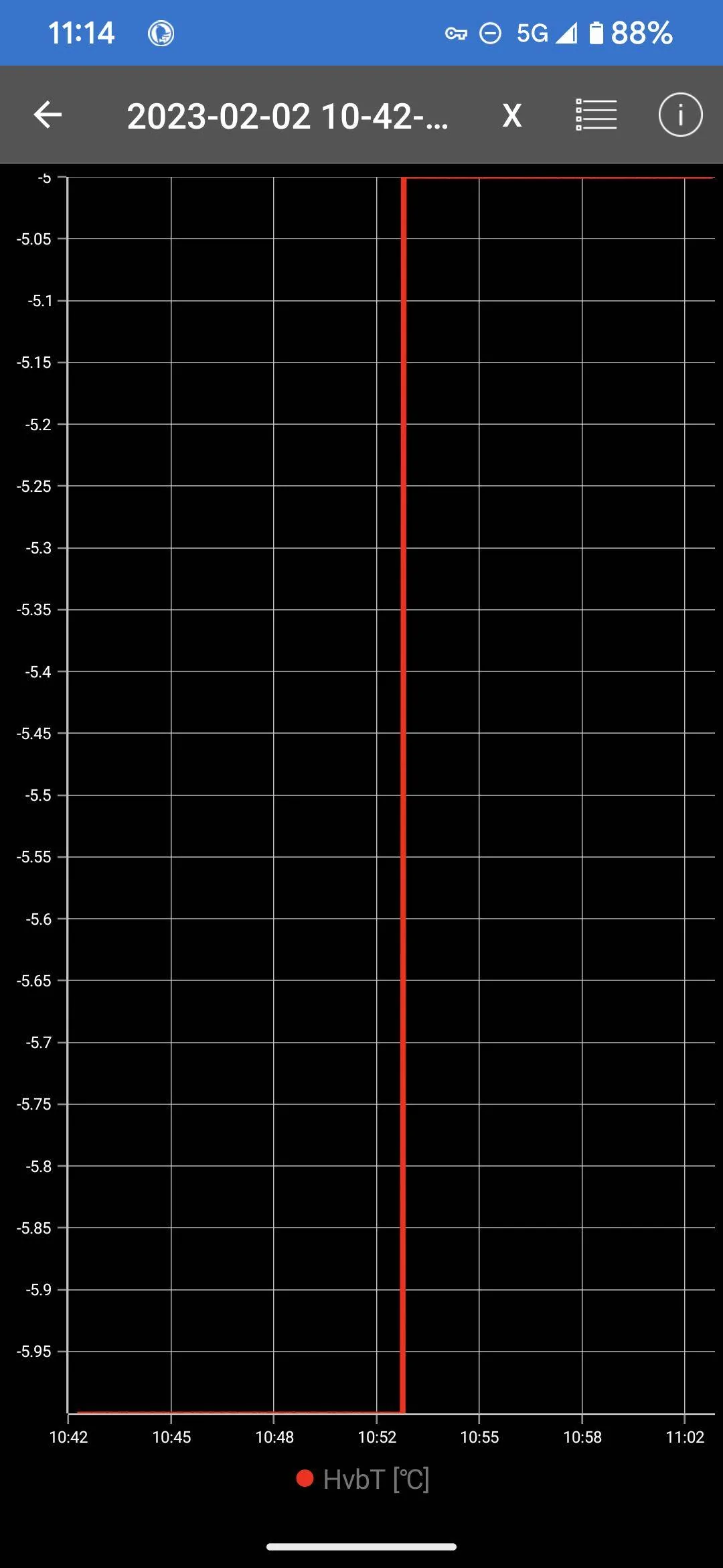

And this is what it looks like to go in the car and drive with no departure time, no destination, etc., for a 20 minute drive.
There was essentially no heating at all, just an increase of 1 degree from -6 to -5 degrees C over approximately the same time as my other tests. Maximum speed was about 55 mph.

Yup, it barely increases temperature while driving normally. Regen will warm it up maybe a couple degrees but that’s not great for it while cold.

What Power Ups have you received? It has finally gotten cold here and my car is heating the HVB (off plug) from low 20Fs to mid 30s as soon as it is started recently. 3.6.2 may have something to do with that.

Honestly, I haven't been paying attention to the Power Ups. I'm on the Early Access program, but haven't spent more than a few seconds looking at the notices. The car tells me I have 4.1.3. The app tells me I'm still missing an HVAC update.

Yeah. This is the trade-off I don't know if I would have signed off on.
No heating when running to the grocery store or whatever...They very nominally and very slightly increase range at the expense of battery life and then they increase battery life at the expense of charge rate at the DCFC and I wonder if this was the best trade. Especially given that a warmer battery is more efficient, heating the battery on these short trips probably wouldn't have decreased range enough to matter while preserving battery life enough that they could probably have saved 10 minutes on a 10-80% charge profile.
Of course, I don't have access to all of their data so I don't know if my guesstimate here is accurate.
