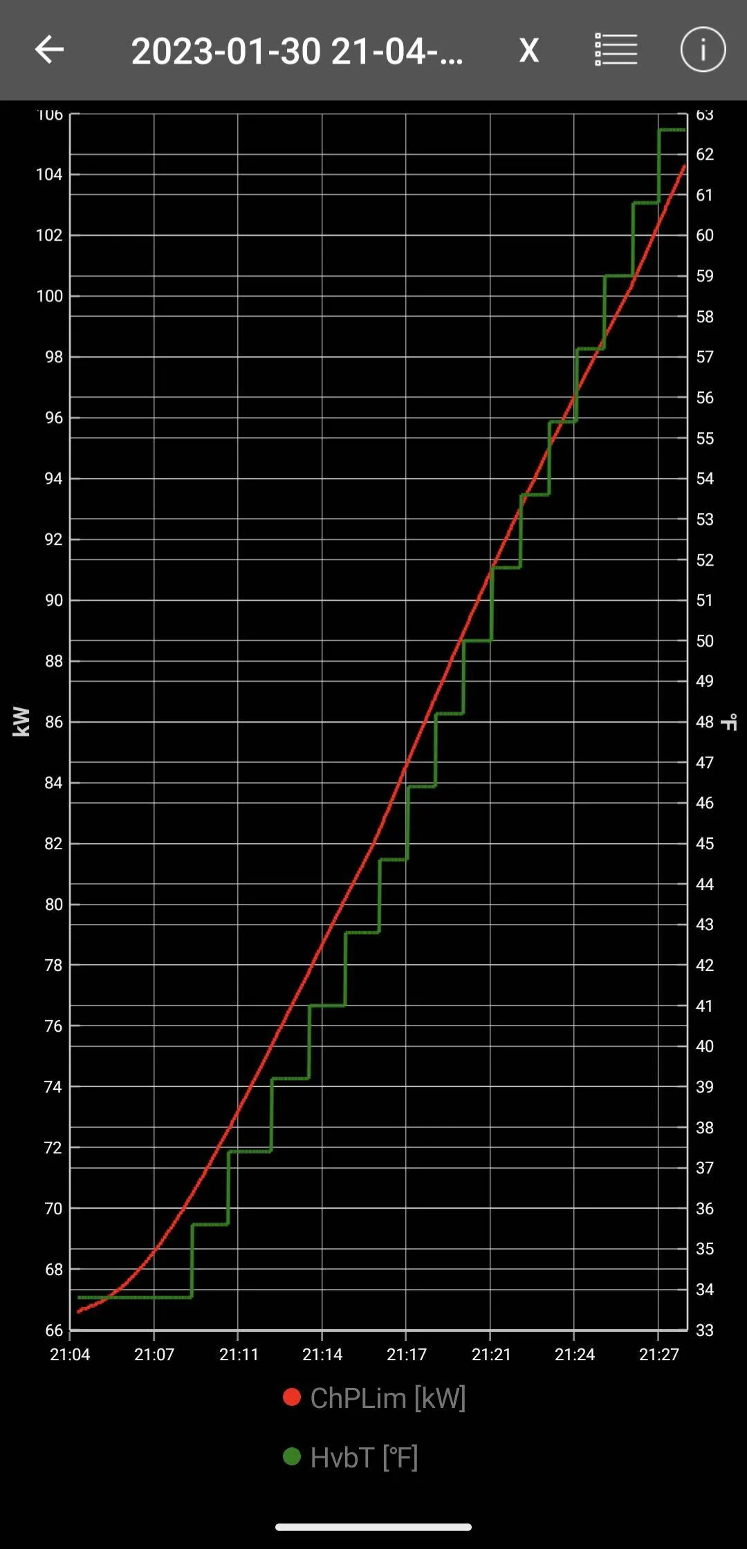

Oh I agree completely. I wasn't asking for range so much as battery health. @Mach-Lee mentions that dumping all the energy from regen braking into a cold battery is bad for it - and I know that my friend's tesla does not use near as much regen braking when his battery is cold.
So I was just thinking out loud about how to warm the battery after sitting all day at work with no access to a charger. Especially on days like today when it's below zero (Fahrenheit) outside.
So, yes. This is ~25 minutes of the car unplugged, started, with a destination set.
Same kind of warming up we see with the car plugged in and a destination set (or not set according to the tests @Mach-Lee did). I did not test the Remote Start.
I did lose about 3% SOC during these 20 minutes. I think I would only use this method (of starting the car unplugged) if it was really, really cold and I expected some aggressive (downhill highway speeds) regen. Otherwise, I think I would just drive the car gently for the first 20-30 minutes.
Ford Mustang Mach-E Battery Preconditioning: Some measured data. Screenshot_20230130-213122

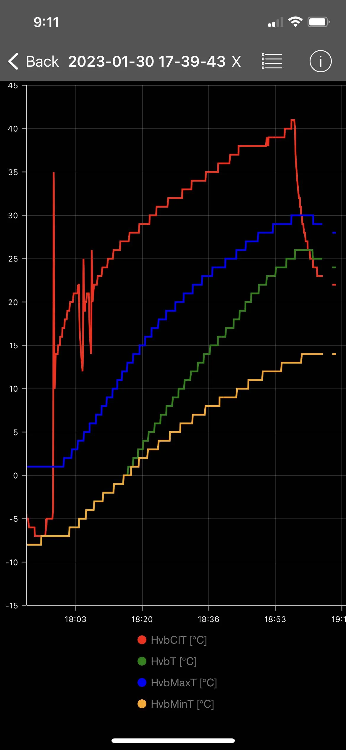

Here's teaser for my next write up. Hint: I was COLD... ?
Brr.
Our record low (according to my weather station--we've only been here for about four months) was -20 C a week or so ago.
Thanks for testing this. You're right, would not be worth doing all the time, just the really cold days.
