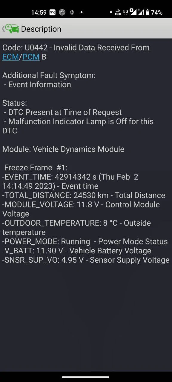

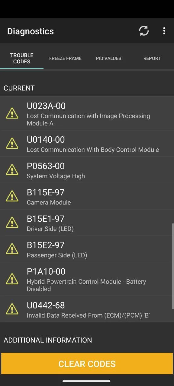

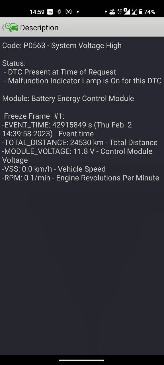

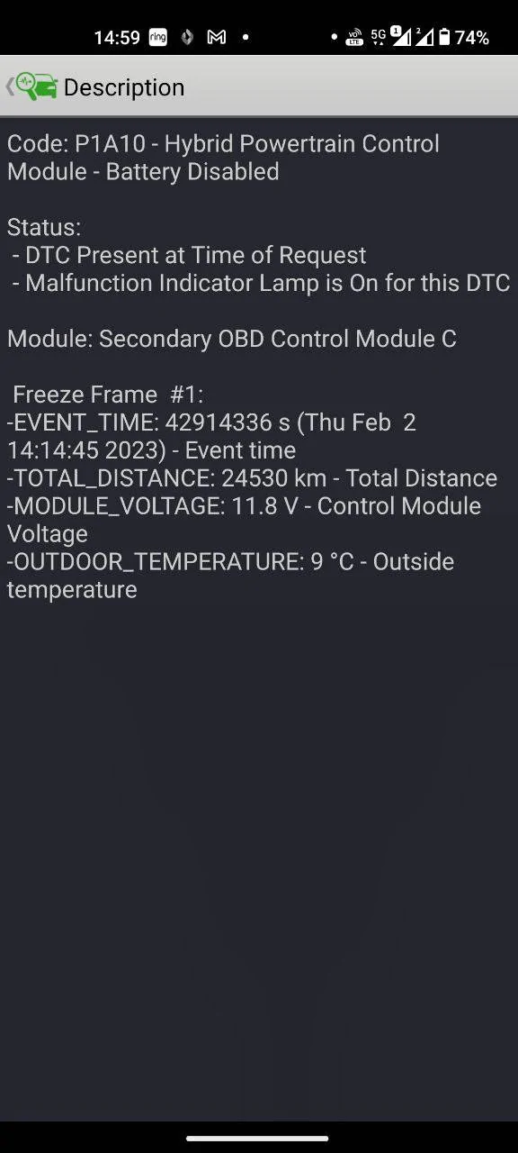

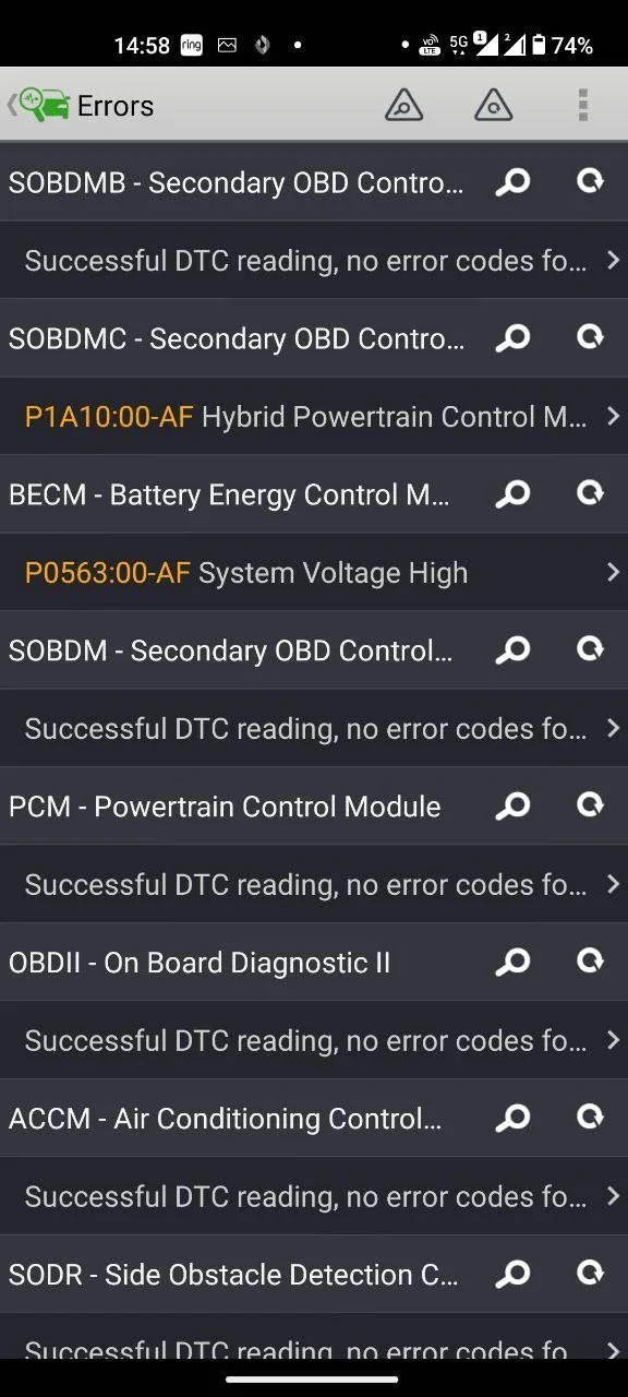

I did manage to screenshot a few diagnostics with Forscan before the car went to the dealership.
Based on this information it does look like the BCM is the problem, but i am also worried about the BECM message of "System voltage high"

P0563 qualifies you for a new HVBJB per TSB 23-2020.

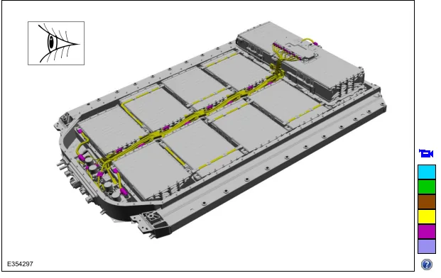

I was able to check with FDRS in the history what they exactly replaced. It is quite interesting to see.
The yellow wiring was replaced ...
Ford Mustang Mach-E Battery replacement on my GT Schermafbeelding 2023-04-03 205046
11,349
24,971
They replaced your HVBJB (LK98-10C666-AC).
