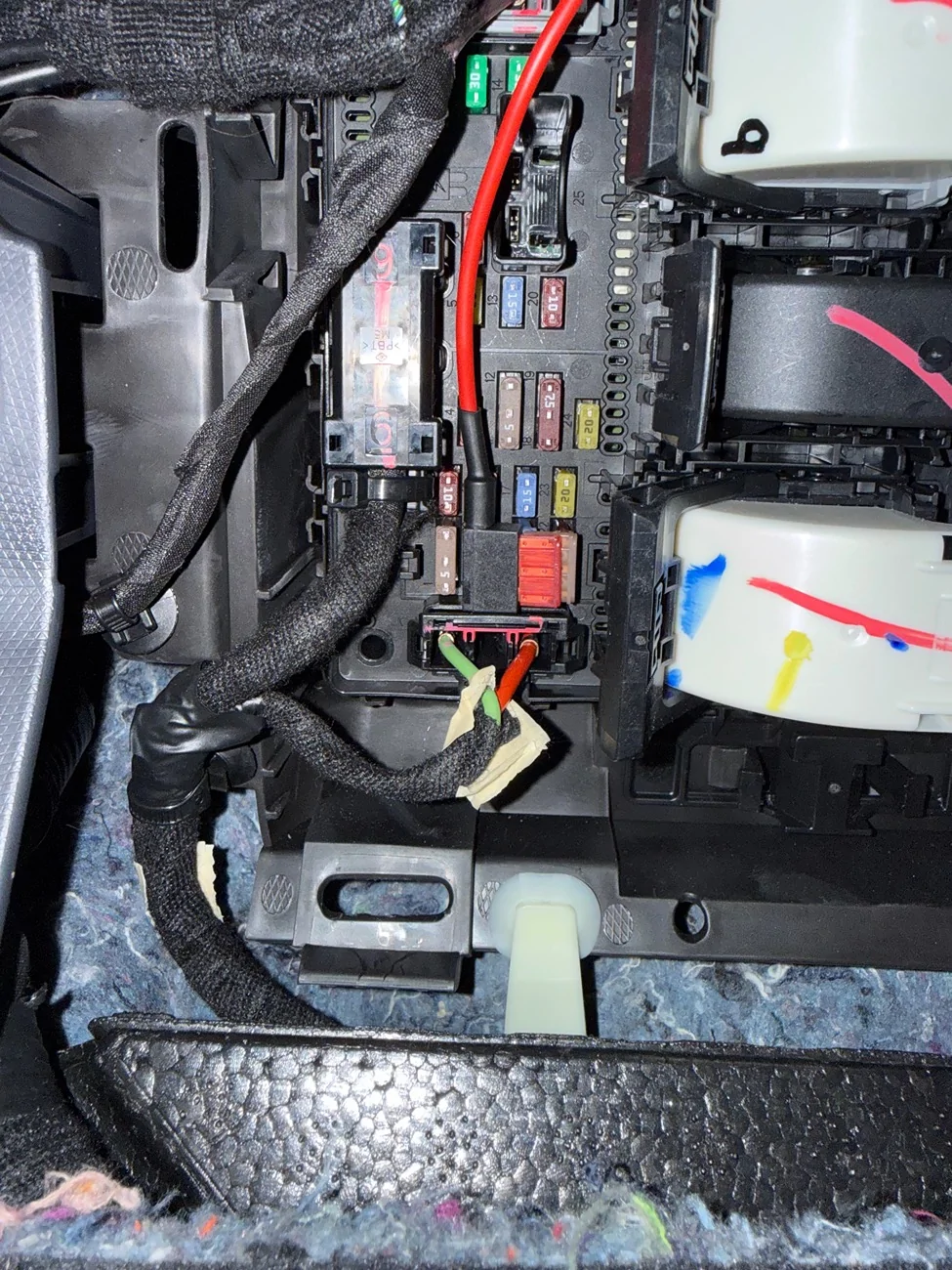

I used a fuse tap to a switched fuse in the passenger foot well, along with a battery pack under the passenger seat. This way I'm not pulling any power from the car's 12v battery when it is parked but the dash cam can still run in park mode.
What fuse did you tap for the ACC cable? I found a 2-prong one that is switched (fuse #3) but it will NOT power up the camera. Can't tell if I crimped the wire improperly, or if the tap is directional and I have to switch it up BUT - I can't turn this one around due to a big cable harness in the way
I don’t have the fuse panel schemati, but here is a picture of mine. Its the second from left on the bottom row.

Thanks, and UGH! I'm using that exact same micro3 fuse, in that exact orientation, and it won't effing work! Do you have constant wired as well or just ACC/switched? I assume you grounded to a nearby chassis bolt like me? Where did you get your micro3 tap and fuse from? (wondering if I have a bad tap from Amazon, bad fuse from auto parts store, or possibly a bad Viofo HK4 kit).
I'm just running ACC/switched as I have a dashcam battery installed under the passenger seat that only charges while the car is running, but then powers the camera when the car is shutoff. The battery provides the constant/switched to the dashcam for parking mode.

OK thx. Where did you get your micro3 tap and fuse from?

I also have a Viofo A229 Pro and have it hardwired into the fuse panel in front of the passenger foot well. Never had any issues.
Note: one oddity, I also have it tapped into a separate unswitched fuse for parking mode, so have both switched and unswitched power taps. The switched powers it up at start, and the unswitched takes over when car is 'off'. But I don't need or want dash cam footage of the inside of my garage so I used to reach up and turn off the dash cam using the camera's buttons. After a few instances of getting in my car and finding the camera still recording in parking mode after having turned it off, I decided to put in a kill switch inline with the unswitched power wire. This positively shuts off power to the camera with the car parked and off. Not sure how the power circuit is controlled inside the camera but clearly it's not perfect. You can avoid all that by simply not wiring it up for parking mode.
Do you happen to know if it's *MANDATORY* to have both the ACC and Constant wires tapped at the same time? Or can I use only the ACC wire? (The camera doesn't seem to power on with only ACC connected, not sure if that's a faulty wire or if it just won't work unless all wires are installed)
