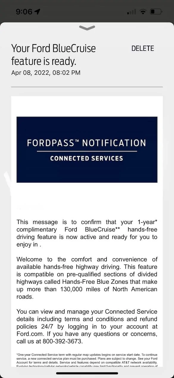

actually, it sounds like he is in the boat I was this week: dealer did lots of updates, but only got him/her to 2.5.1. If you don’t have 2.5.2, and haven’t received the FordPass notification, you’ll get the BlueCruise wording on adaptive cruise control, but it won’t turn on hands free yet.

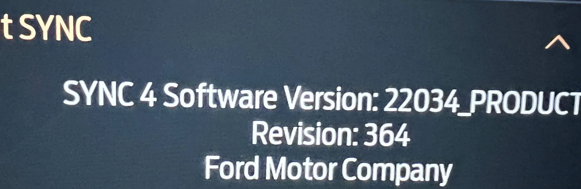

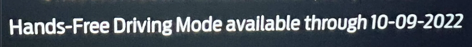

How to check if I have 2.5.1 in my MME? Will this show in main screen? Should I go back to dealer for 2.5.2?
The answer is posted in a few places and there are already too many threads about BC answering the same questions.
But since it's Monday and I am in a good mood, look for the following in the sync settings.
From the dealer instructions by Ford:
Testing BlueCruise to confirm
• Ensure BlueCruise is fully installed and activated by going to SYNC and selecting Adaptive Cruise Control. Ensure Adaptive Cruise Control is turned ON and Lane Centering with Hands-Free is switched ON.
• Ensure availability of BlueCruise operation by going to SYNC and selecting General, then Settings, then About. Ensure the “Hands-Free Driving Mode available” shows a date in the future
See pictures.

I received 2.5.2 OTA the next day, then Bluecruise came online for me the day after that.
