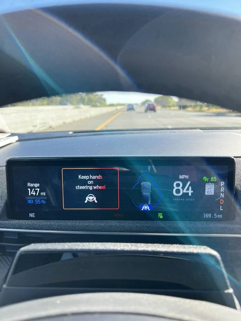

I get the notice that I'm in blue cruise but the screen stays white and says keep hands on wheel, which seems like the original cruise. I also wish the BC would not "bounce" back and forth in the lane, I actually leave my hand on during BC now because it is annoying and passengers don't like the feeling.

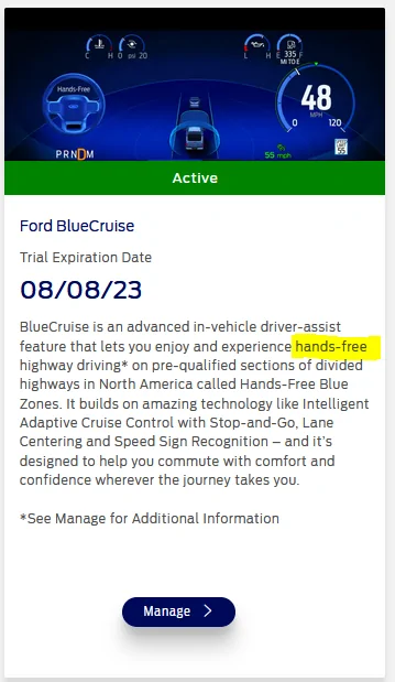

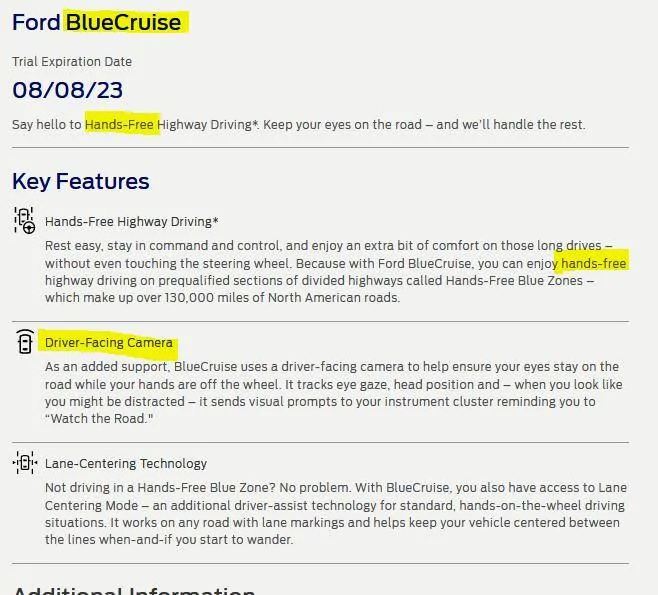

Really? The Ford.com description says it is hand-free. Even goes on to say it builds on Intelligent Adaptive Cruise Control, Lane Centering, Stop and Go and Speed sign recognition yet stops short of calling that technology BlueCruise.
My brother's Select has ACC and LKA/LC but no eye nanny camera. Does he have BlueCruise? I would say not. ???

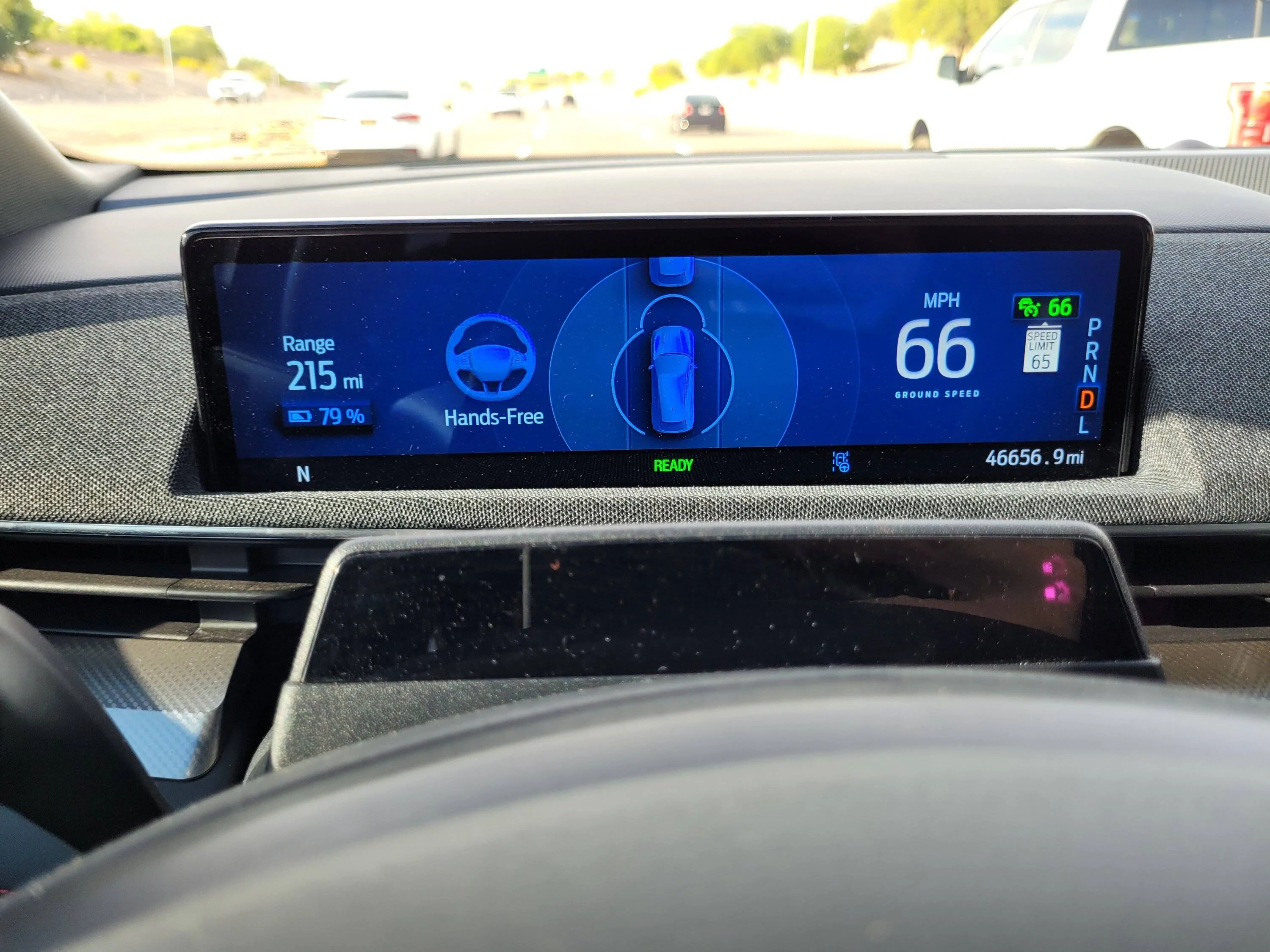

Ford Mustang Mach-E BlueCruise - "Keep hands on steering wheel" 1659997557833

Yes, I have BC on my vehicle (we just picked up the car last week). Heres a better photo showing the BC engaged.
No. You don’t have BlueCruise Handsfree engaged:
  • Notice how the IP isn’t shaded blue
  • You’re going over 80 MPH. BlueCruise Handsfree does not work over 80 MPH
