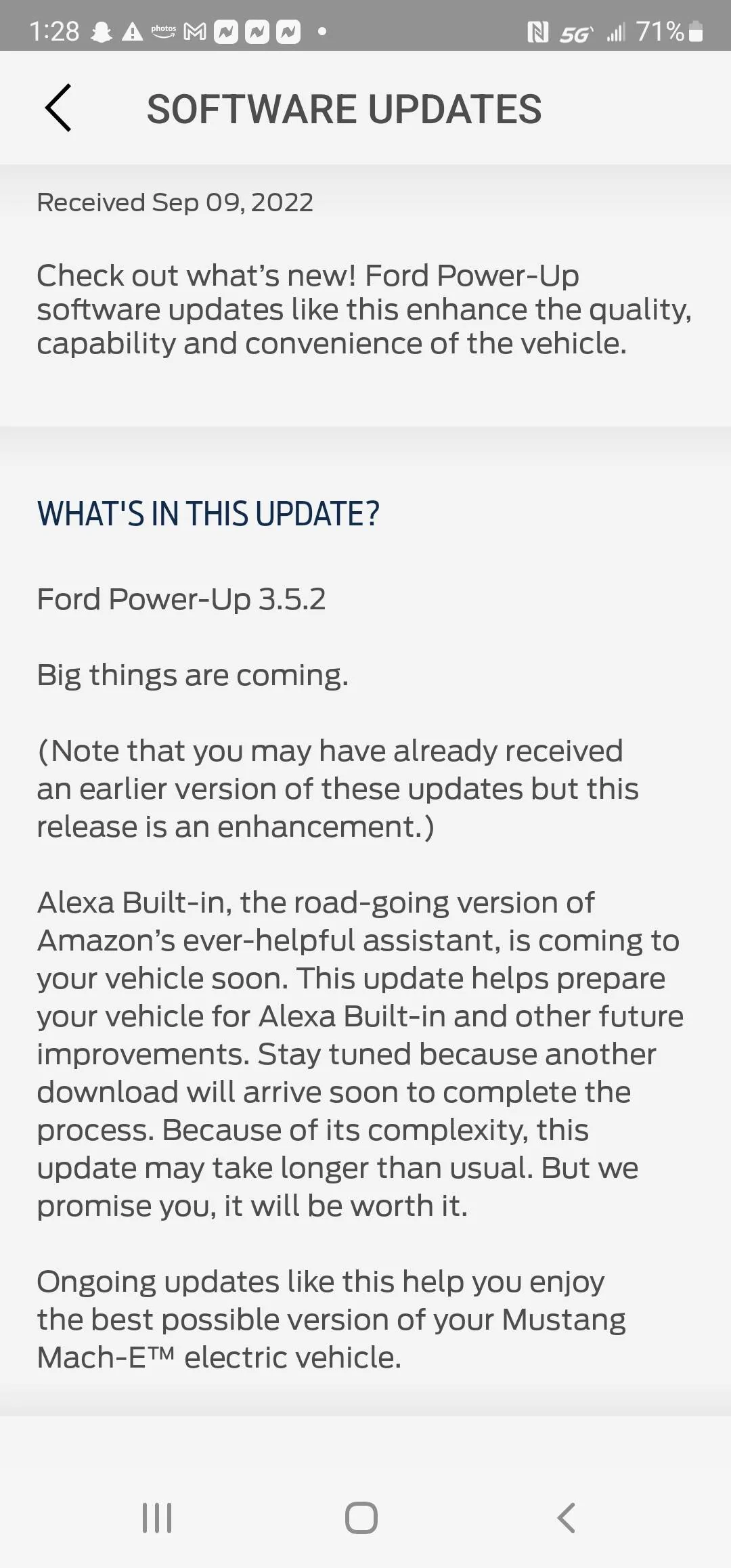

I will try that. Today I got another update. Will try to attach photo. Since the last update my BC and Alexa have not been working. We'll Alexa works if I manually push the button but doesn't respond to voice commands any longer.
Ford Mustang Mach-E Bluecruise stopped working? Screenshot_20220909-132831_FordPass
