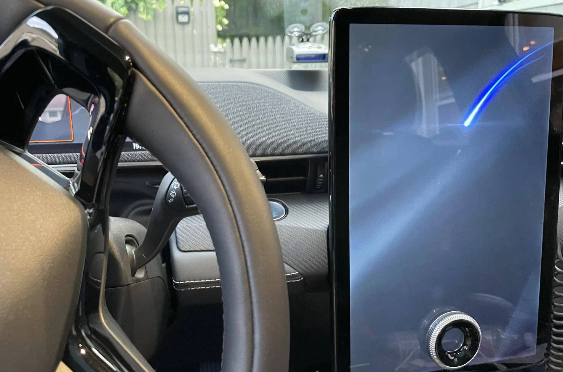

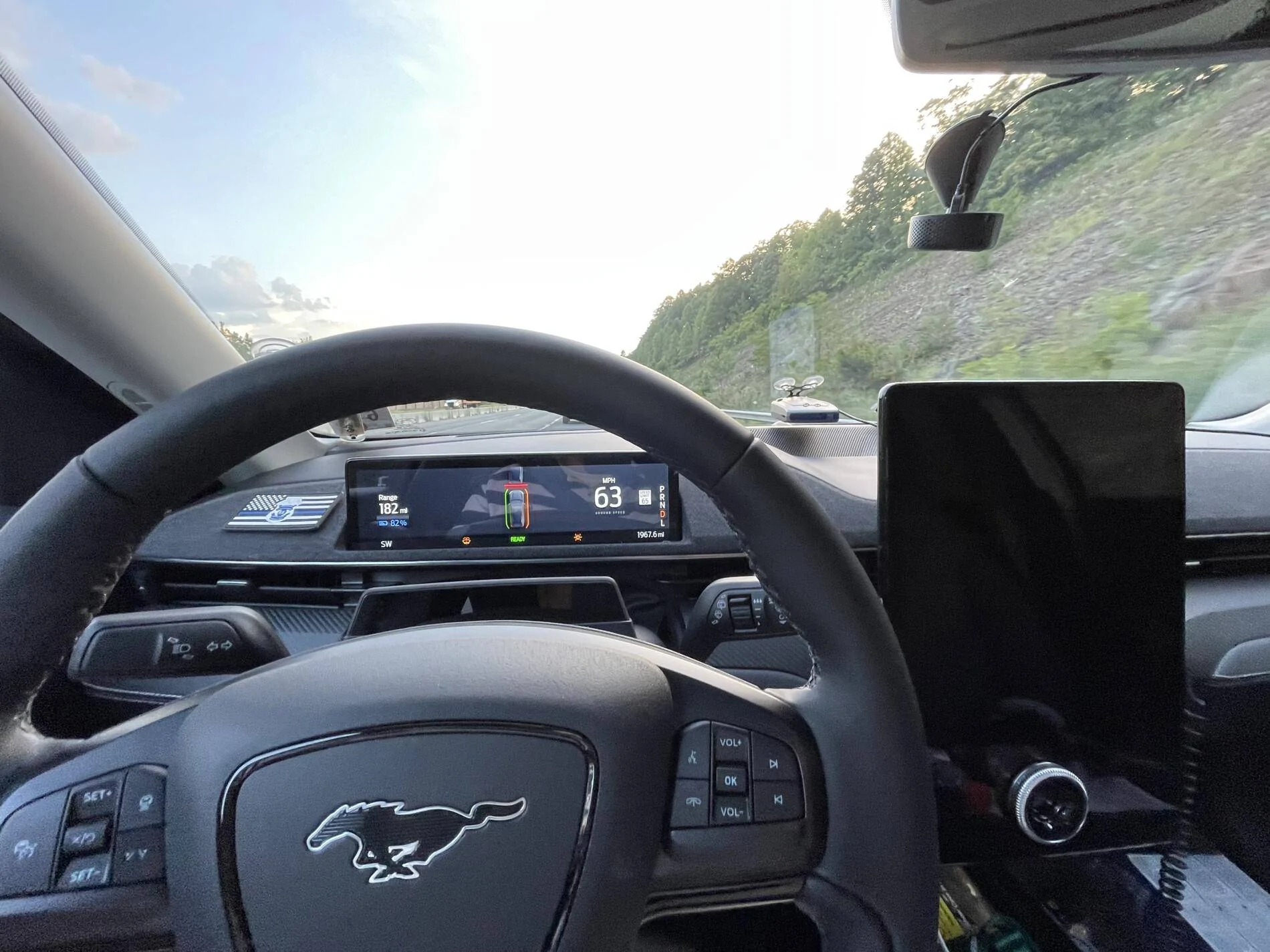

Any ideas beyond trying to reset sync (the button thing)
Worked fine mid-day, cranked the AC up to have lunch.
Preconditioned fine, got to the car, wouldn't light up. Stopped the car. Turned off, got in and out / locking.... no difference
Charged for a bit at home, left the car, still not working.
Oddities: PaaK has never worked since paired, today it started to. Walk by the car in the driveway and the lights turn on. When I stopped the car the first time, the shutdown noise sounded slower & clunky, like it was rendered by a dying computer.

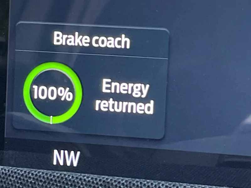

Out of nowhere on the ride home I'm now getting regenerative breaking coach when I never have in real-time. Car has always been in unbridled mode, so is this something normal when in the other modes? Getting it when coming to a stop, even stop and go traffic... Just no center screen.
-Center screen stopped working, sync reset does nothing
-Car might have reset to a default mode, I've never seen a brake coach on the main cluster
-When I tried turning the car off before leaving the work parking lot, the shutdown noise sounded like it was played on an 80's arcade machine on its way out.

Try restarting SYNC... hold down the volume down and next track buttons on your steering wheel for several seconds.
Brake coach is only available in Engaged mode. In your photo, the vehicle is in Engage mode based on the graphics we can see on your instrument cluster. Maybe it moved you to that mode when the center display computer crashed?

Tried restarting sync, first thing I thought to do. Here's the thing, the screen is dead. Zero touch, zero anything. What was most worrisome was the spooky noise of the usual shutdown noise sounding beyond glitched when I tried stopping before I left work, to no avail.
My best guess is the car derped somehow, it's in Engaged mode (I've never had it in there, even my online profile is unbridled) and.. I can't get out of it.
Worst, I put on max A/C at 60 degrees mid-day to cool off eating lunch, and without a middle screen, had to drive home like that. Had to throw the windows down to heat up on the way home.
Not sure what I can do beyond the volume / next track buttons.
If it was just the screen bugged out I wouldn't be as worried as the noise that glitched when I tried putting it off and back on before leaving. Imagine an audio file processed in the wrong format and slowed down. Worried something's toasty inside to get a non-working screen + major audio glitch. More worried about taking it to a dealer around here.
Place I got it from has a guy flown in from Ford in Michigan to do PaaK fixes (and a bunch there)
If I take this in, worried I won't see it before December.

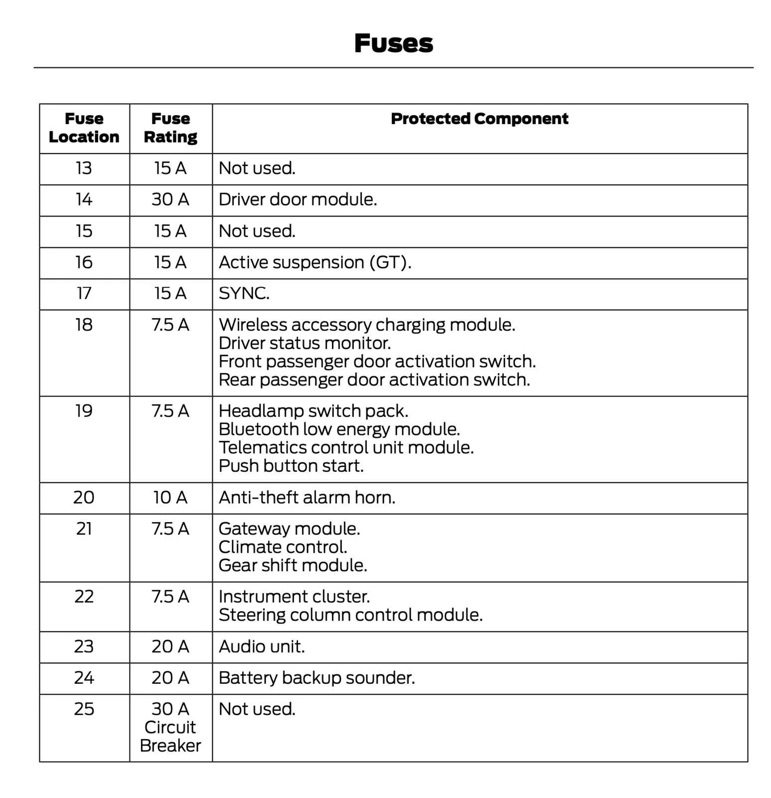

Going to pull 17, 19, 21, 22 and 23 overnight. Fingers crossed for tomorrow.

Take a look at this video before you start pulling fuses. This might be a quick fix worth trying first. Good Luck!

Pulling fuses overnight worked. I also pulled the alarm fuse just incase it got mad.
I'd tried the breaker thing, but maybe for not long enough?
Just honestly thankful I don't have to go back to the dealer, I lost unbridled mode (which I did already from brake coach coming up on the other display)
