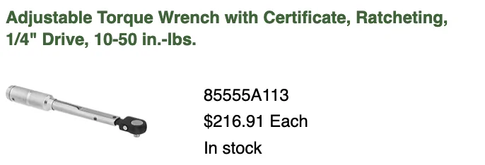

hmm, here's a pro tool from McMaster Carr, on the pricey side:
Ford Mustang Mach-E Car Bricked While Driving. Any Thoughts on This Screen Shot 2022-04-25 at 1.30.28 PM

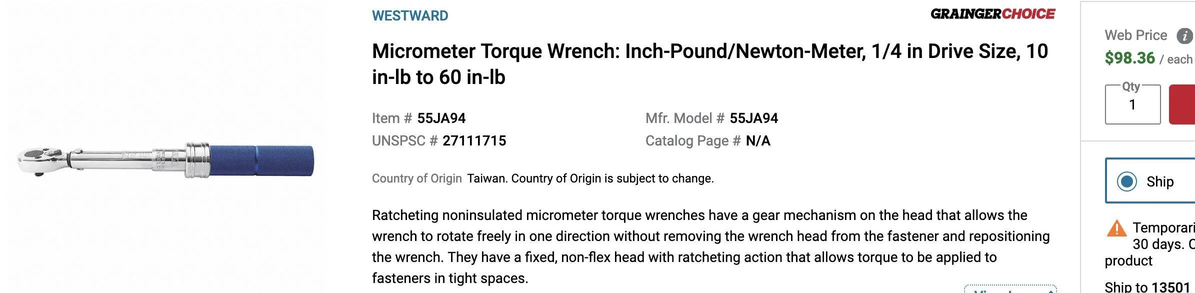

Grainger for less:
Ford Mustang Mach-E Car Bricked While Driving. Any Thoughts on This Screen Shot 2022-04-25 at 1.39.32 PM
Grainger for less:

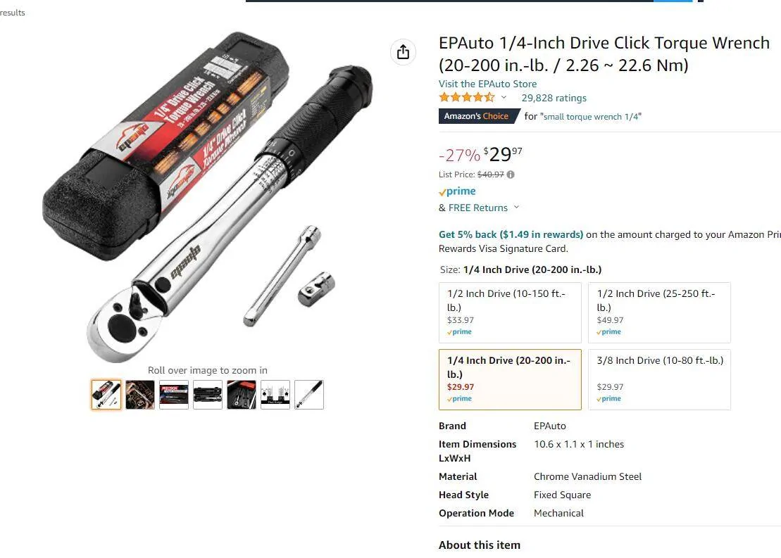

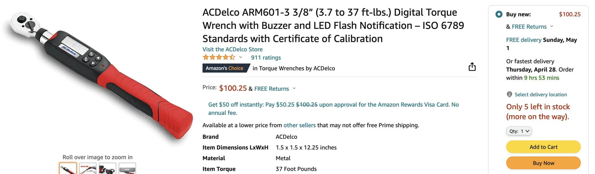

This one looks pretty cool, I wonder if it is good enough for home DIY use for this application?
3-37 ft lbs seems like a good range. I imagine we want to avoid the wide ranges such as 5 to 100.
Ford Mustang Mach-E Car Bricked While Driving. Any Thoughts on This Screen Shot 2022-04-25 at 2.07.13 PM

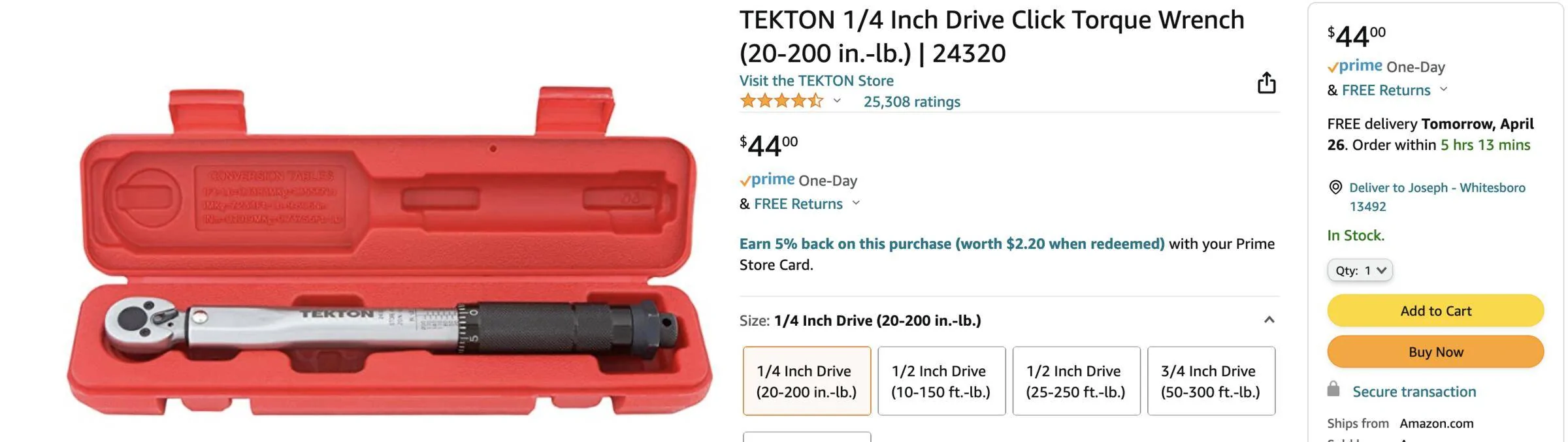

I ended up with this one, very similar. Also realized we are in inch pound ranges (I have others from Tekton that have performed well):
Ford Mustang Mach-E Car Bricked While Driving. Any Thoughts on This Screen Shot 2022-04-25 at 3.01.58 PM
The fastener charts are difficult to read, but I see 10 ft lbs comes up often for 1/4" studs. Seems to depend on diameter, thread pitch, thread type, and metal type. @Mach-Lee said he couldn't find the torque numbers in the work shop manual (WSM), so hopefully we can get the numbers somewhere else. 10 ft lbs or less (100-120 in lbs) seems like a good starting point then for the large stud. I will just see how it feels, sometimes you can just feel "too tight" at the edge of damage. I just went through the WSM, cannot find the torque number for the 12V electrical connections, just says to check tight in troubleshooting.
