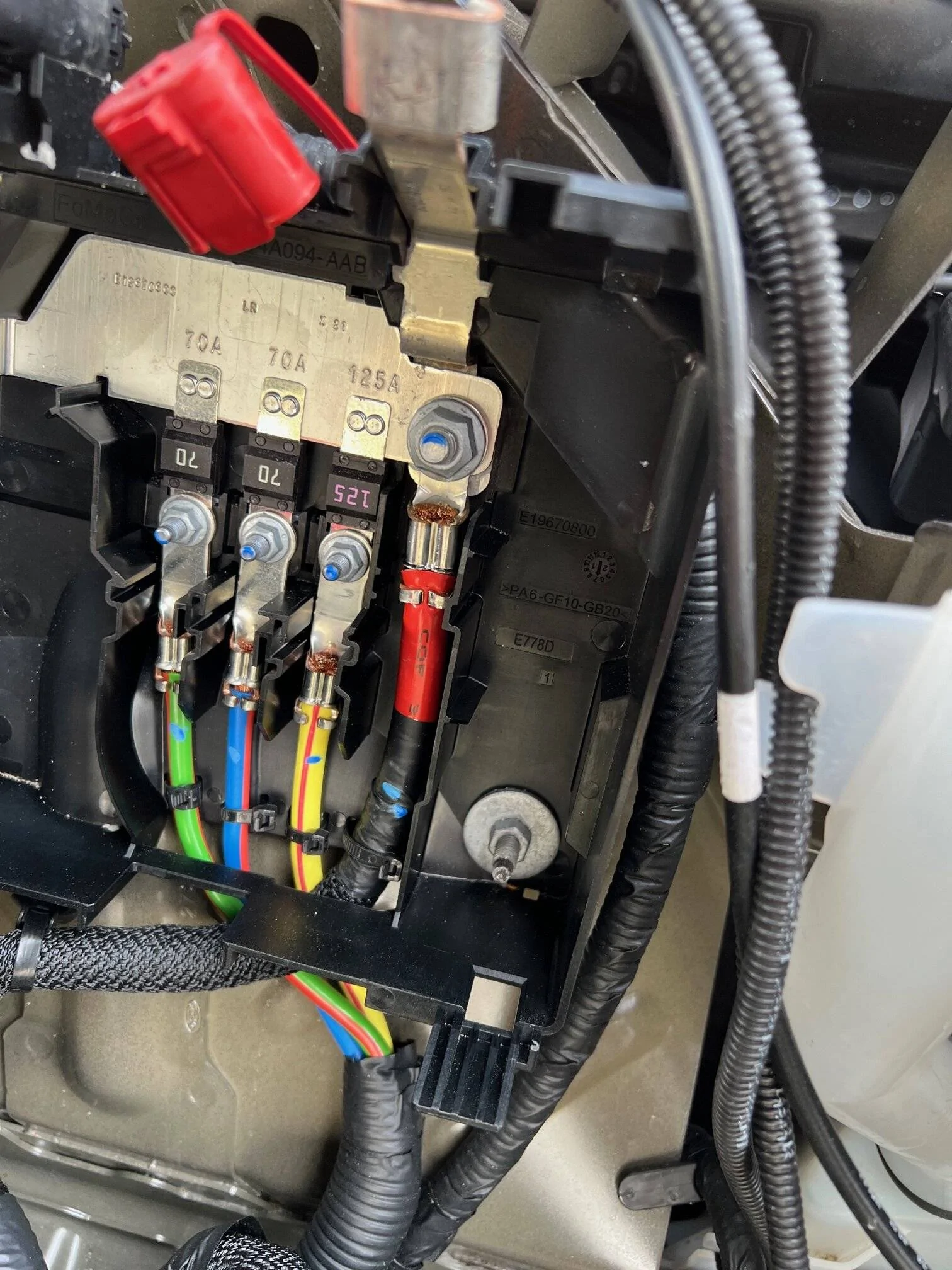

Driving to work this morning going around a corner doing about 55 mph and my car died. No power, no lights, nothing. Steering and braking was almost impossible but I managed to get it to the shoulder. There was zero warning, just died.
Now I’m sitting here waiting for a tow truck knowing I can’t put it in neutral.
I’ve had the car for 4 months and have 8000 miles but have never had a single issue.
Edit - Problem resolved.
On advice from another member, I'm editing this thread.
Please read through for all of the details but here's the short version of the fix.
Found a loose connection in the 12 volt distribution box. Had to tighten the red wire on the right,

***EDIT. Not every owner should do this ……Every owner should be popping their frunk and checking the torque on those vital electrical connections after disconnecting the High Voltage connection.

... Every owner should be popping their frunk and checking the torque on those vital electrical connections after disconnecting the High Voltage connection. ...
Remember that those posts, including the red cable threaded post in question are "HOT". It is only 12V, so the shock hazard is nil, but if a wrench used to check or to tighten the nut, especially the red cable nut, touches a nearby chassis ground, there could be splattered molten metal (and fuses to replace).
The safest approach would be to open the hv disconnect interlock, mostly to keep the DC/DC converter from coming on, and disconnect the 12V negative battery cable first.
Also, I imagine that any of those threaded studs can be broken by applying too much force, so use some care too, or you might end up with a far more serious repair issue.
Using Jon's picture:
12v won't kill you *usually*, but if the end of your wrench hits the frame, there will be plenty of sparks. ;) Definitely a good idea to open the (green) HV-dcdc relay connector to prevent the dc-dc from sending 160amps... and remove the 12v battery ground while you do this.
i would suggest a torque check, and perhaps a drop of thread locker at the end of the nut where it meets the thread.... OR, remove the nut and slip in a lock washer, and re-torque. A properly torqued nut of this type *shouldn't* loosen.....

Absolutely. I was not referring to anyone just jumping in under the Frunk and going tap tap.
If you’ve already been under there you probably realize where the danger points are and how to disconnect all the live connections. I will say the entire mess under there doesn’t look well laid out and Ford could Have done a lot better. The Kia EV6 layout is much more orderly
I’m just somewhat freaked out by the amount of crap Ford put in between the vital charging units and the user. Replaceable parts and needed connections trapped and locked under silly plastics. To make some kind of lame cooler ….most will never use
All that stuff should’ve existed in a box easily accessible at the top of the Frunk and the freaking frunk should have a latch you can open it without any electric required. Anytime …
I think 80 to 90% of the users will never look underneath that plastic and leave it all up to the dealer and the rest of us we should know the risks.
Obviously important to keep pointing it out though so none of us fry like a chicken wing

I second this. Truth be told, I probably wouldn't have touched it if -
A. Jumping it allowed me to put it tow mode.
B. I hadn't realized the positive jump point was loose.
C. I wasn't pissed that I'd been waiting 6 hours for a tow.
