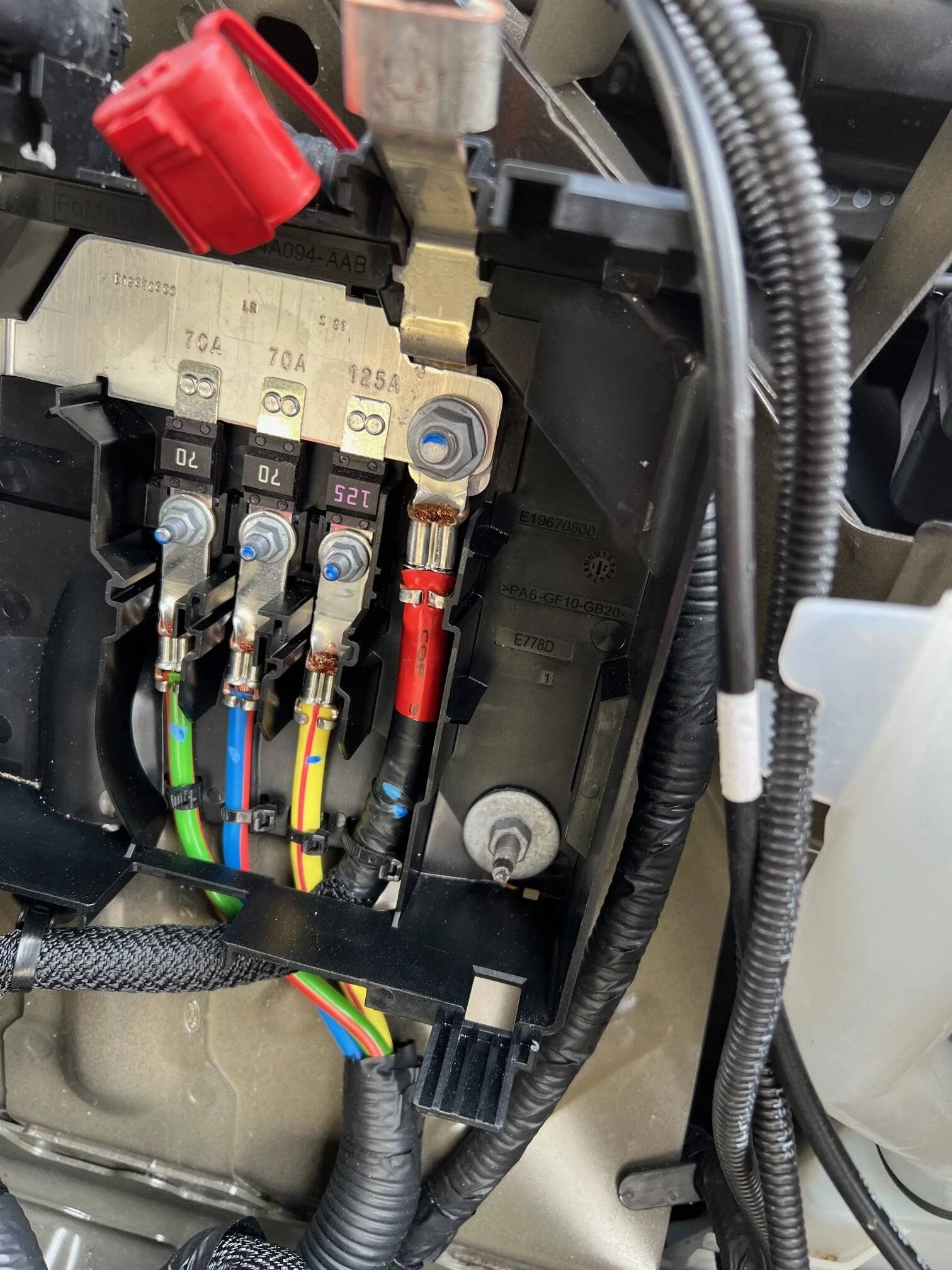

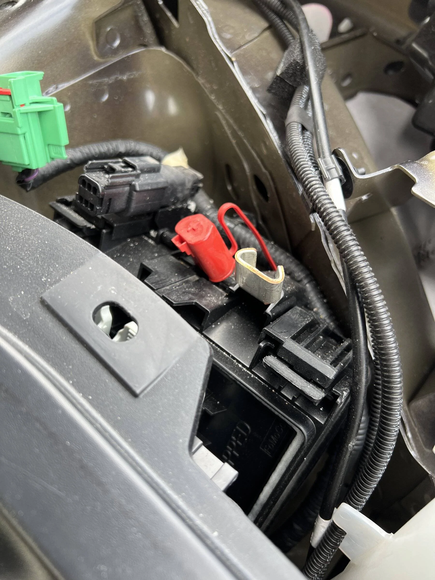

Heres the connector. 1.8 volts on it
Mechanical failure inside the LVB most likely.
Was that metal blade nice and solid and just the plastic cap was loose?

I'm back up and running no thanks to Ford or 4 different tow companies. After 6 hours and no tow, I decided to have a go at it. BTW, It's a pain in the ass to remove the frunk with minimal tools on the side of the road.
The wire on the right was reading 1.9 volts on the terminal but 12.5 on the actual wire. It took about 4 full turns to tighten it up.
