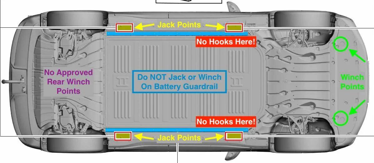

Make sure they use a dolly on all four wheels, if you can’t get it into neutral at all, that’s the only way to tow it. Don’t let them drag it up the flatbed if you can’t get it into tow mode!
